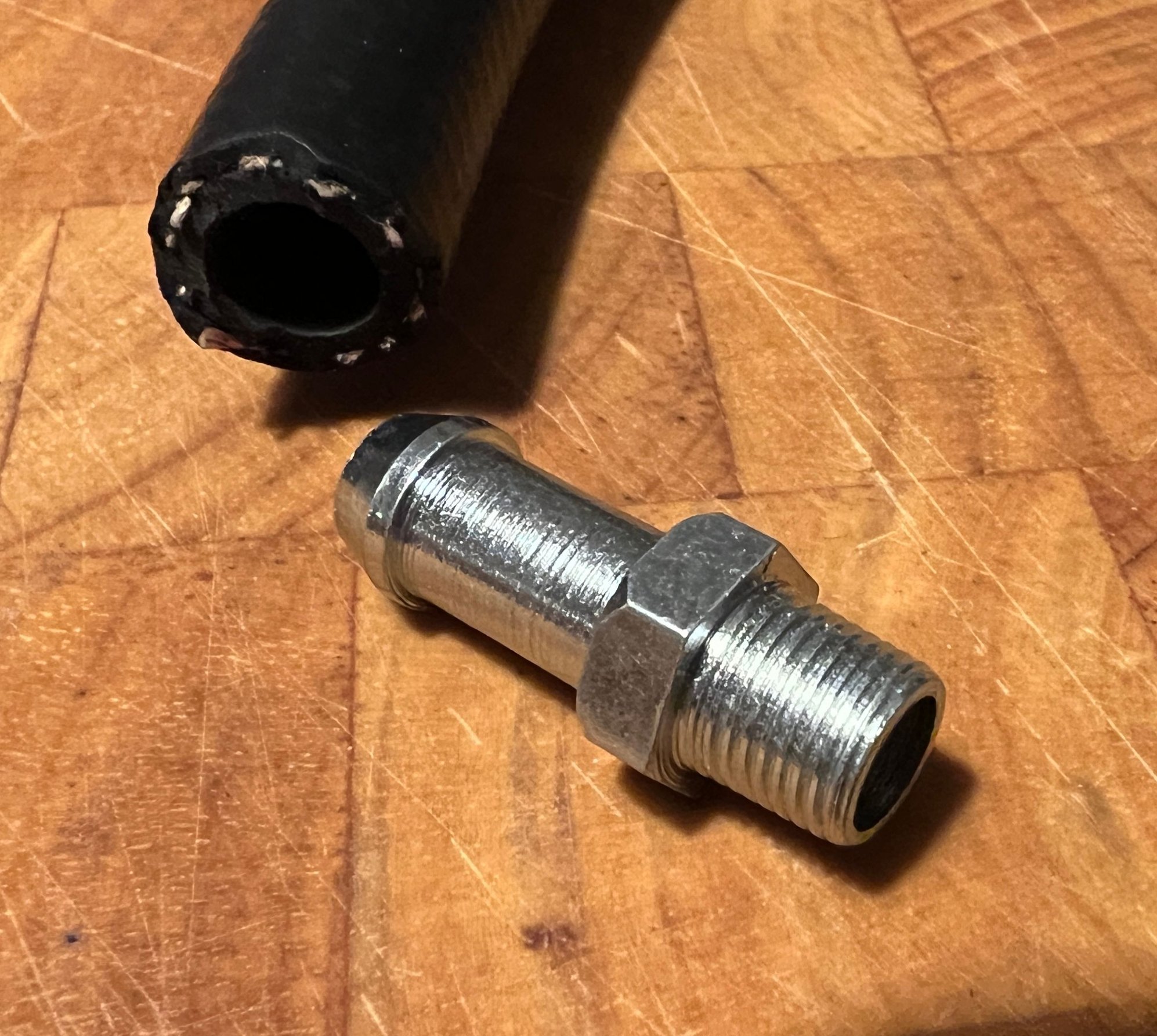

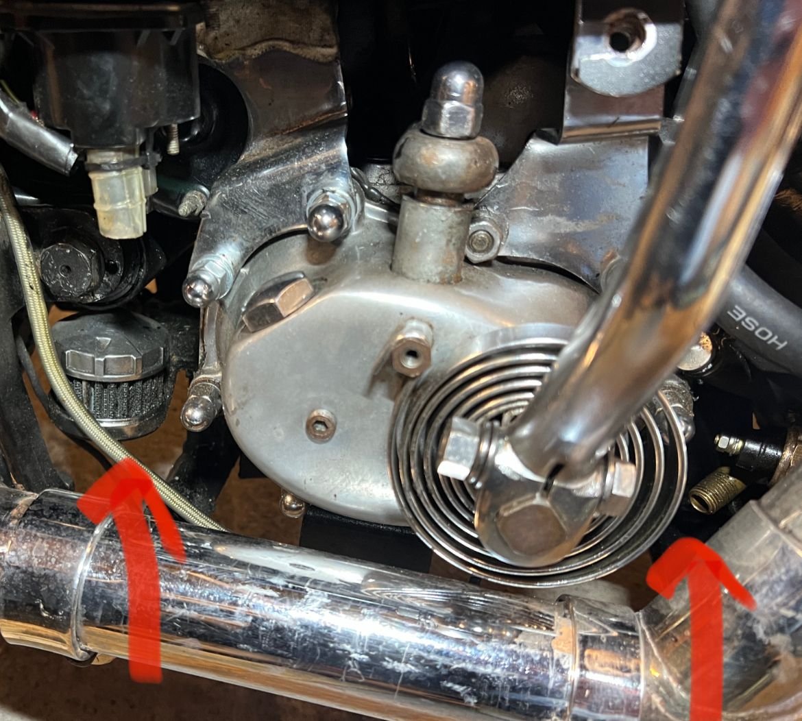

Hi All,
Another question from the newbie!

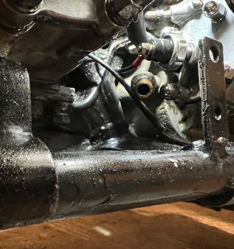

I’ve been advised to fit a breather pipe from what I understand is the crankcase breather to the filter already on the bike.
There is a brass connector in the crankcase but I believe it’s the wrong fitting? I have sourced the right fitting (I think) and some pipe.
Having trawled the internet there seems to be mixed opinions. Some say connect to the filter and others say just leave the pipe loose under the bike.
Any opinions/advice?
Thanks

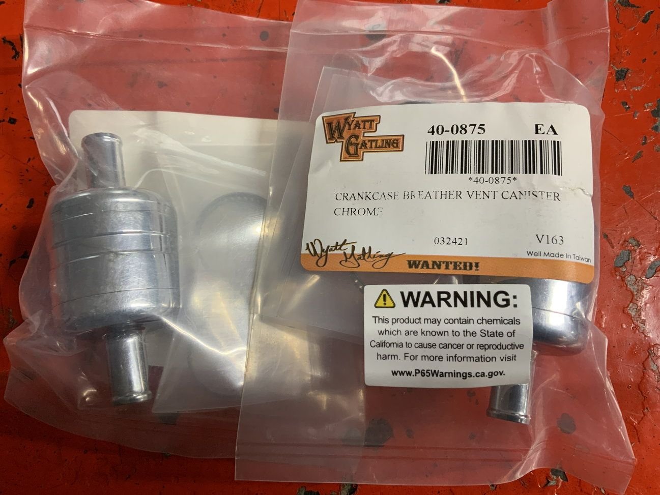

We would put a PCV valve on the vent pipe its self and run it with the oil lines up and over the oil tank and back down
i will try and remember to pix up what we use i did not save it

I did what John suggests ^^^^^^^^^^ it works very well.
(i will try and remember to pix up what we use i did not save it)........did it for ya ole son

it was also interesting to me in the beginning when we tried that on the shop bikes - 2 years later i knew it worked and continued to do the job we were looking For
2 things happen - 1 the hose makes the sump oil clime over a foot vertically and yes we sometimes see a few drops but the drain pan is not needed
2 - if you understand how the oiling system in the venting and breather actually works its a add and not a subtract to put the one way valve in place
first thing it does is stops the extra air from coming into the exit vent — an a abundance air the engine system does not need or want < this is the thing we looked at closely - by stopping the in coming air from the 2 pistons together going upward every other time the crank goes around - using a one way valve - you do not over whelm the breather system and you do not make it ineffective - reason it only has around 1/2 the air to expel as it did before the valve was in place note the piston returning to a downward motion causes a blow back into the cam cover to lube all of the pieces in the cam cover - then add the air that is sucked back in it becomes over pressurized in the cam cover as the exit is a pipe but its baffled so it can separate the liquid from the air — then at slow engine speed it ok at hi way speed it becomes inop in its ability to work correctly add miles to the engine and piston ring compression loss even adds more air the an already over pressured system - the guys who run this have been happy the way it works cuts down on floor oil and gasket blowouts or the cam seal dreaded cant stoop the leak even with the new seal
been using this better then 10 years it works for us this is that really matters to me

Thank for all the detail. Okay, I shoulda done this from the start. I’ll add the pvc to the end of my breather as it sits. Looks like harder to find the pictured than I thought, out of stock so far. I know can prob go to Napa or other auto store and find a suitable pvc valve. That would do? Positive - aka one way valve. I hardly get a single drop, when I do and it’s not after every ride. I mean tiny like a dime or tip of your pinky. The only time I sumped was on startup after 6 months, 8oz + or - maybe. What sold me to try the pvc is the statement about the cam cover. Had mist only one time along the leading edge - front - I gotta pic somewhere.
I was WTF now? Never came back….
Also I have placed my finger over the breather and felt the blow and suck pulses - I understood.
July 7. I cleaned this up never came back. Crank pressure?pushing past cam cover, makes sense.
