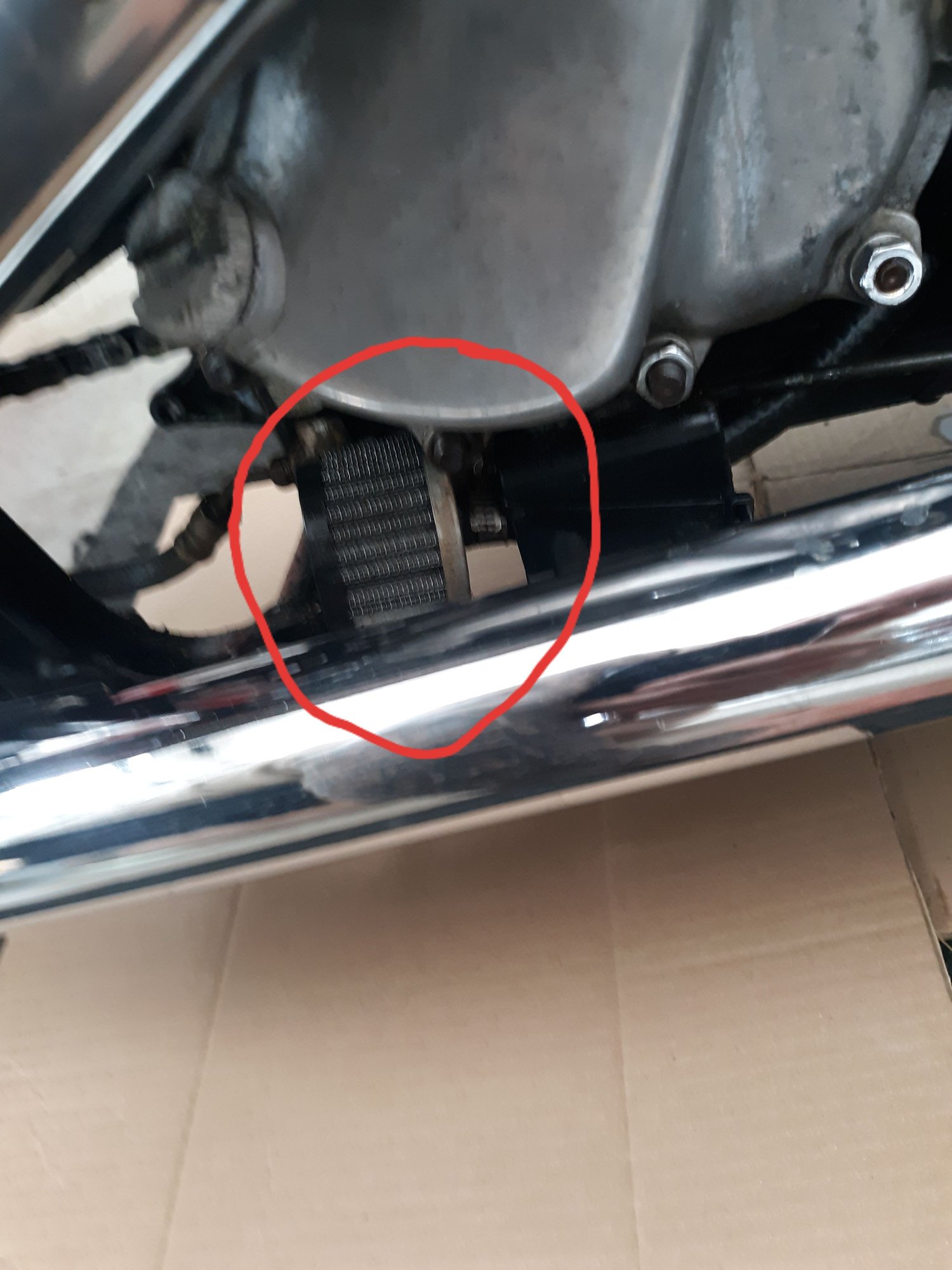

Can anyone tell me is this called the case breather tube, that this little filter is attached to?
