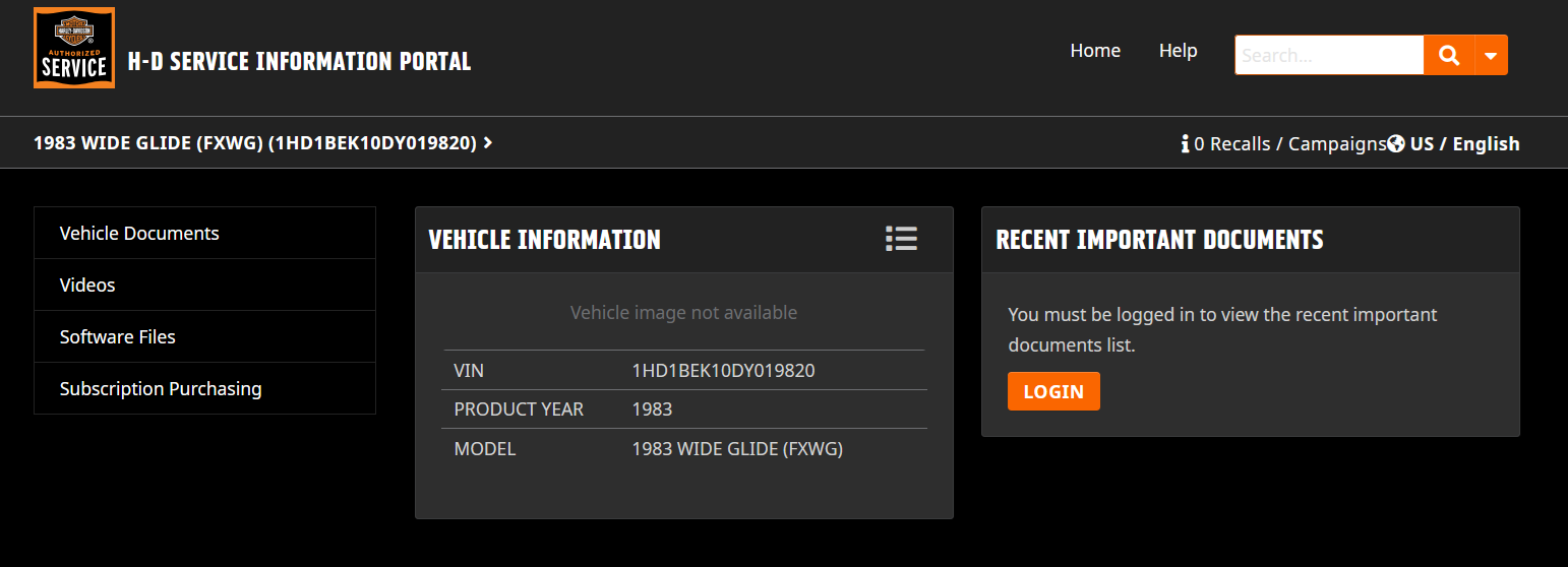

Asking for help. I remember someone here has the ability (or access to) the VIN decipher codes for shovelheads. As we all know the numbers/letters can be hard to read. This is what my friend and I have been able to come up with off his new project bike. He was told it's 1983 and, of course the title has been misplaced (for now).
1HD1BEK10DY019820

See link:
https://serviceinfo.harley-davidson..../vehicle/index

Originally Posted by CoolBreeze3646
Thanks! That's what I was looking for. Much appreciated.
