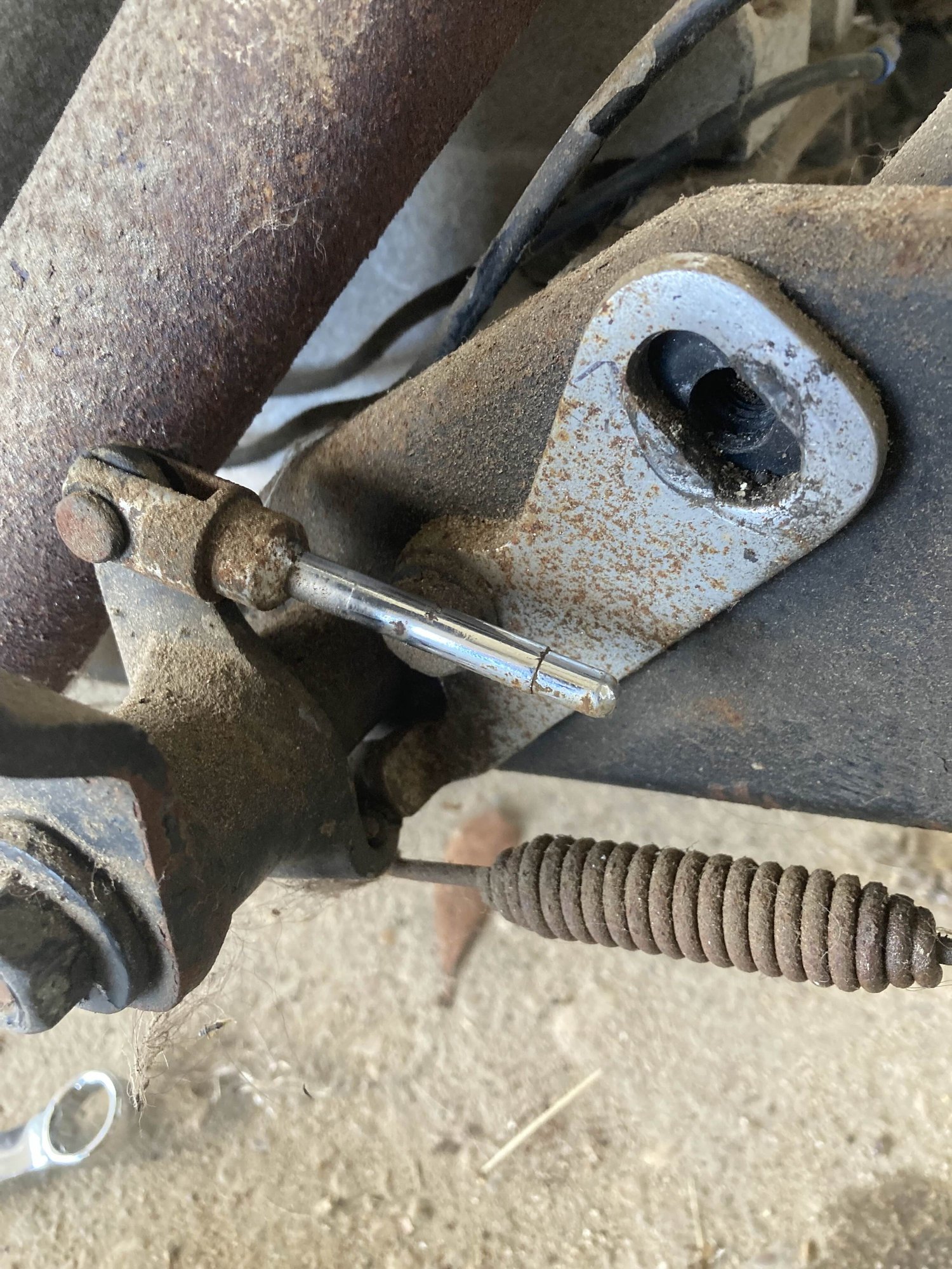

Hello,
This is my second post on this bike, other was about electrical work (Solved), and wanted to ask for assistance on my rear brake. When I press down on the brake, I receive no back pressure, the lines are filled with DOT 3 and I replaced the old liquid in the housing tank. I removed the line connecting to the housing to tank to further reduce where I can find the problem, and I think it is where the pedal meets the housing tank. To me it seems like it is not building up any pressure to push it and activate the brakes. I have attached a photo below of my brake type, but haven't gotten around to removing it completely and taking it apart. I am unsure as to why it wouldn't be functional, and the youtube videos I could find mention air in the lines. Only physical problems that I can see directly is that the rubber where the pedal goes into the master cylinder looks a little worn.
Do let me know your thoughts on this,
Isaiah

Old Aug 26, 2024 | 02:24 PM
EntirelySoulless's Avatar
EntirelySoulless
Joined: Aug 2024
Posts: 25
From: Alabama
I apologize in advance for my wording, I might use the wrong terminology and therefore it might be confusing, ask me in the comments about what I meant in some places and I will draw parts of the photo for you.
Old Aug 26, 2024 | 02:31 PM
TwiZted Biker's Avatar
TwiZted Biker
Joined: Mar 2009
Posts: 66,106
Likes: 51,387
From: Niles Canyon Ca.
Air locked still, MC needs to be flushed and bleed completely before trying to push the rest of the system. Pop the front line, suck out what you can from the mc and put new dot 3 in, thumb over the hole slowly work the pedal, till no air and clean fluid is all you get. Now redo the line and slowly work the pedal a few times cracking the next joint in line, repeat all the way back to the caliper keeping the mc full.

Sorry...But if I recall correctly...My 77 used Dot 5...I do Not own a Harley that uses other than Dot5
Also..I have Never seen an OE MC chromed...so have No Clue what has been done to Your MC

Old Aug 26, 2024 | 02:41 PM
SirHarley's Avatar
SirHarley
Joined: Dec 2015
Posts: 1,826
Likes: 1,046
From: Southwest Desert
Cool
Either you have a bubble in your system, a stuck brake caliper or you have a master cylinder problem. Judging from the amount of rust you have on your bike, I wouldn't be a bit surprised if a new master cylinder and a caliper rebuild were in order. If there is any pitting inside the caliper bore, you need to replace it. At that point, I would even replace the line to make it all new again. Brake fluid degrades and attracts moisture from the air over time. Moisture over time will cause pitting, and malfunctioning in caliper and master cylinder pistons. On my older bikes, I have found it best to start fresh.

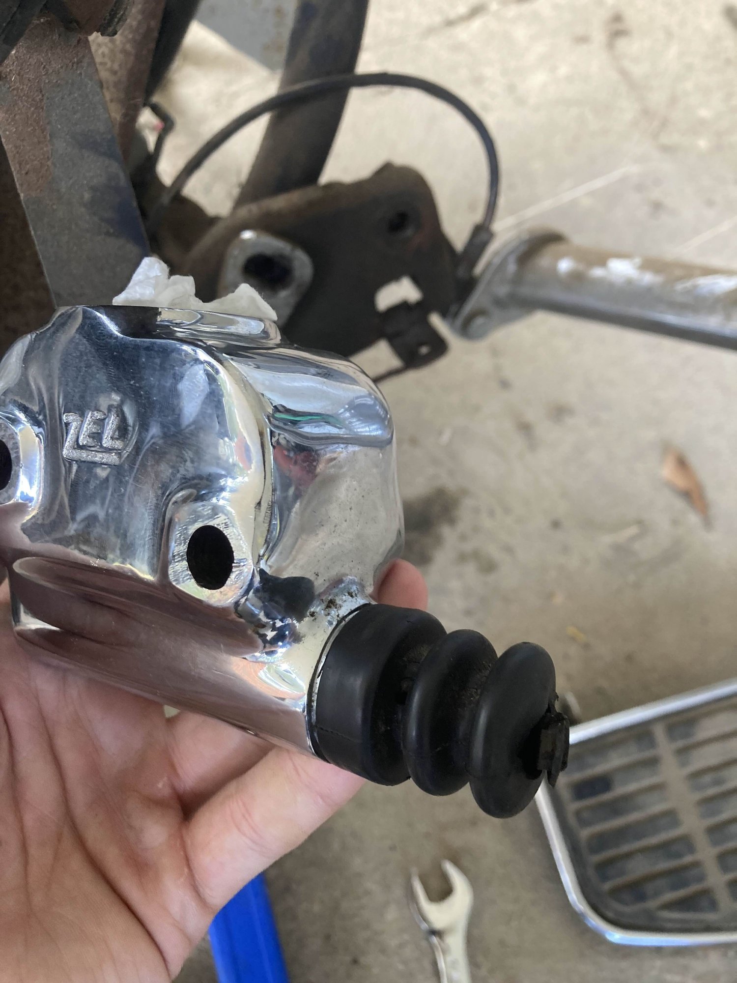

Hello,
I went ahead and removed the master cylinder (MC) to check the internals and for any physical damage. I cleaned it up to make it more visually appealing and to find breaks/cracks in the body. I disconnected the line to the brake switch and the pedal before removing the MC. As I can tell, it looks to me as if there is a part missing on the pedal connect, as the internal of the MC has a sort of bulbed joint. The rubber boot looks worn away as well, but that is for removing debris, which I can replace at a later date. As for the pressure drop, from inspection (and the photos), it looks like there lacks a seal to pressurize the brakes, but I could be wrong. I have read the prior posts and will work towards narrowing down the steps, but does this MC look damaged?
Inside Master Cylinder
Outside of Master Cylinder
Pedal connection
Old Aug 26, 2024 | 04:43 PM
Spanners39's Avatar
Spanners39
Joined: Dec 2010
Posts: 7,736
Likes: 1,524
From: Coromandel Peninsula New Zealand
If there isn't brake fluid running out of the seal in the MC then it MIGHT be OK, With the bike in the state it is I would rebuild the MC or replace it completely, along with any soft lines....then go watch youtube videos on how to bleed brakes.
Old Aug 26, 2024 | 09:44 PM
EntirelySoulless
Joined: Aug 2024
Posts: 25
From: Alabama
Working on rebuilding the MC now, it seems to be stuck in the housing, so working on getting it out and seeing what is damaged and what I need to replace. Given the cost of a new one ($150 when I looked it up), I am going to try and do what I can to repair it and bite the bullet if I cannot.
Old Aug 27, 2024 | 08:12 AM
Racepres's Avatar
Racepres
Posts: 8,569
Likes: 3,324
From: Cental, MI
What happens when Dot3 is Mixed with Dot5...
Old Aug 27, 2024 | 08:21 AM
Baird's Avatar
Baird
Joined: Jun 2013
Posts: 1,239
Likes: 1,171
From: St. Catharines, Ontario
you'll need rebuild kit 41762-58A. I just purchased one a month ago. It came with a new boot and 2 pieces not needed (for drum brakes) I'm pretty sure that DOT 5 is what '77 used.
