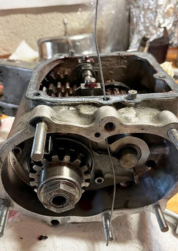

I found two vent holes (clogged).
One goes into the gearbox and one into the kickstarter. See photo.
But I expected to find drilled bolts or something else.
When you tighten the bolt, the hole closes. How does the air get through?

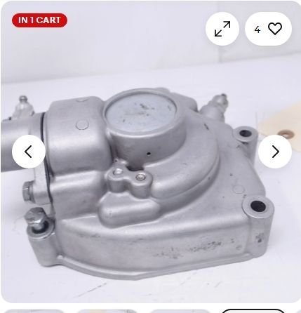

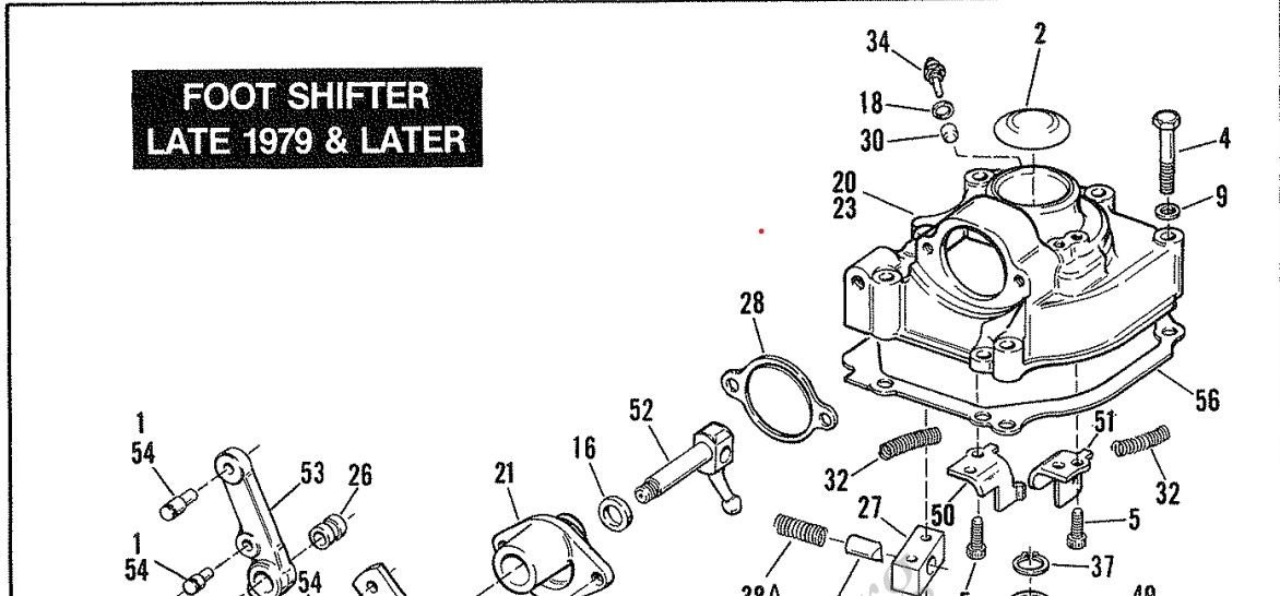

All of above is true for 1978 and down transmissions. In 1979, the Cow Pie was introduced. It vents from a small hole in the side of the "tower" on top of the transmission.
just being lazy ...is that breather hole accessible insitu ?
