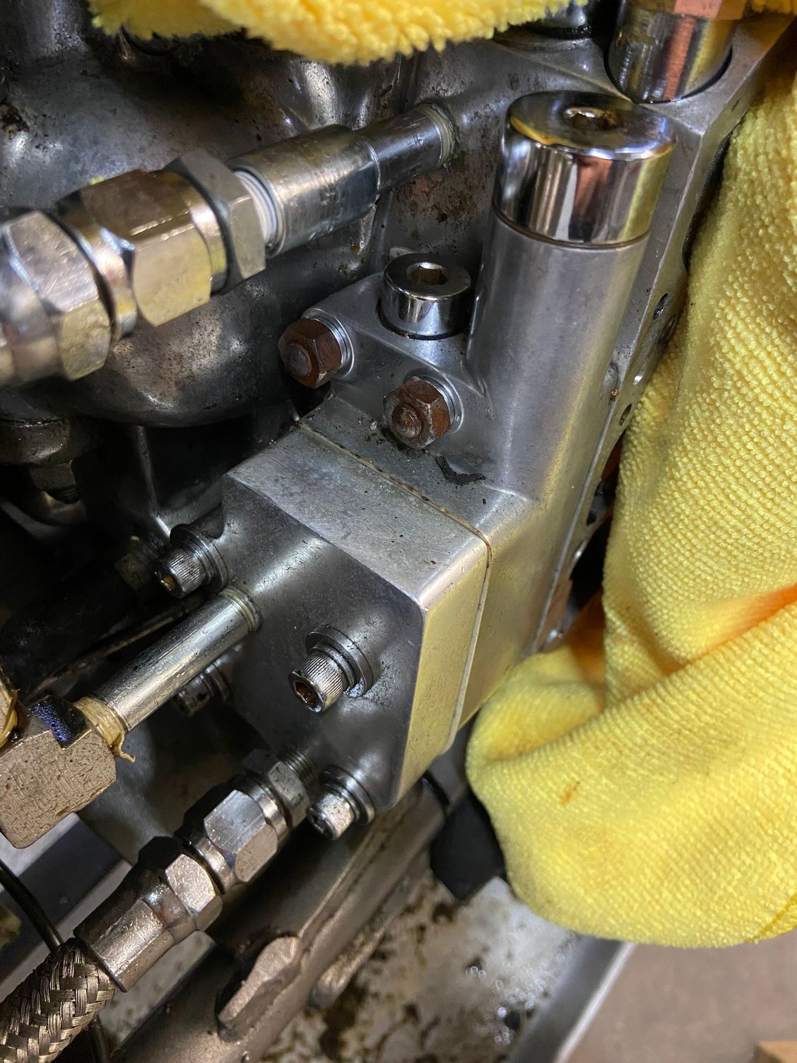

Can anyone help me Id this oil pump on a 73 FLH? I’m cleaning up the oil line plumbing and installing a new cam cover so I was going to re seal the pump while I’m in it this far.
not sure if I can use oem gaskets or if I need to match them to whatever pump this is any help would be appreciated thanks!

It could be OEM or it could be an aftermarket, hard to tell by the photos. Most aftermarket pumps use the OEM gaskets and seal. I would carefully remove the gaskets when you take it apart to compare to new gaskets.

To me its a re pop oil pump and it as said uses oem style gaskets but in no way do you want to use a gasket that does not match what you have exactly

Thanks for the replies guys. Good to know most pumps use oem gaskets. But I will compare old to new to be sure.
The color of the pump and cover is just different enough, I wonder if it’s the stock pump with just a “billet” cover on it. It’s nice that the chain oiler provision is gone, but it would have been nice if there was a port for the oil pressure switch…
