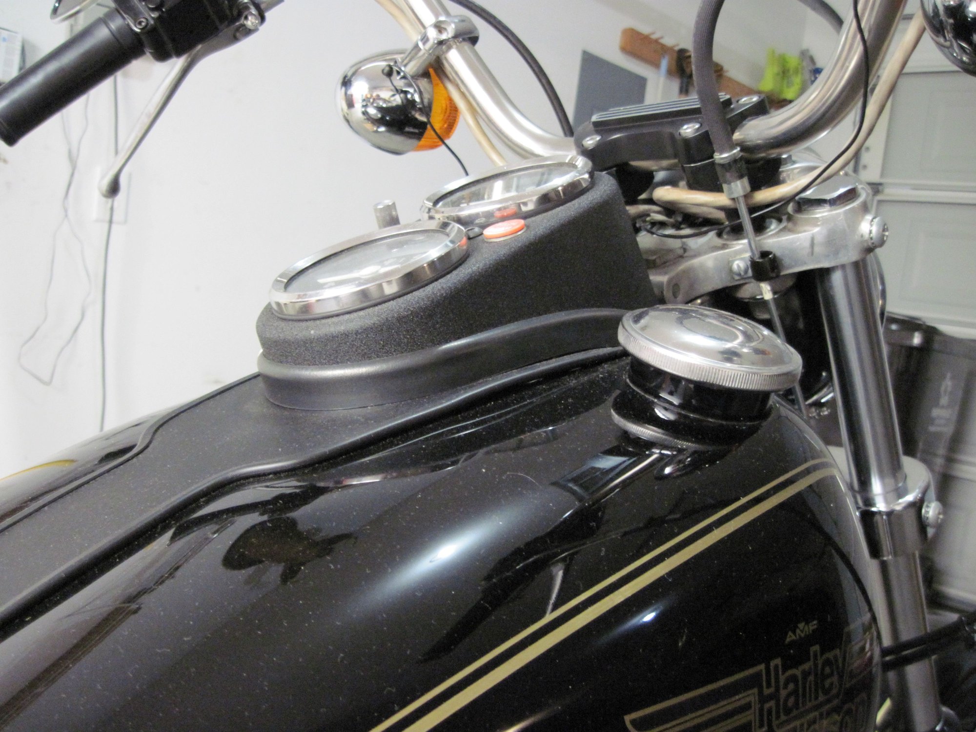

This is one of the things I read about the rubber filler from a person that replied to me when I was asking about replacing the cracked one on my bike. I wonder what a knowledgeable AMCA judge would say. Does the AMCA have a book on the OEM specs, the judges must have something to follow.
A shot of how mine fits, looks better in person. About 1/6th inch gap where there is one, no custom fitting. Yeah, it is dusty. Looked at the rubber that cam off from the bike an it says "Mustang" in a couple of places on the bottom surface.
Keith, I would start by getting good factory pieces and see how they fit.

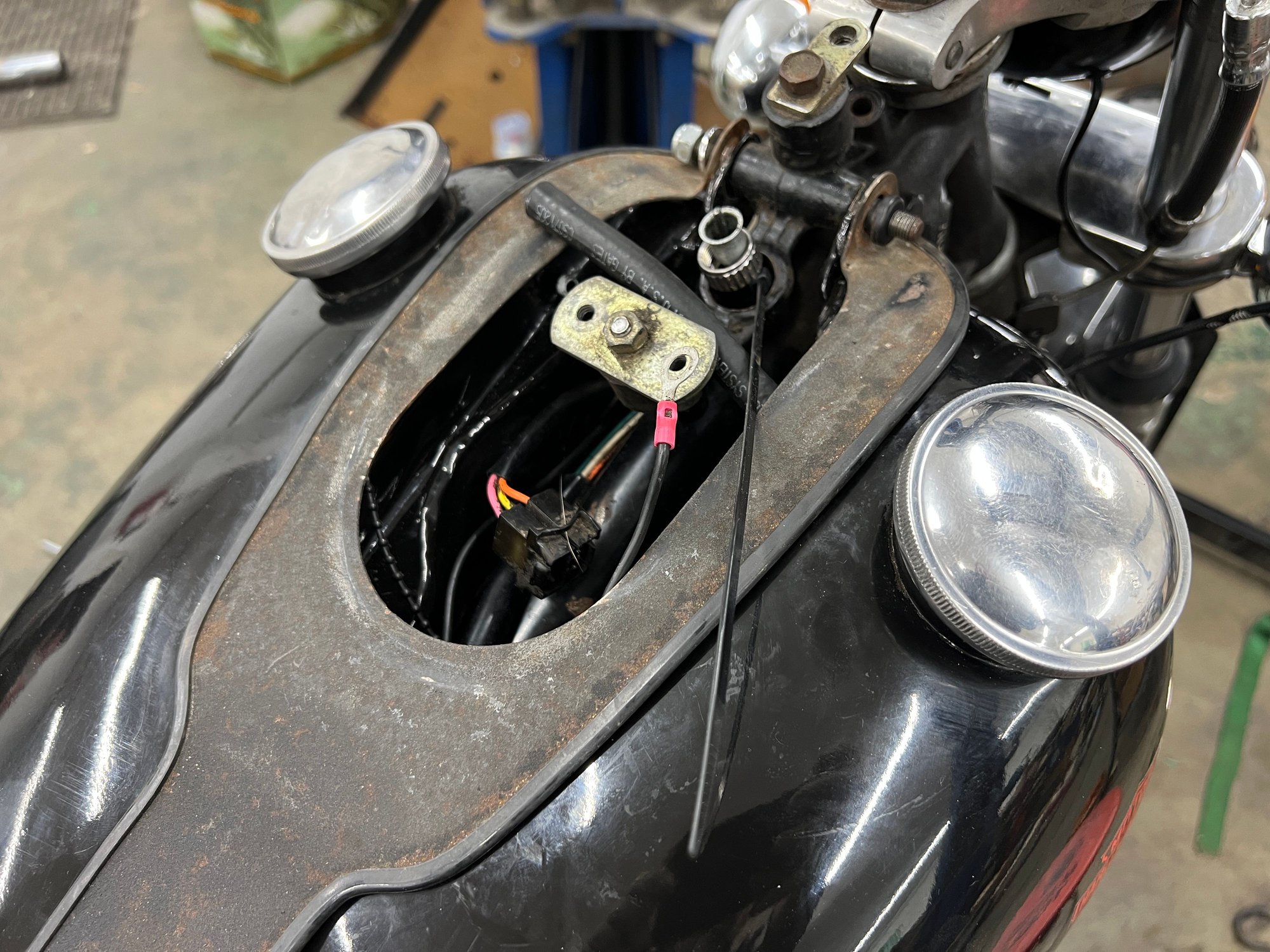

Well, I decided to blow off work today and revisit the tank positioning. I started by removing the shims at the dash and resetting everything; now I'm not sure why it was shimmed up there in the first place. IIRC, the front mounts (upper and lower) aren't typically shimmed, only the rear ones?
Honestly, it doesn't look like they were needed.

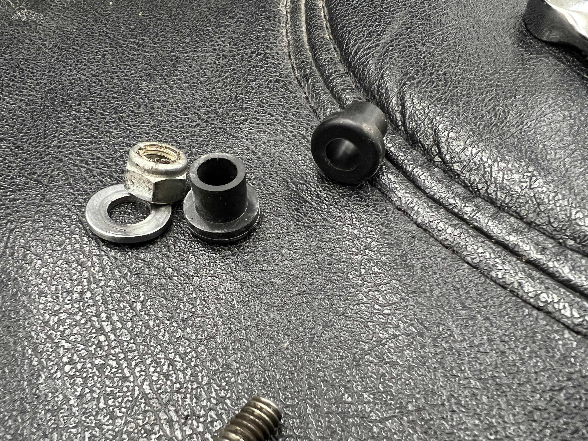

I'm going to use stepped rubber washers to isolate and raise the tanks (centering the tank mount holes on the mounting bolts) - unless that's a bad idea for some reason. I figured the vibration isolation would be a longevity benefit on a shovelhead, and raising them would improve my dash gap...
I'll report back with the results (I'm also throwing back a few, so may not finish today)

Is that black wire a ground connected to the 2 hole dash mount ? That dash mount may be isolated by the rubber mount, is the plastic connector melted ? I wonder if rubber mounting the upper tank mounts will cause the other non rubber mounted mounts to break. I would think all or none.

It's just laying there - it's the last of previous bad wiring that I need to resolve (fixed two other issues already) - I'm guessing one of the wires in the factory dash plug has issues elsewhere on the bike necessitating the supplemental ground in question (it attaches to the mounting post on the speedometer, btw), just haven't tracked it down yet.
- and yep, the plan is to do all three mounts on each tank.
