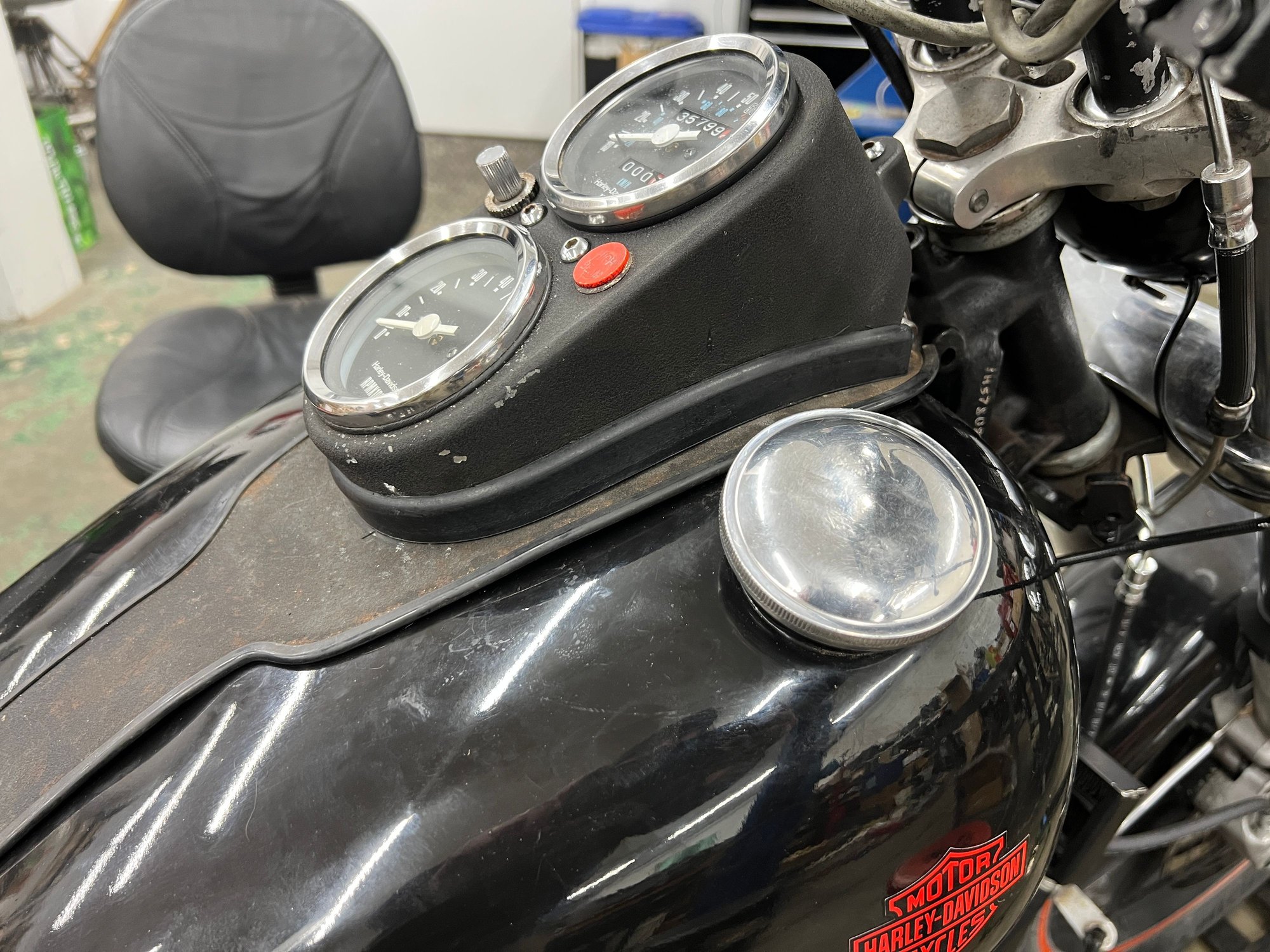

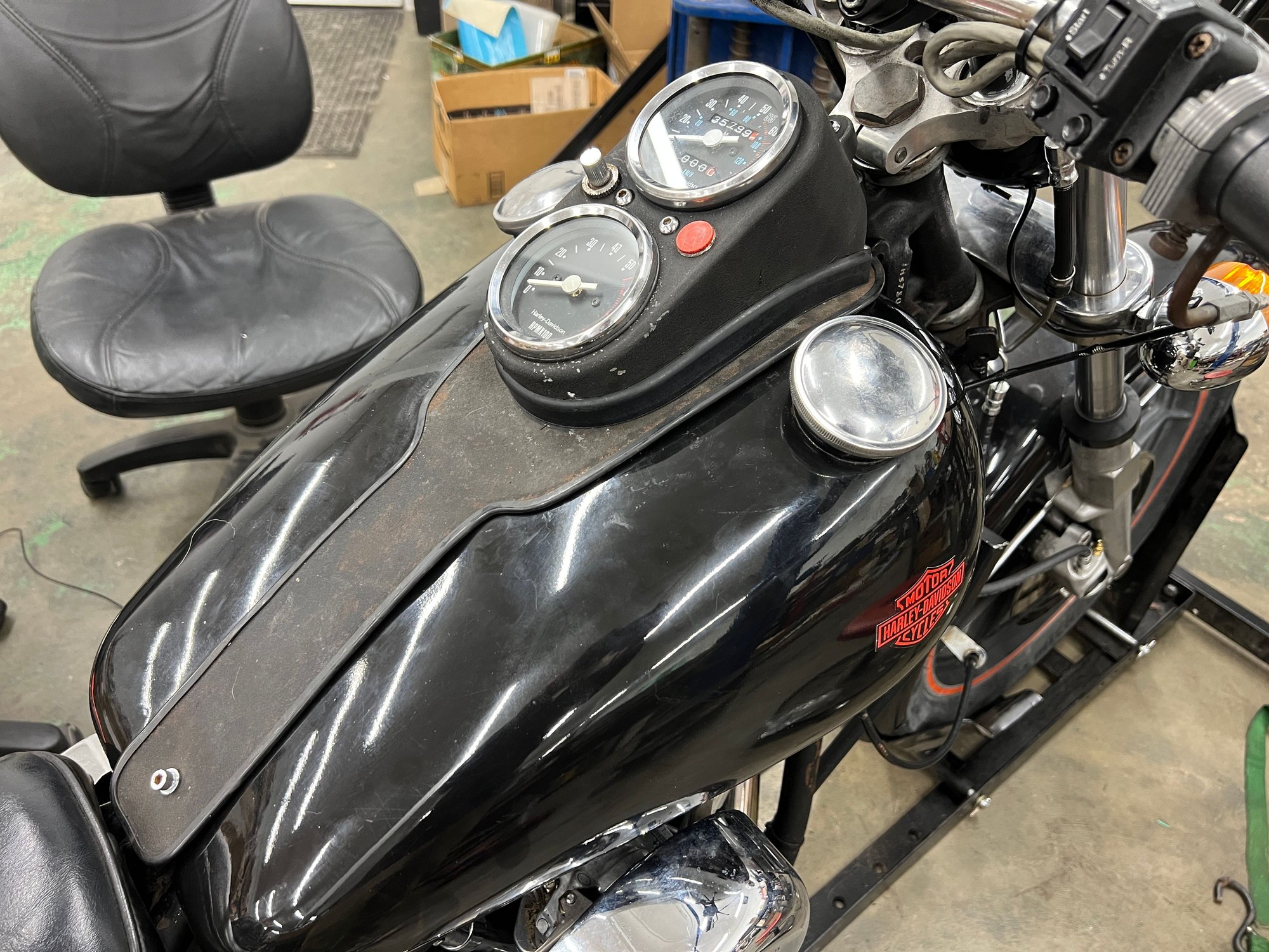

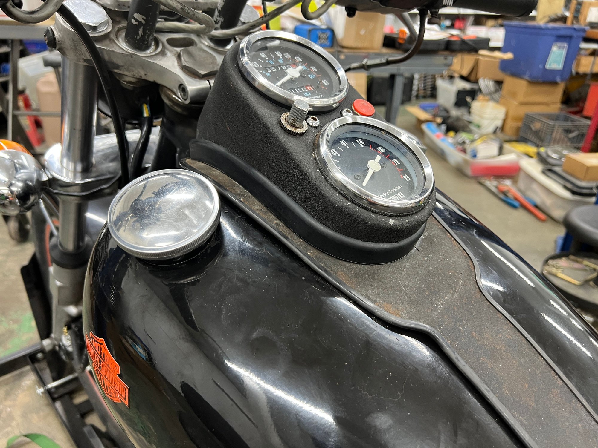

well, that's better (not perfect, but better. - and yes, I did end up pushing the rubber trim down to meet the dash trim panel).
I'm thinking the tanks are factory at this point, since centering them around the mounting bolts seems to have done the trick. When I'm ready to paint/clear them, I'll probably weld a centering washer to the mounts and delete the rubber bushings for an even better fit.
Oh yeah - got rid of that supplemental ground wire while I was in there - just factory dash wires now.

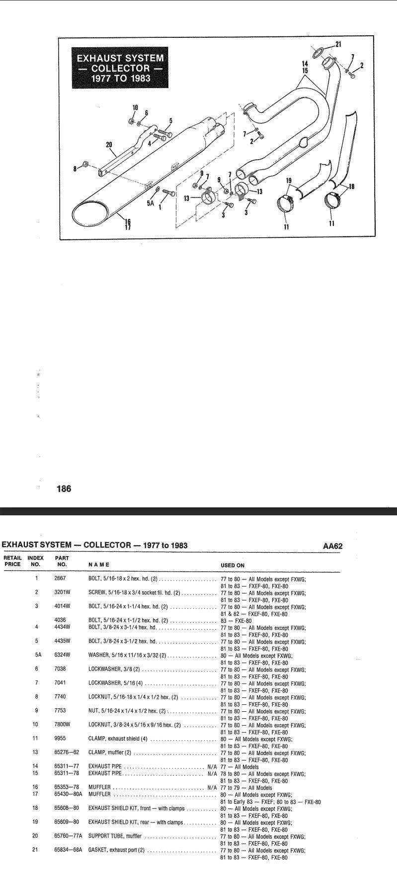

Pretty sure the 77 FXS had a slash cut 2 into 1. My ‘78 FXS has the slash cut original correct part number. I believe there are supposed to be heat shields on the header pipes on the Low Rider models 2 into 1.
not to detract from the topic, just for posterity for future users trying to determine correctness. Someone please correct if I’m mistaken.

That's right, but in this instance, the muffler was replaced in 1980 (tapered, correct for the FXB).
I may be wrong, but I believe the primary pipes are the same for both models, only the muffler changes. (Well, plus the heat shields, which were also 1980 parts if I'm not mistaken)
Oops! Looks like '77 pipes have a different part number!
