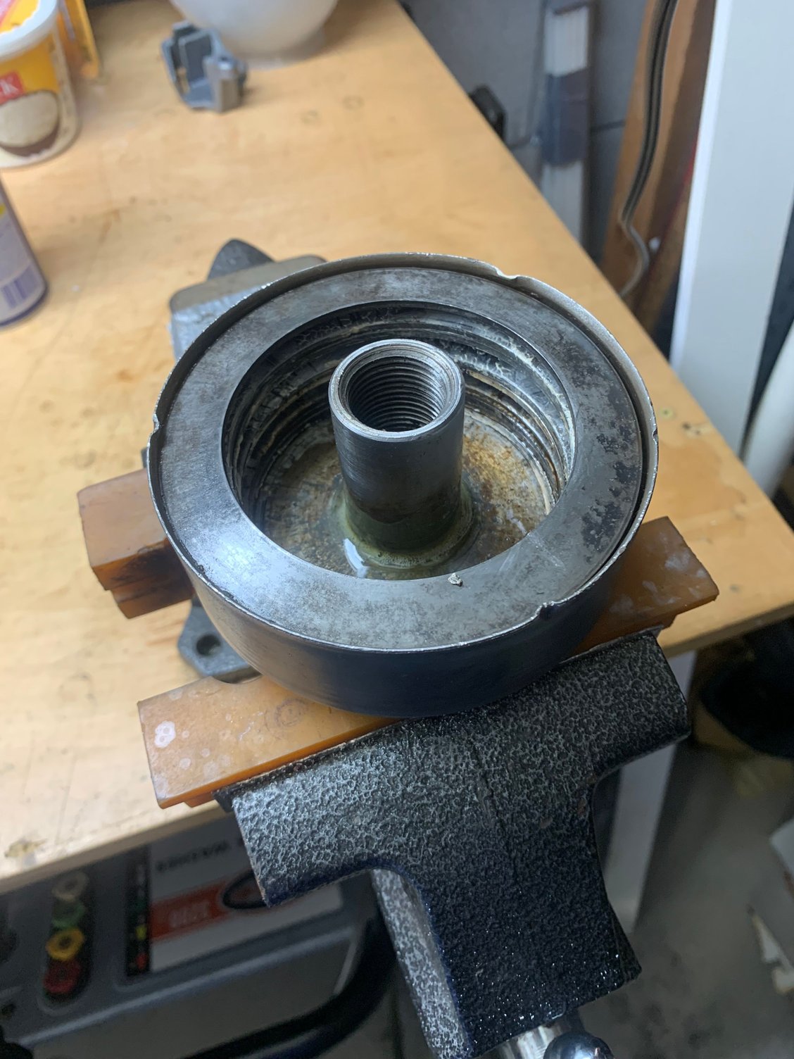

Bike is a stock 1976 FLH, changing some sprockets and replacing seals. My question is when the nut , 40392-70 is torqued down is the “Retainer cover assembly” able to spin. Right now the nut is frozen in the retainer. I assume from the diagram in the parts catalog that it should come out. Everything is apart but it seems I will need a new compensator as the nut is stuck. Maybe a press will help with out crushing things.

Thanks, that’s what I thought, the compensator came off, the spacer, rotor, stator all came off. It’s the nut that is frozen in the spring retainer.
Nut came out a fraction but froze.

What have you got going on there at the arrow? Looks like epoxy, or ?? corrosion?

Rubber hammer?

Question: Why would you epoxy that in? Any reason?

Probably red permanent grad loctite. Someone got a little sloppy putting it together last time..
Put some heat on it with a mapgas torch. Keep it off the springs.

No epoxy, sprayed penetrating oil in the Hope of loosening it up. Tried hammer with wood block , heat next. Thanks for tips

Penetrating oil does not dissolve or break down cured Loctite.
