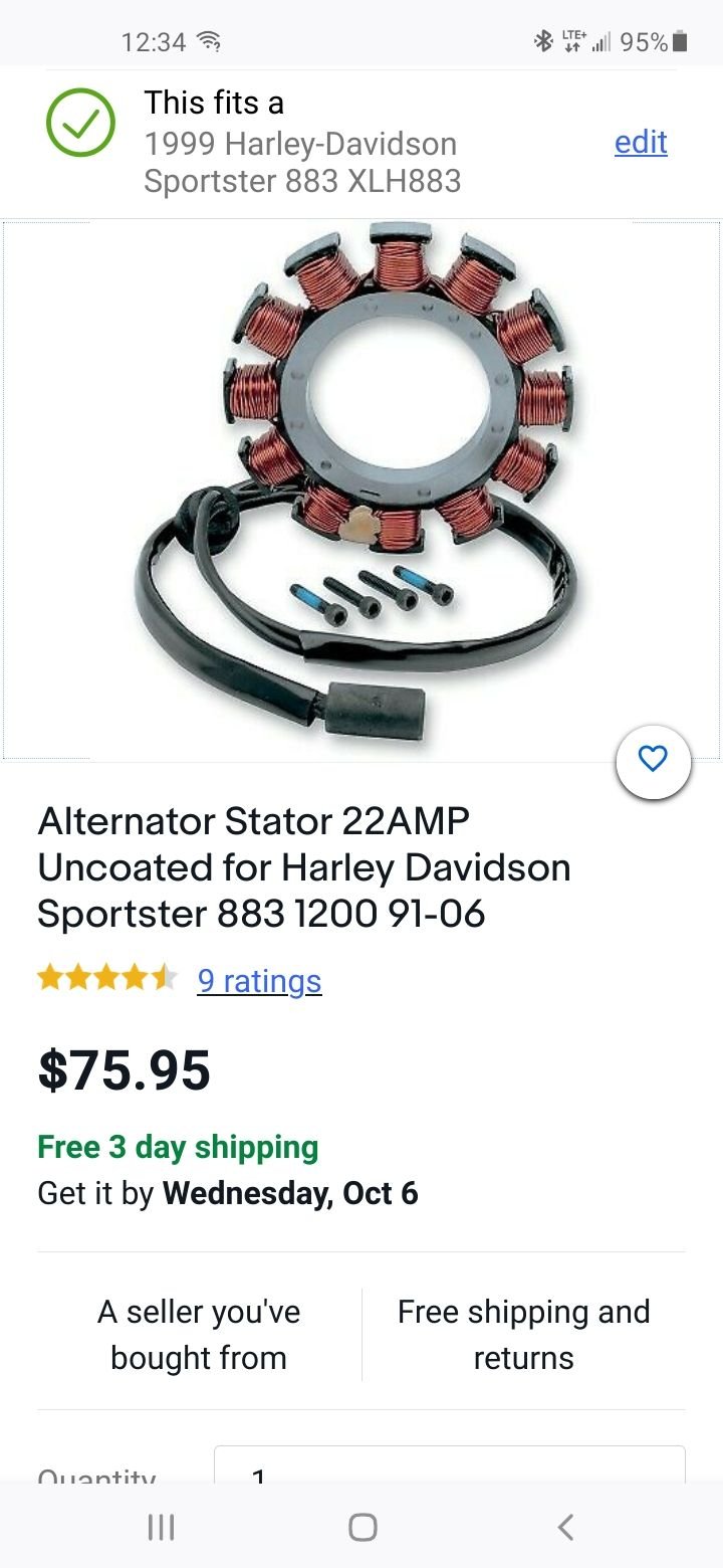

ANY shovel should get upgraded to the 32amp 2 pin charging system, kills all kinds of stupid with the old electrical systems and the batteries last longer if the bike doesn't sit constantly.
As John says they aren't all created equal so cheaper isn't a good thing. Cycle Electric while good stuff are real proud of their products and pricing shows it.

get quality. you dont want to keep pulling the primaries off
