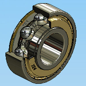

ThaGlyde, I believe that the 52mmX15mmX25mm bearings you want to change to are not near as good as the 52mmX21mmX1" bearings that fit onto your existing axle. Please search on this great site for the numerous 25mm bearing failure rate.
The 52mmX21mmX1" bearing has 2 rows of bearings and is thicker in width to accomplish this.
The 52mmX15mmX25mm bearing is thinner so HD can use the ABS sensor in existing wheels that is piggybacked. The 25mm bearings are about 1/2 the money also. They look like this:
To get your wheel to work you would have to purchase a pair of 1" bearings & a new 1" axle wheel bearing spacer to go between the bearings. Of course you would have to R&R the bearings which requires a specialized tool. Do not let anyone do the job if they do not have the proper tools as damage can occur and it is not good when the front wheel locks up at worst or leaves you stranded on the side of the road at best.

OP, all three bearings are 52mm in OD, 3/4" & 1" are 21mm wide & the 25mm is 15m wide. I hope that answers your question. The axle wheel spacers (outside) do not need to be changed and the inside (axle wheel bearing sleeve) needs to be changed to 1" as the ID is 1". They are only $6 at your MOCO.
