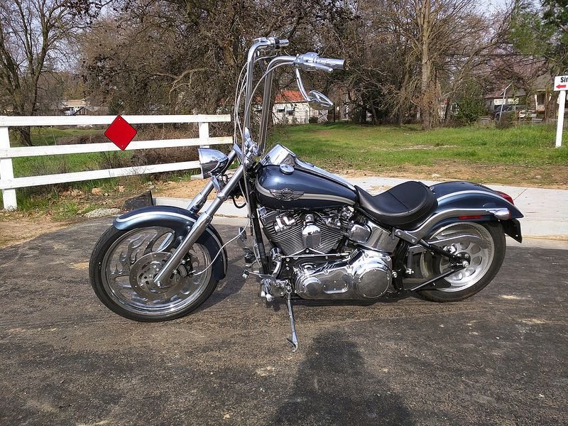

I used Blue Painters Tape and a Sharpie, worked wonders
Go Slow, running the wires through the bars is great to do on the couch with a beer while watching TV ......
Above, regarding the new hose for the tank.........I got stuck and couldn't remove my tank because that hose was stuck and dried on......so I just lifted the gas tank out of the way (propped it up on a piece of wood). Oh and I made a mess draining the gas.........watch that one too!
If you don't have "connectors" on your wiring, make sure you solder, it's tedious, but well worth it!
Remember to put heat shrink on before you connect and solder the wires :-)
And the snap O-ring for the Pin in your clutch lever is really small holes, doesn't fit a standard snap ring plier unless you have a nicer one with extra tips :-)
It was EASY........ it's just time consuming!

Might want to do a little something different with that brake line....IMO
already did........hehe I hadn't even bled the brakes yet, this was just a "making sure it worked" run. Thanks though
