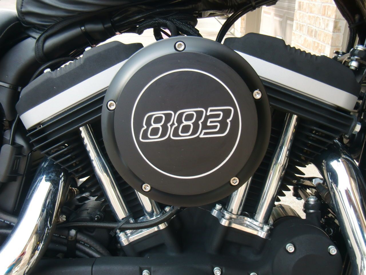

Just another opinion here... Below is how I did my AN Derby Sucker
(same backing plate as BigSucker), but it's not worth the effort/expense
unless there's some outstanding reason you want to do it, get the
DIY air kit from autozone (look it up) or the DKC one and be done with it.
In my case, I WANTED to run the Derby Sucker just so I could put any
custom TwinCam Derby Cover (clutch cover) on it to look different...
So here's a few more of the backing plate just in case you were interested
in how I did it. Note again, this is NOT cost-effective, I spent more on
AN fittings, braided hose, and catch-can than the cost of switching to
a different intake...
And where's what it looks like on the OL's Iron (yes, I've done this mod twice).
Hope this helps you decide you DO NOT want to do it this way...
