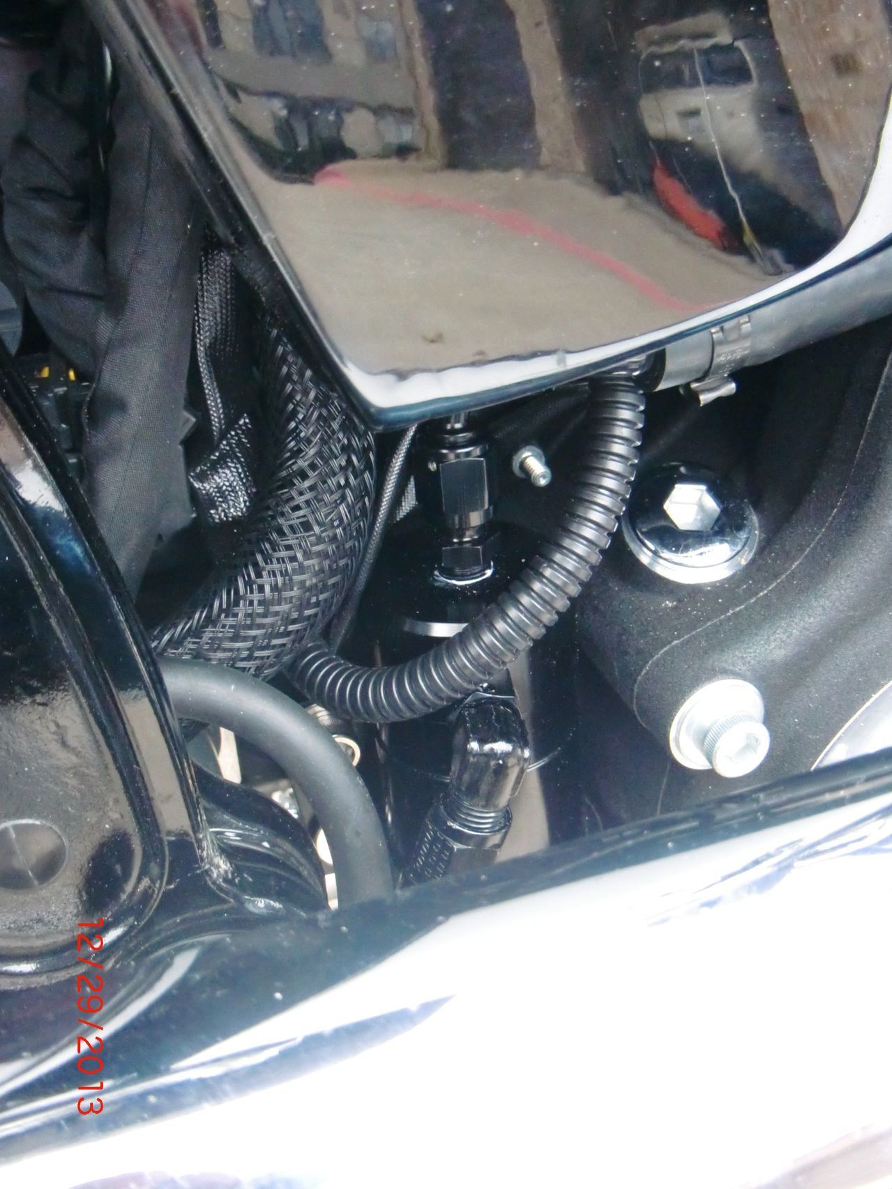

Good thread!
My catch can set up:

Looks good. I wanted my setup to be fairly inconspicous
so I used all black fittings and hose as well as a black go-cart
catchcan I got off amazon
Amazon.com: Aluminum Go Kart Cart Racing Motor Oil Overflow Engine Catch Tank Can: Automotive Amazon.com: Aluminum Go Kart Cart Racing Motor Oil Overflow Engine Catch Tank Can: Automotive
It blends in fairly well.....

Yup. Was given the catch can otherwise it would have been black. I need to re do the mount to tuck it in further.
