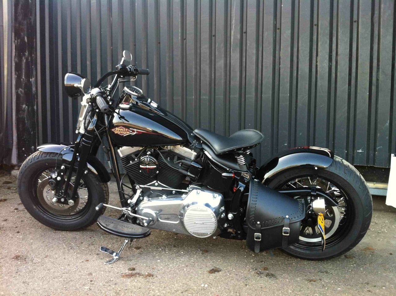

Ugh! My heart just skipped a little greenbax. I take it that is the stock(yet modded) HD spring seat & a shadetree fender? Would/could you put a passenger on that or is that a terrible idea?
Old Jan 4, 2015 | 11:21 AM
greenbax's Avatar
greenbax
Joined: Oct 2014
Posts: 246
From: San Jose
No that's his own springer seat kit and large solo saddle ( I have that seat, love it very comfortable).
Yes if you install struts then you can hold a passenger.
FYI it is a challenging kit as the fender is about 1/8-1/4" from the wheel, the fir has to be precise. Go with a 1/4" clearance at least IMO. Also do not get it painted or drilled. The reason being is he's out of state and if the holes are off you'll need to redrill. Better to get it without holes and have a shop u trust do it with you right there.
Here's a pic of my slim with the shadetree slim kit: (I went strutless, it's solo ride lol)
