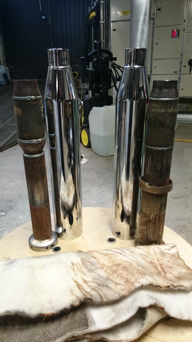

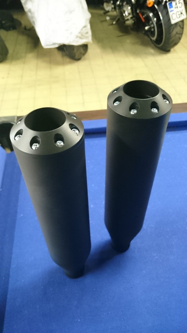

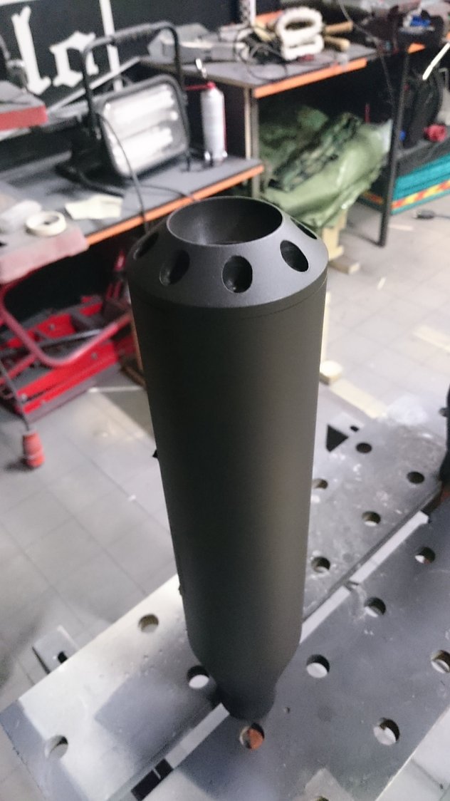

Removed the stock baffles inside,drilled the three rivets off the tip of the mufflers and beat the baffles out!

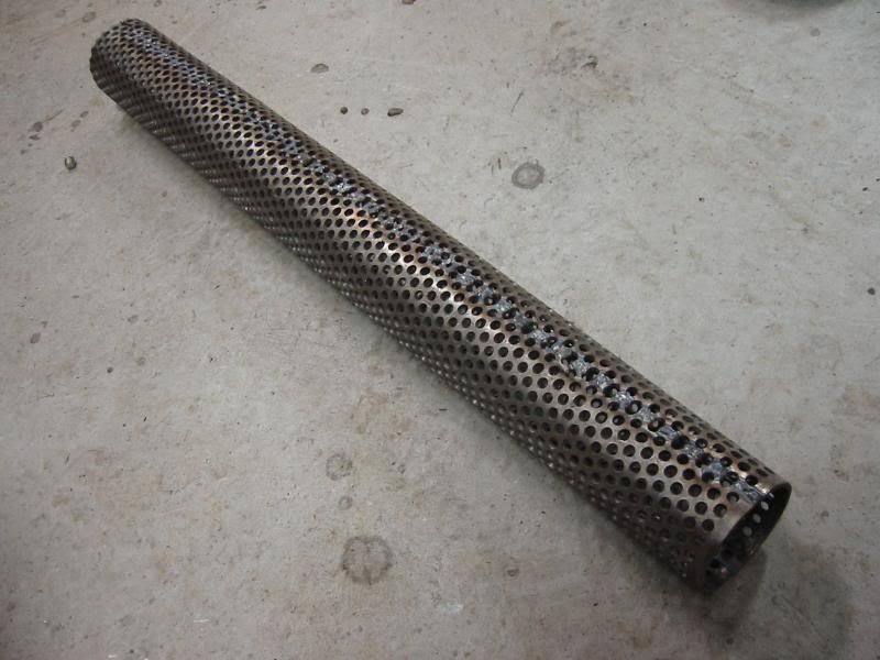

I bought 48mm meshpipe for the new baffle. and made it like screaming eagle baffle. Sorry i dont have picture of them finished. I was so doing it so i forget to take picture. =)
I made them work something like these,only more mesh pipe in the end of the baffle and without the widened section. The baffle slides inside to the billet end about 20mm :

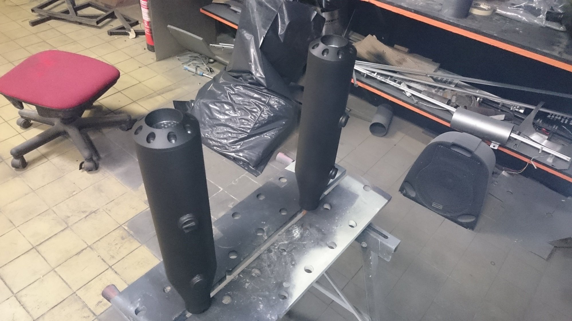

I shortened the mufflers core about 90mm,and i design and make billet tipends for the mufflers.
Here they are packed and first coat of ceramic paint on them.
Looking for to hear them and how they perform! Ill put them on bike as soon they are well dryed!
there is going to be chrome bolts in the holes that i drilled tipends.

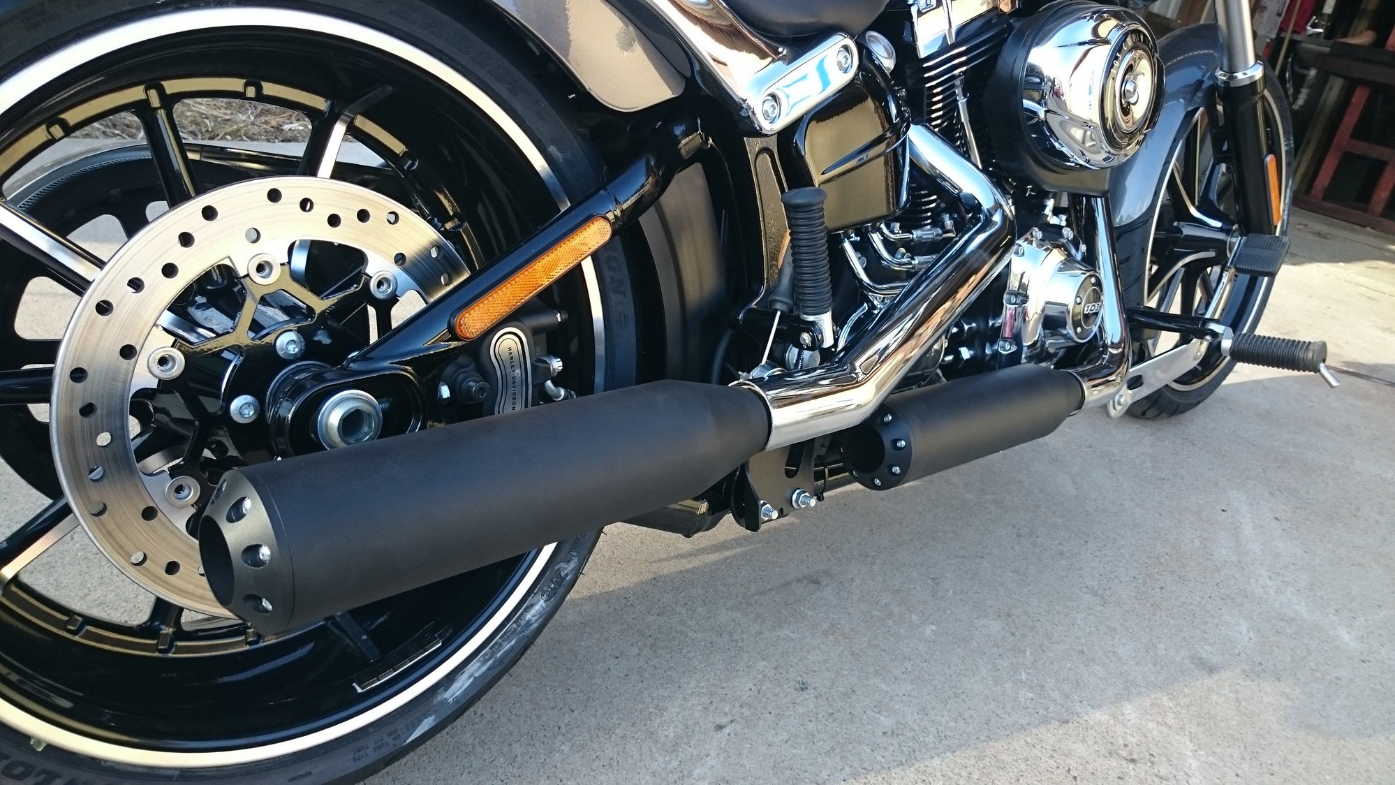

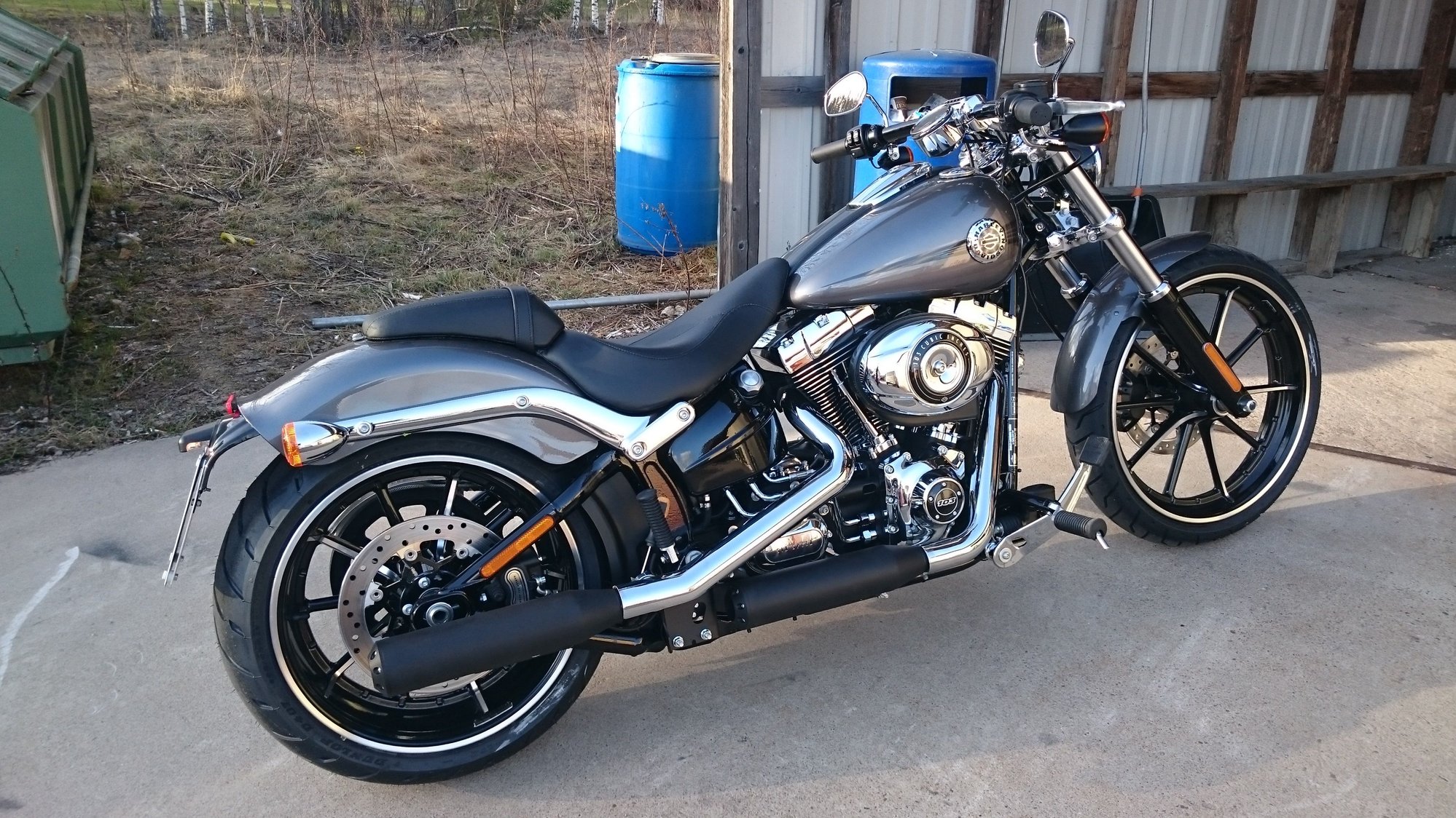

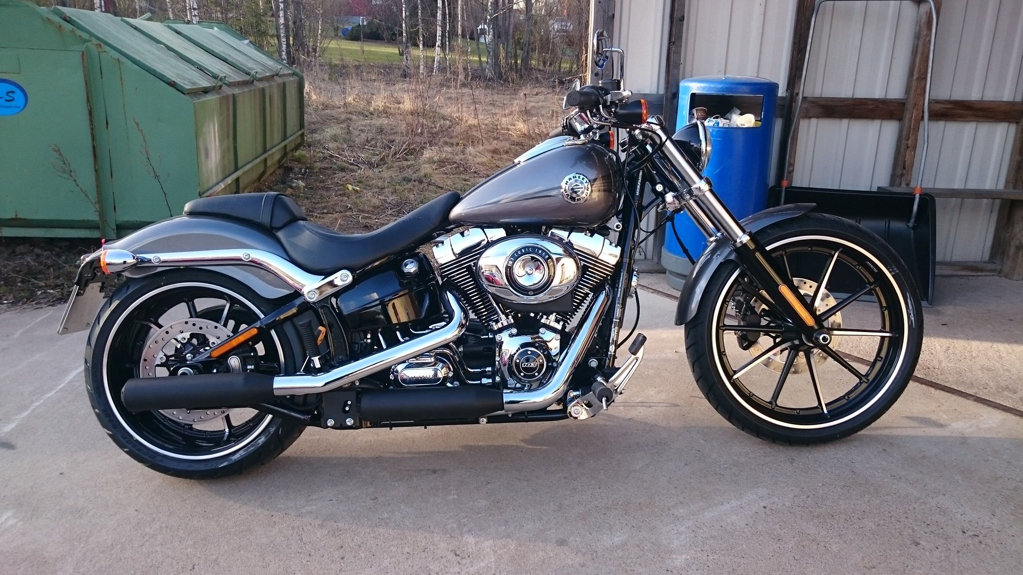

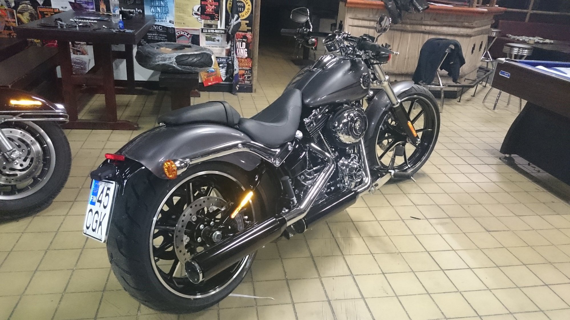

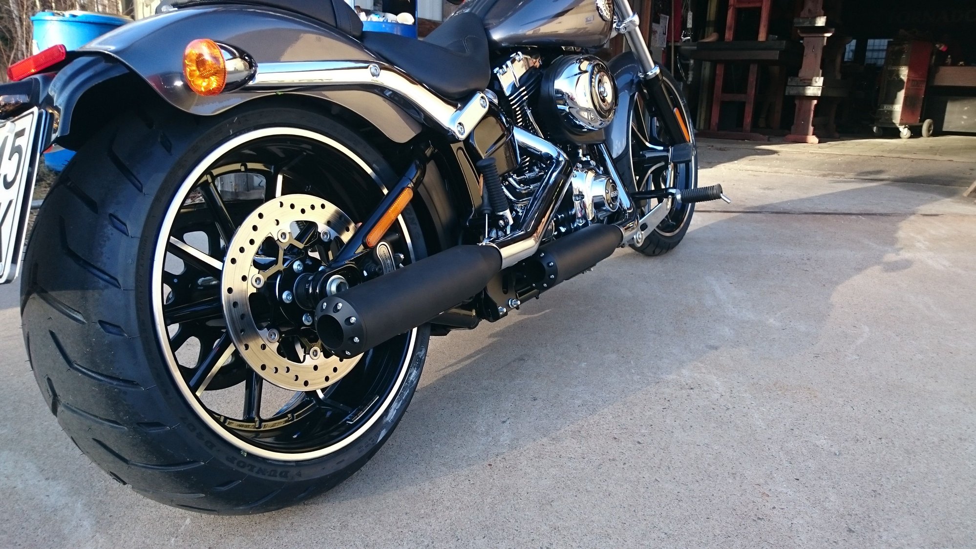

Heres bike with mufflers installed!!!
Just right amount of bark,not too loud. No compare for performance,becouse bike is new and driven 3km. Have to break it in first,before i let it loose. =)
