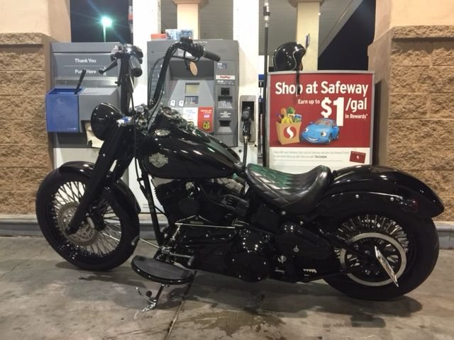

I ordered a CnC bracket for mine it was like 10 bux. you can kinda see it here:
I cut the stock holder with a grinder because you will have different length turns when you remove the stock plate holder.
