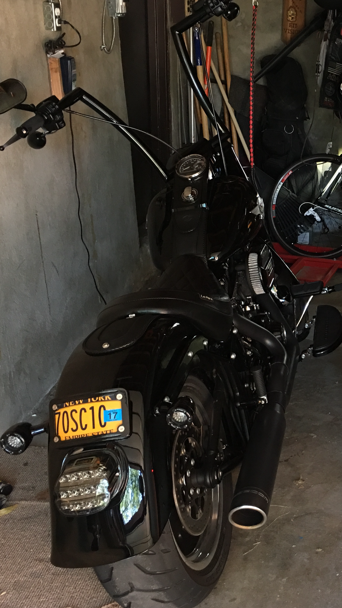

Here are my observations on the Vance&Hines (quiet baffles) after 250 miles on them:
PROS
1- Bike looks sick with the V&H (in special the chrome tips sticking out)
2- Bike sounds like a Harley (I have to say that because I only owned a few VRODS in the past-never a air cooled)
CONS
1- It is VERY LOUD... it did not just take the "high end note"
2- Some neighbors already complained about the noise!
3- THE WORST INSTALLATION ever on any previous slip-ons I ever installed!
4- The 4 screws that hold the slip-ons on the frame are almost impossible to access by hands with regular tools
5- V&H slip-ons do not have the nut welded to the muffler, so, to put the washer and nut and screw the bolt in place is simply VERY DIFFICULT, close to impossible... (I did it by applying some plumbing silicone to the nut and washer, so they stick together to the inside of the hole in order to have the bolt go in...PAIN...
6- AGAIN...VERY LOUD...I am even curious to know if they really sent me the QUIET BAFFLES...
!!!!MY MISTAKE...Just called in Vance and Hines, as I find the exhaust VERY LOUD, and I was told that the quiet baffles need to be bought separately. My is the OEM Louvered...Buying the QUIET BAFFLES and will review again.

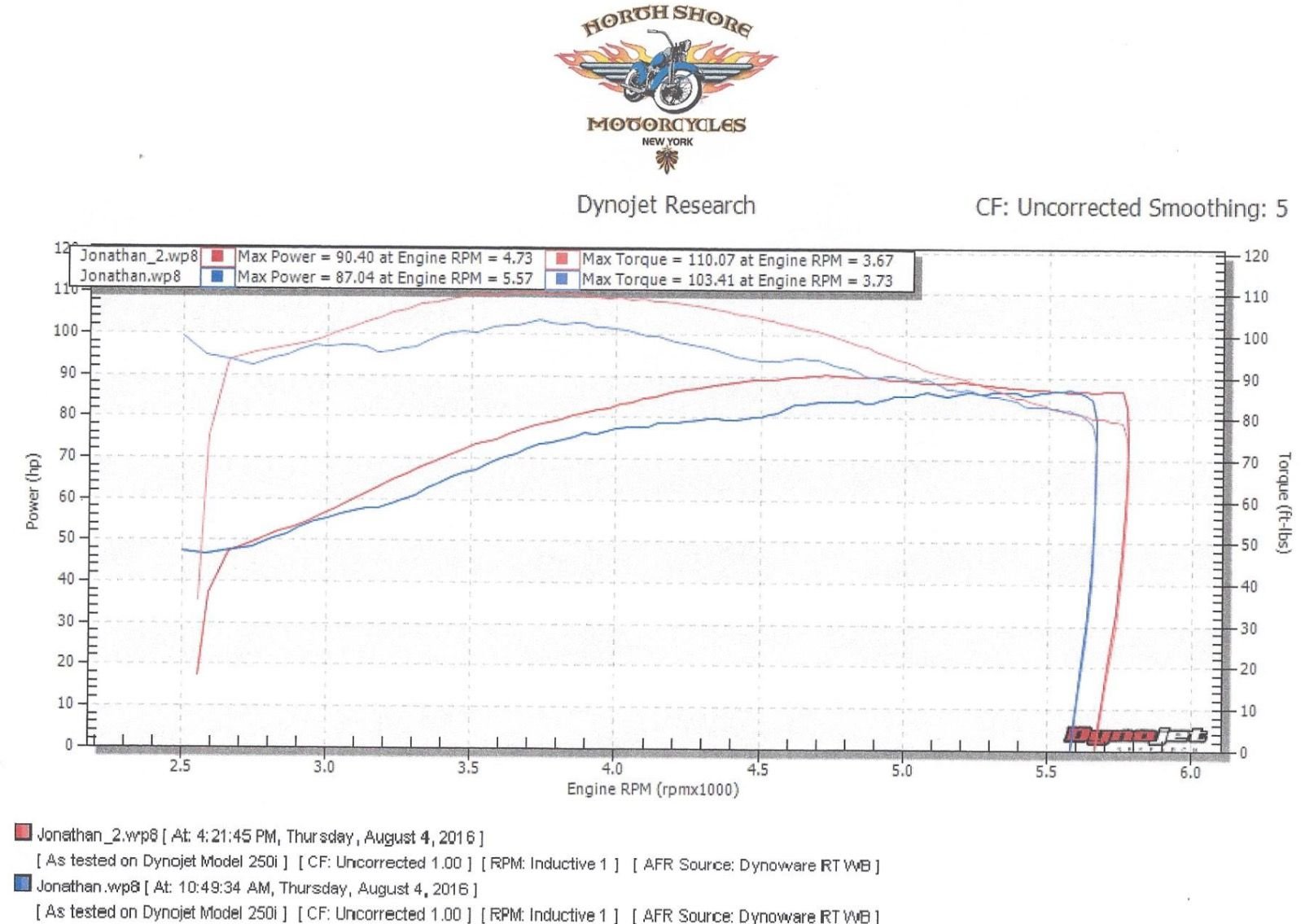

I purchased a Fatboy S a few months ago to add to my 2014 Street Glide Special...
A couple of things that I'd like to address... First are the claims of the sluggish 110.. Do not believe the hype! I cheated a bit in that I had a Freedom 2 into 1 installed before I picked the bike up, but this bike is anything but sluggish. I'm a fairly aggressive rider and I find myself taking it easy on the throttle because in choosing a seat for my height, I gave away having a good back stop and the torque on this bike makes me feel like I'm going to fly off the back! I'm using the Powervision flash tuner. Initially, I loaded a base map from Fuelmoto and it ran great with that map. Then, I had it Dyno'ed and this bike became something else! A pure beast that can blow past my boys on their stage 1 Ho 103s like they're standing still. My Dyno numbers came out at 90 HP and 110 ft-lbs of torque. Can't. Say enough about the benefit of a 2 into 1 exhaust and a proper tuning on this bike. Also, I would suggest looking into a company that ceramic coats their pipes like D&D and Freedom or having your Vanson pipe ceramic coated before the install. Without it, your black pipes will began to rust in a fairly short amount of time.

The Vance and Hynes QUIET BAFFLES make the exhaust sound very enjoyable with a distinctive Harley sound that it is not hard on your neighbor ears.
V&H should be able to sell the slip-ons with the choice of having the quiet baffles from factory, as the baffles are very hard to install...I was able to do it in about 1 hour, but I damaged the interior back end of the pipes as it is almost impossible to slip them inside and aligning the holes for the bolt!
That is a no go with V&H for the next bike, unless they redesign it or sell them pre-installed!
