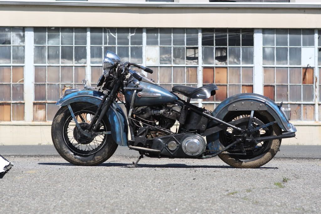

SLV and WKNDS, Thanks for all the info on the post seats.
SLV, I am glad WKNDS is helping you get your post sorted.
Question: I want a post mount, but I want to mount the post farther aft. After finally seeing the photos from WKNDS, it does not look possible, Even with lots of cutting and welding which I'm prepared to do, since the post would be over the battery area. Am I correct?
Would there be a place behind the battery to mount the post? (Welding an extension for the front mount, etc).
WKNDS, Your photos should be on the site that sells these seat posts!!!!
BTW, I am NOT saying your seat posts are too far forward. They look correct if you look at older Harleys. I would want to move the post aft for my riding position only.
Thanks again, Steve
Your seat post looks about like this, and is correct. My idea of mounting the post aft might look funny, but would get me in the riding position I want...
