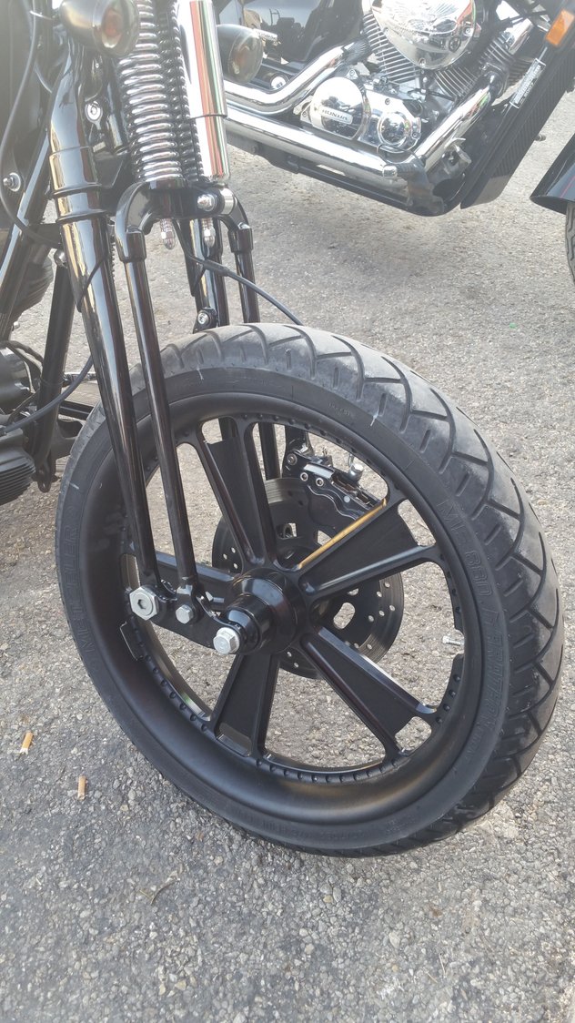

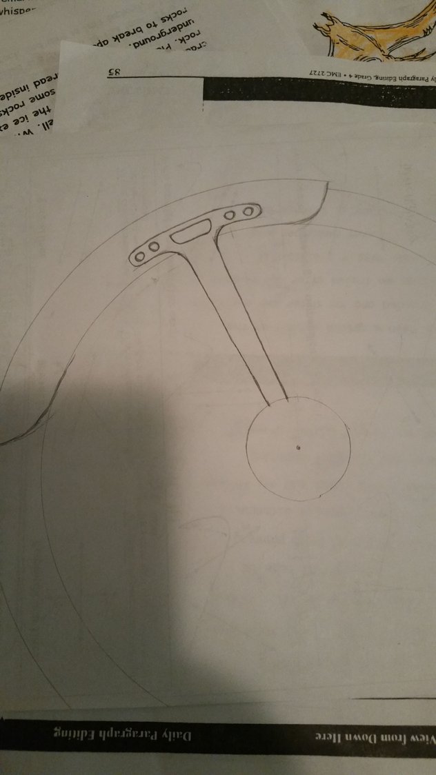

In the mean time, I'm working on building a front fender. Something I've been planning for years, but have never done. I drew up a basic sketch of my thoughts. Already have the sheet metal bent and working on a wooden form of the tire.
Here you can see some light marks on the tire. Playing with the fitment, size, and location.
A rough sketch of the basic shape I'm going for and an idea for the strut that matches the wheel.
