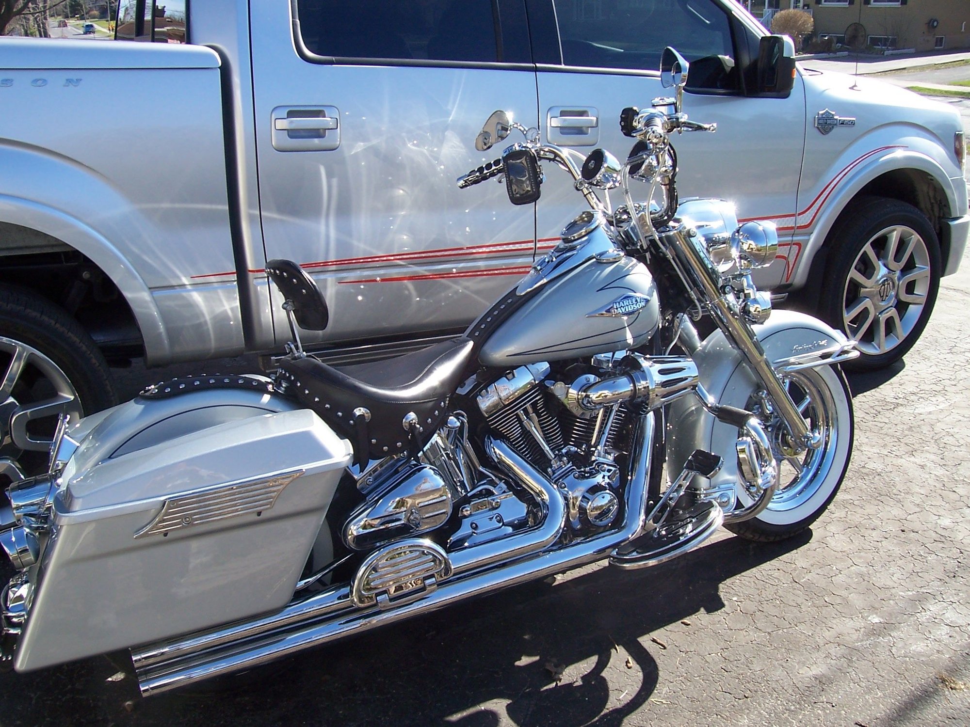

This was the bike the night I brought her home.

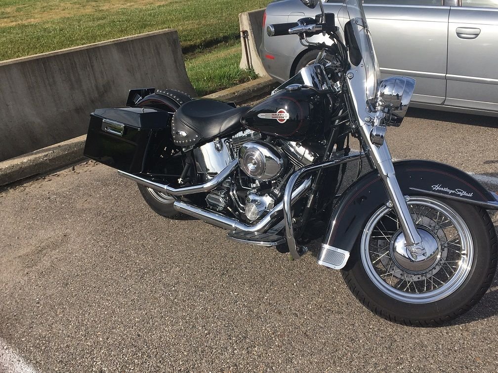

Default 02 Heritage baggertail
I went with the cycle vision kit, and a set of Hard saddle bags (no namers) off of ebay. Not a bad install at all and I didn't have to move or adjust the rear turn signals. No issue on the exhaust, my exhaust is pretty much centered on the rear axle. With the big stock Heritage seat, the front portion of the bag does touch when you need to open them, but nothing to crazy, and I may just go to a smaller seat, we'll see. Bags didn't come with locks, so I ordered a set and will have them on by weekend. All said and done, about $495.
