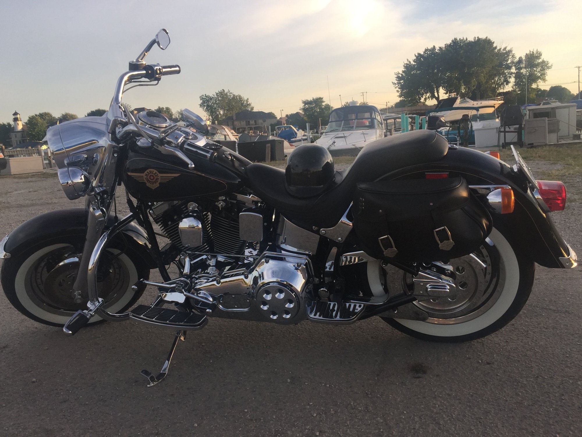

Hey guys, brand new to this forum and i need some advise and help. We own a 97 fatboy and have already started modifications to make it a bagger. He wants a 21" fat spoke wheel on the front which is what I need your help with because I want to surprise him. I am going to go with a Heritage fender since I know the stock one will no longer work. Questions.... I'm seeing 21x3.5 21x2.5 for the spokes and so on... Which one is correct? I'm seeing 21" spokes that say they won't fit on our bike. Is that because of the stock fender? I'll need a new whitewall tire as well. Is the size 120/70/21?? Any brands you suggest for michigan driving. lol..He's pretty mechanically inclined but I'd also like to know if any other mods will need to be done for this application so I can have the parts already purchased. Any help would be greatly appreciated!! He's gonna be very happy... especially if I buy all the right parts. Lol.
Here is a before pic of the bike and a cute pic of us.. Awwww lol...
