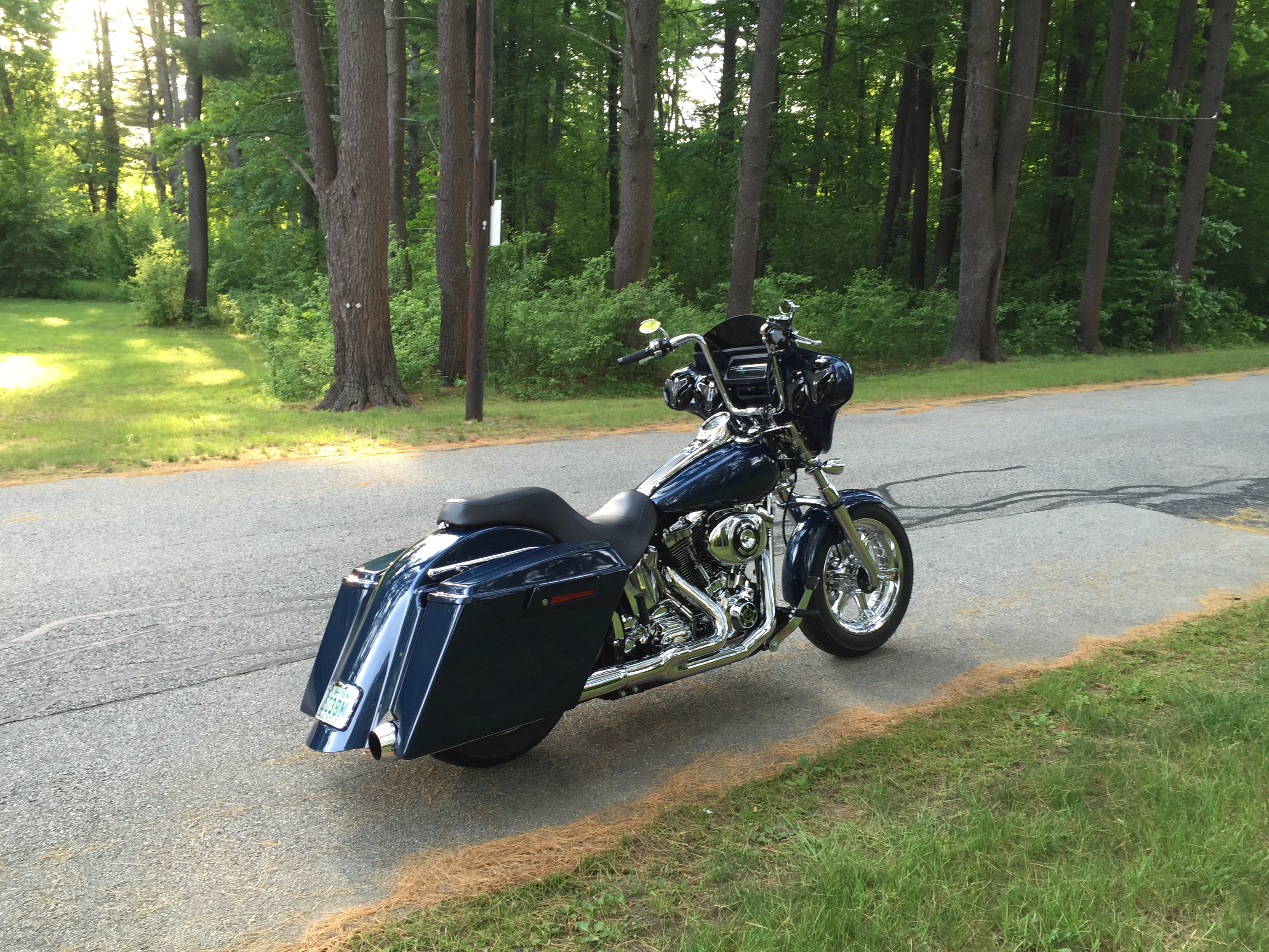

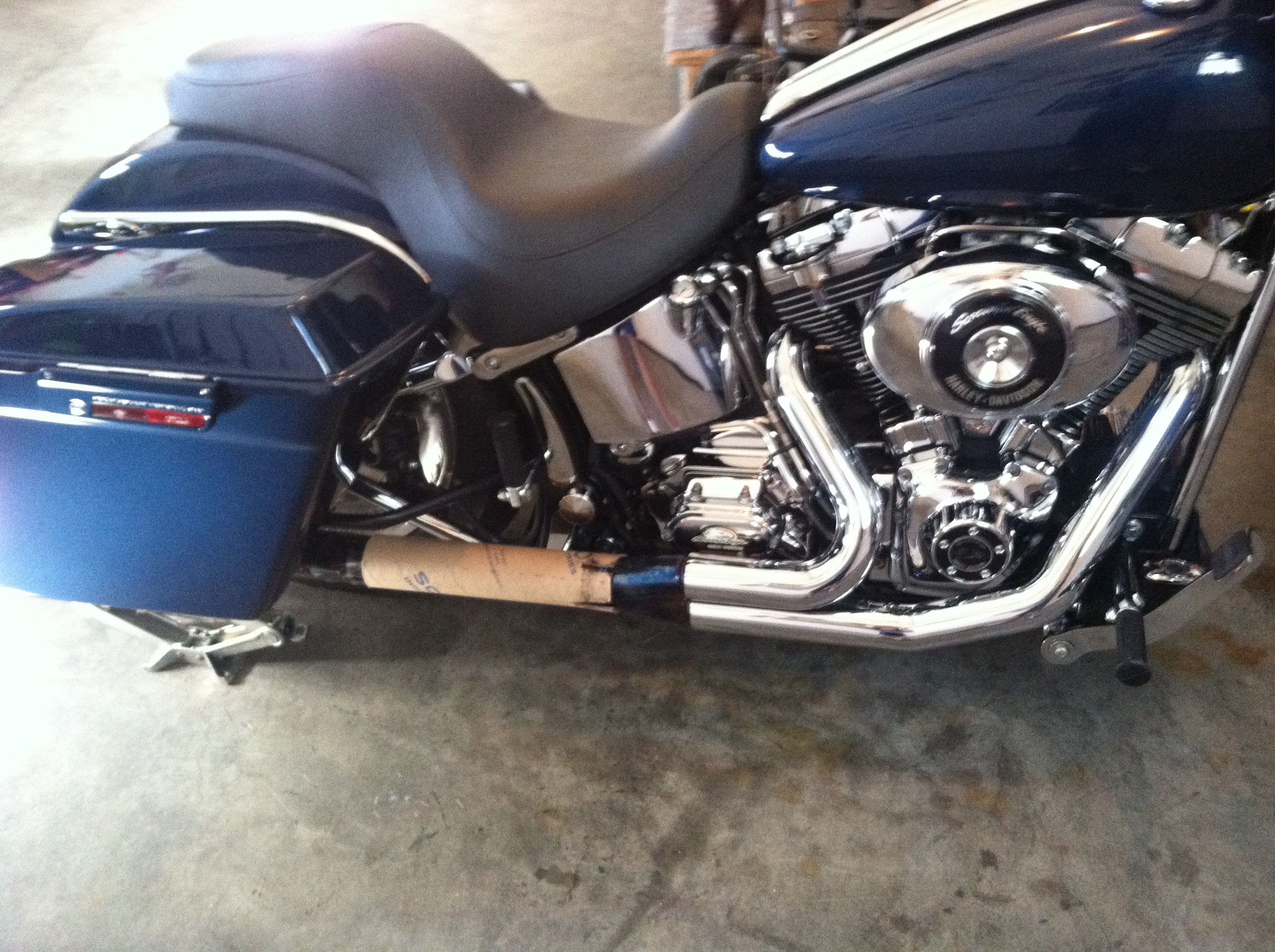

Bassani 2 into 1 here, went to the local autozone and bought a 14" pipe and cut it down a few inches. Fit perfectly between the headpipe and muffler. I then used a stock harley baffle heat shield to cover it and made a bracket extended out of flat stock. Pretty easy really and looks factory.

Looks simple enough. Any closeup pics?

This is a about all i have
