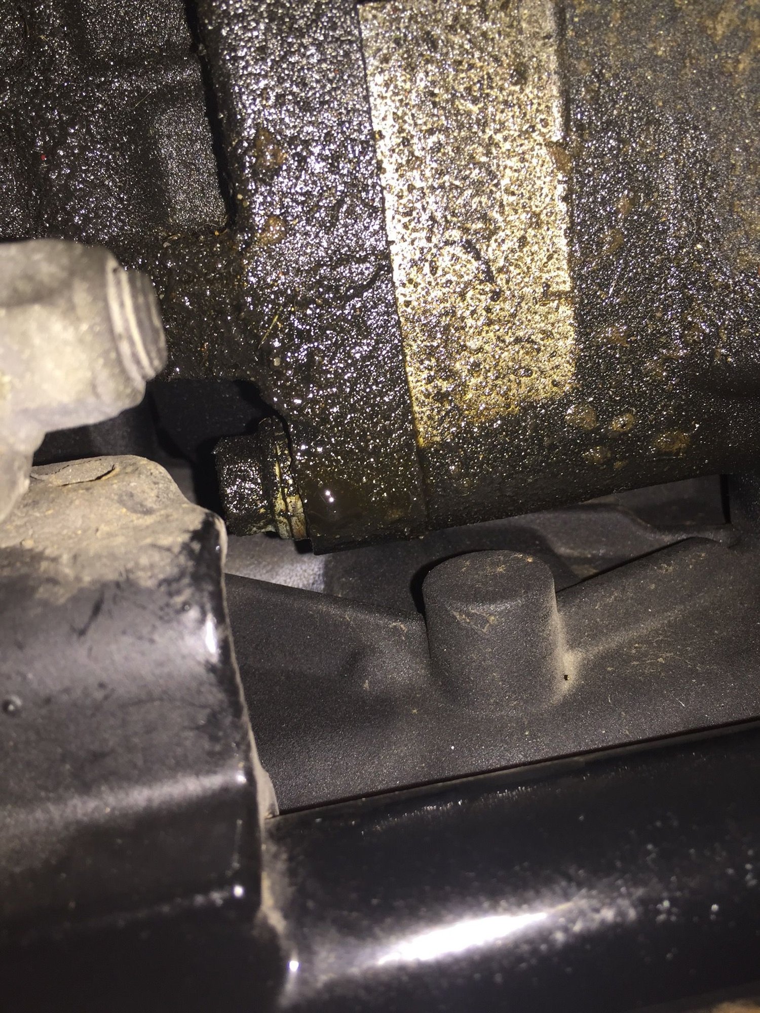

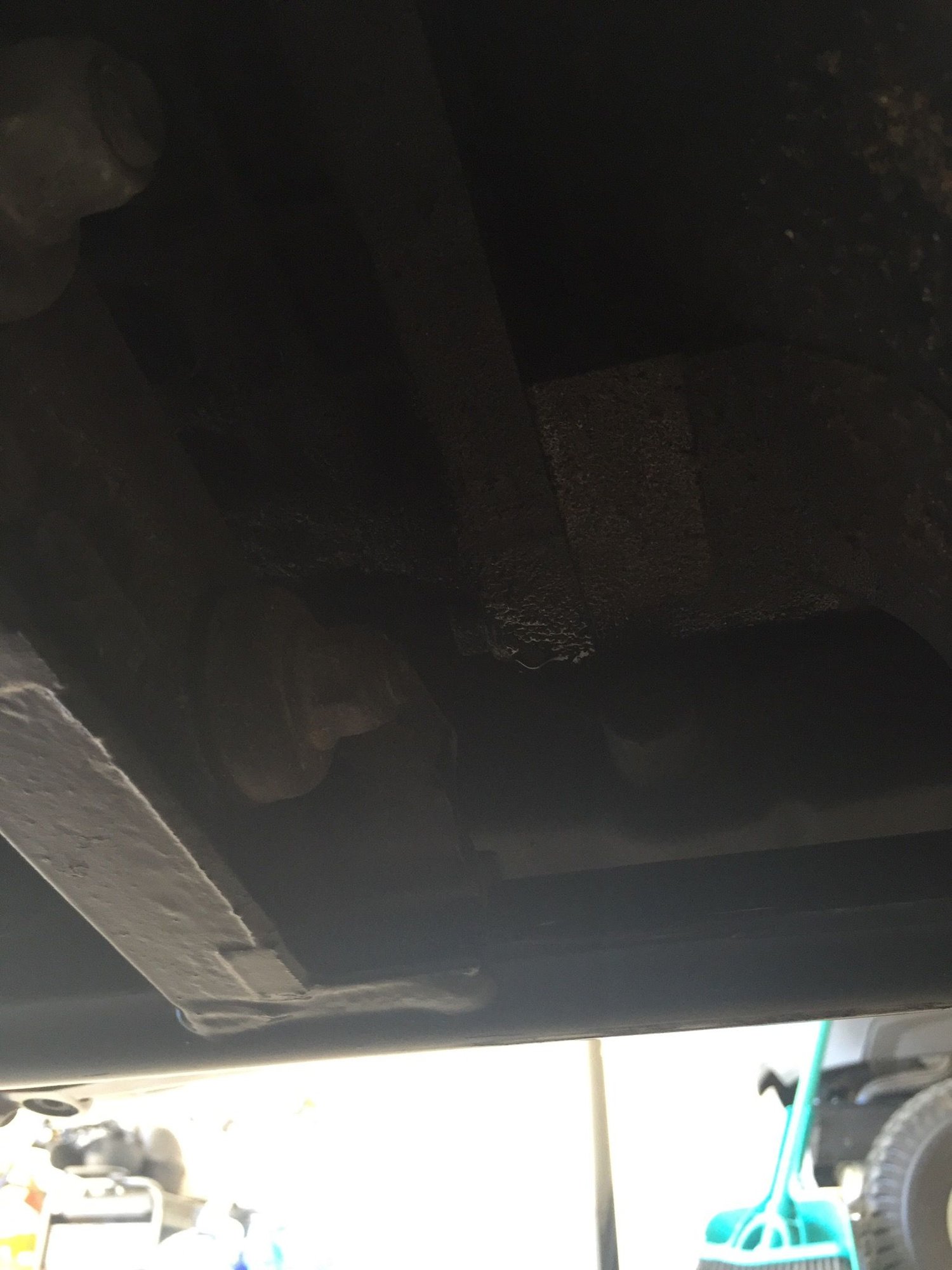

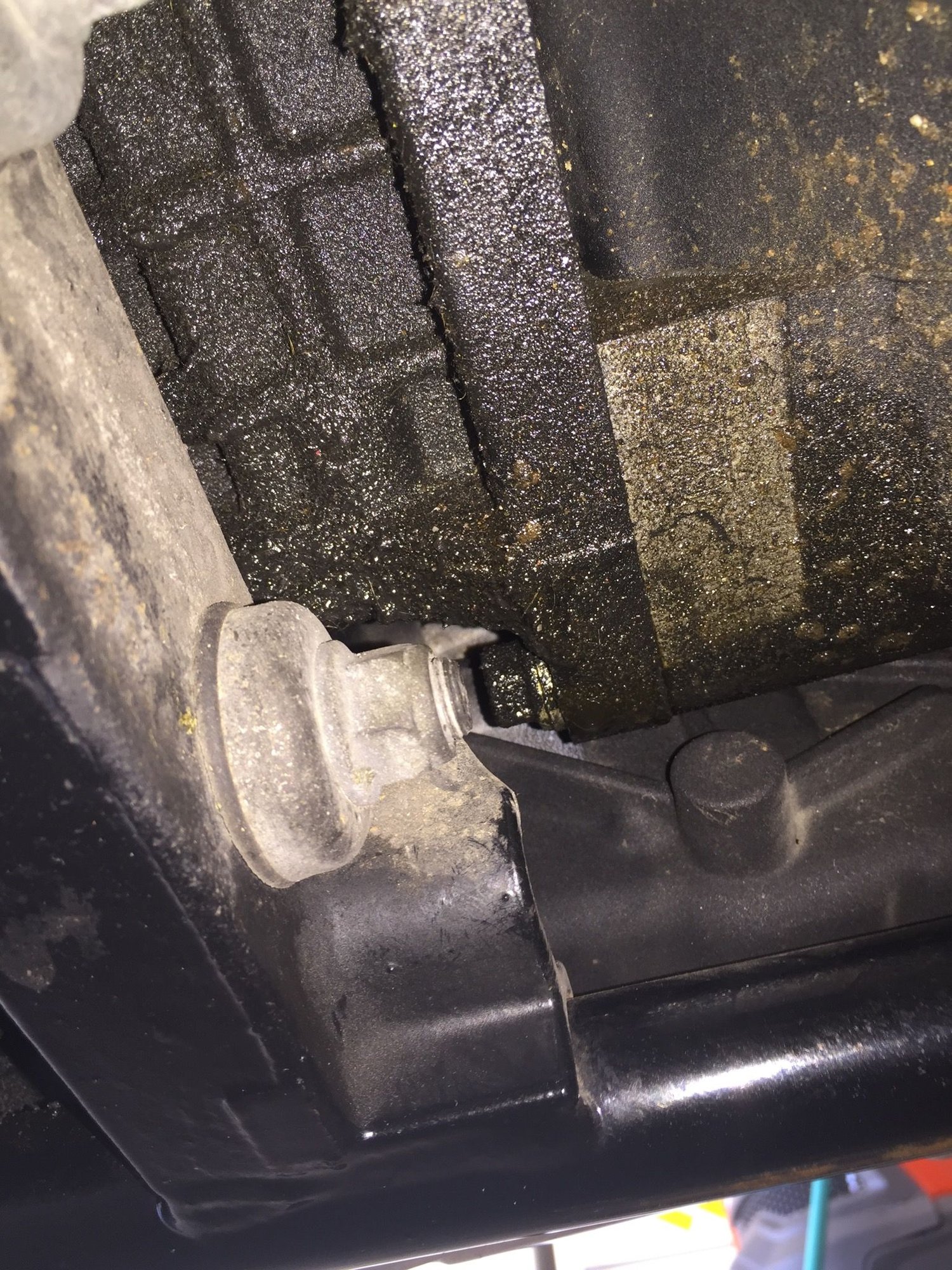

Originally Posted by PeterV
Get more specific. Pics would help
Hopefully this helps

Still not specific enough. That pic makes it look like its leaking from the swing arm. Where is the drip coming from on the bike and how much leaks after you ride?
My 2008 FB leaks from the same area. It usually drips from the primary drain plug and that's where I thought the leak was coming from originally, but it turns out that it is coming from above that area and trickling down to the lowest point, which happens to be the drain plug, and drips a lil puddle about the size of a quarter while it cools down. In my case, it's probably coming from the inner primary seal, tho i'm not 100% certain. I'll likely buy a primary gasket kit and replace 'em all this winter.
You'll probably need to wipe it down under there while it's cool, run it and get it up to temperature (ride it a bit if need be) and then get up in there with a flashlight to see whereabouts the leak is coming from...

The oil is getting blown up onto your belt from the wind while riding. Same thing happens to mine...
Still hard to tell from those pics without a complete wipe down (and perhaps without cleaning that muck off the bottom of your motor with some brake cleaner), but I'm going to take a stab and say that leak looks to be coming from the transmission, just going off the general area of the leak. Leaking oil looks fairly clean, which could also indicate tranny oil...
