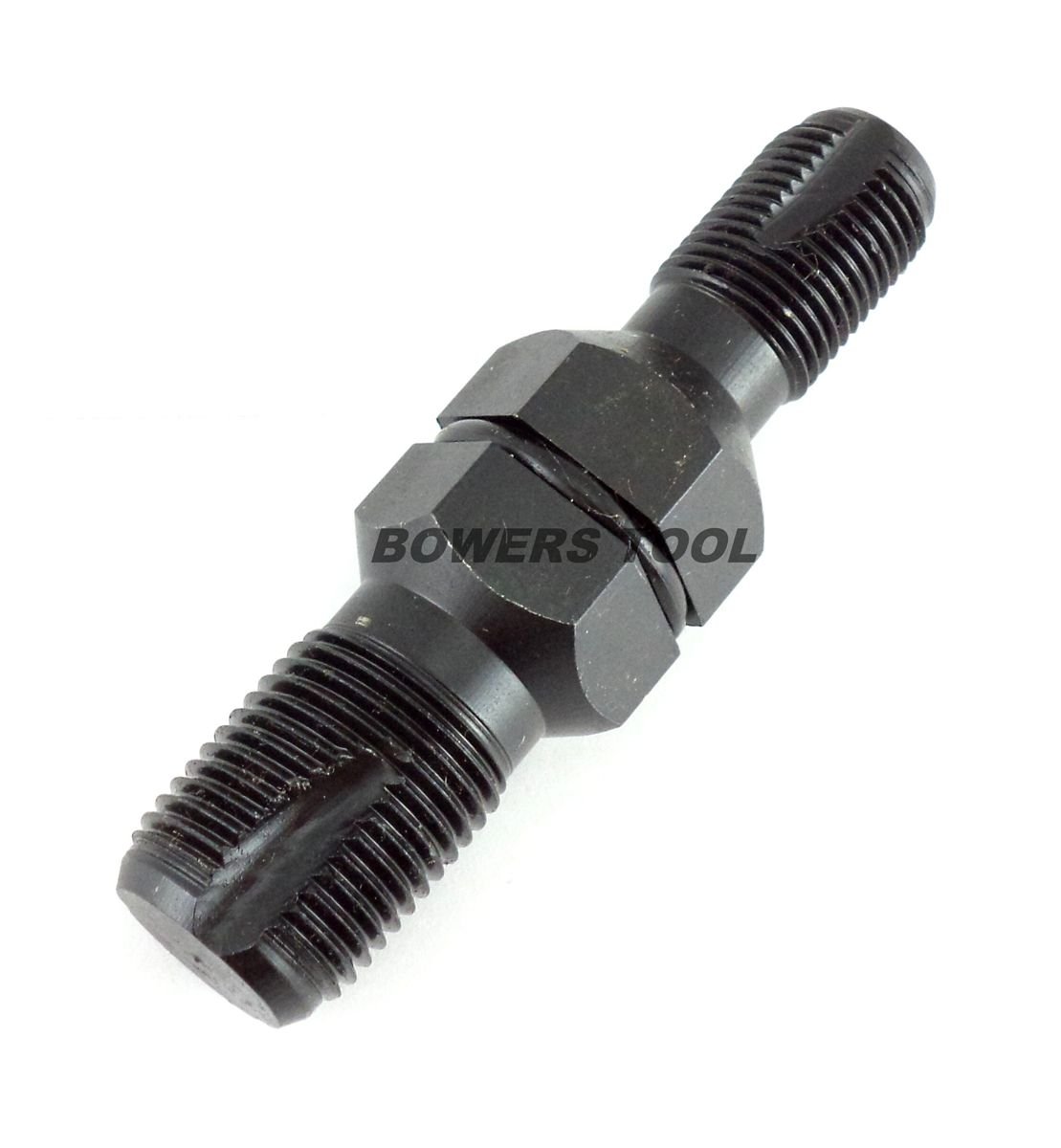

Next time use a thread chaser instead of a tap (or die) because you risk cutting the threads oversized (or undersized if using a die) and that will create bigger problems.

I'm looked at some images of "thread chaser" and they look the same as a tap.
Can you educate me on what is the difference? Thanks
