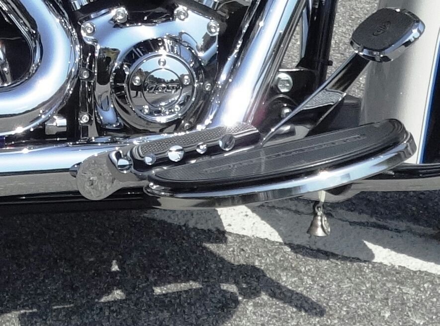

dfwhockey17's Avatar
dfwhockey17
Joined: May 2014
Posts: 2,400
Likes: 284
From: Fort Worth, TX
If you change your kickstand to a Heritage one, you can use the longer version of our stock floorboards from HD. They are one inch longer up front and three inches longer out back; this would give you more than enough room to move your feet around or get them flat on the boards. I wear a size 13 shoe and these boards with my extended brake pedal and shifter arms make for plenty of room for my feet.
