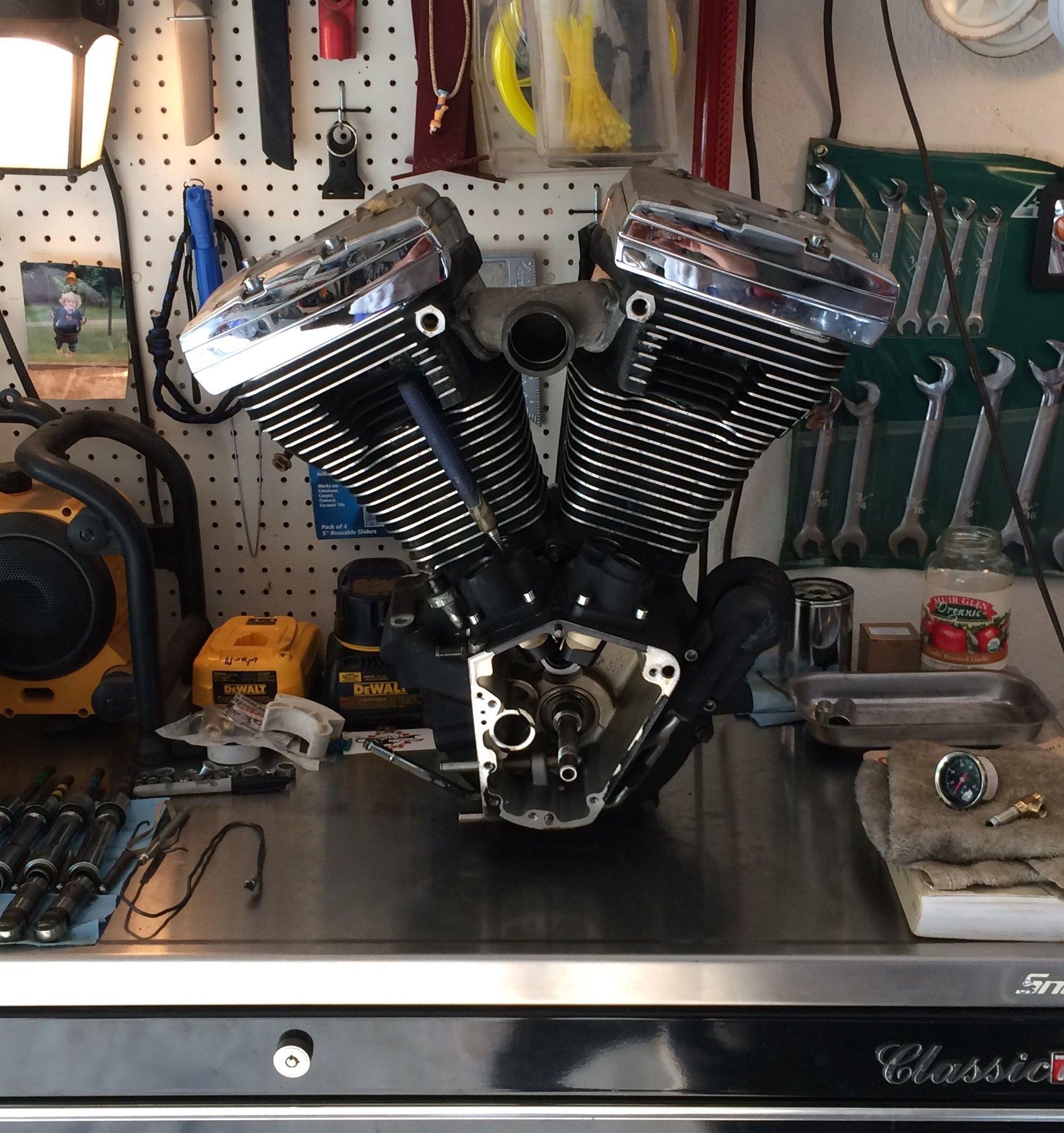

Old Jul 13, 2017 | 07:55 PM
  #56
Dad'sBike's Avatar
Dad'sBike
Joined: Jul 2017
Posts: 31
From: Oklahoma
Made some progress today.
This will give me a chance to get in there and really clean and polish some areas that I otherwise wouldn't be able to get to.
