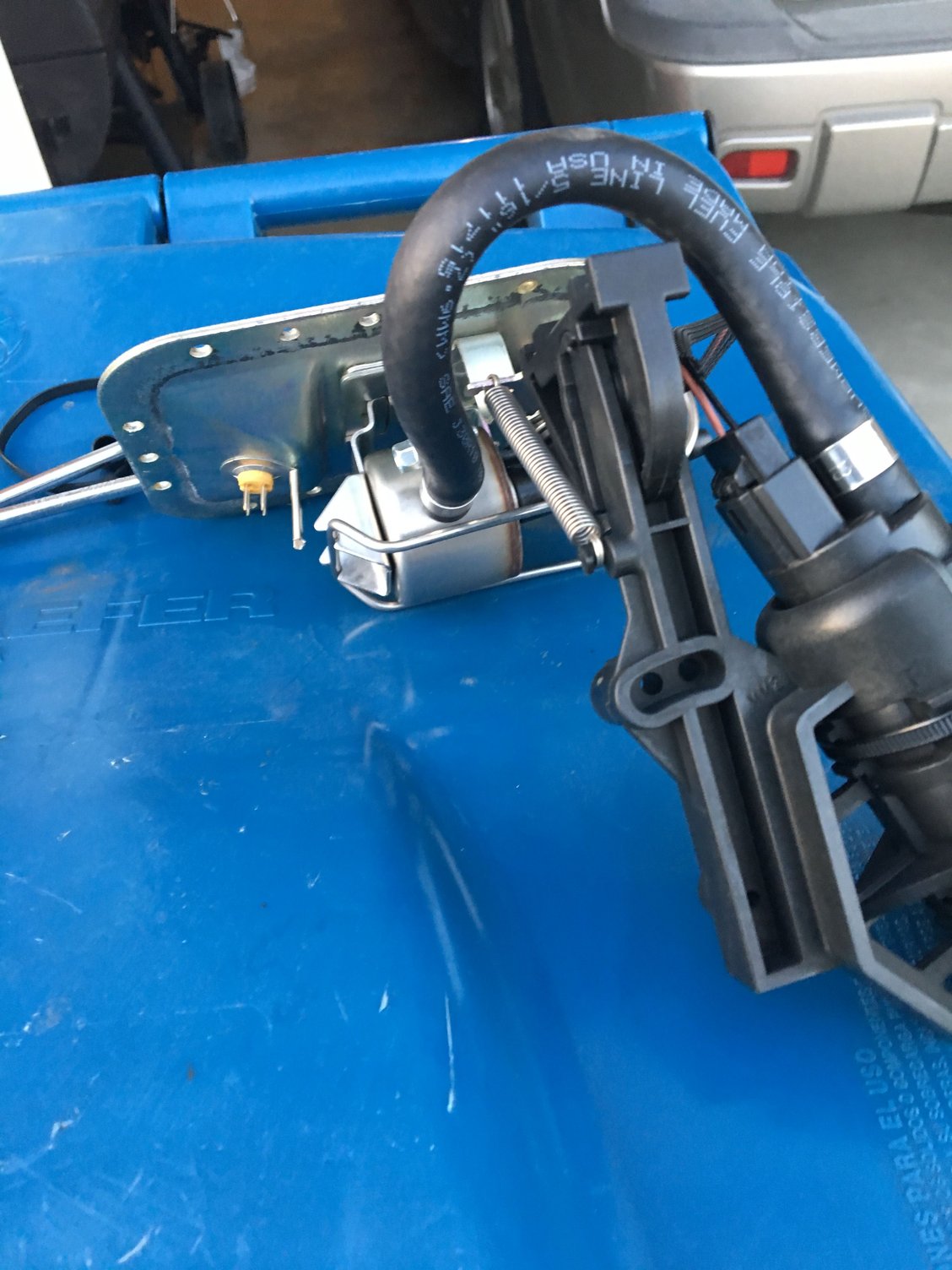

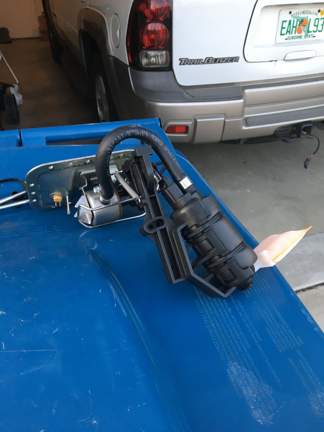

I have done this job a few times. The first time I did it I felt blind trying to work the hinged arm but it is not that bad. The fuel level sensor is on its own on the right side of the tank so you just have to unplug the wire harness and remove the pins. The fuel pressure regulator hat is plastic and has had a history of breaking the ears causing a fuel leak. Once you start the job I would replace all fuel hoses, fuel pump sock, fuel pressure regulator hat, and fuel filter. I used gates submersible fuel hose on mine with fuel line clamps which have a rolled edge so it does not cut the fuel hose
Here you can see the hinge strait to remove assembly from tank
Here the hinge is in the position in the tank
Closer look at the hinge

So, with a big screwdriver, you push the hinge down and back, correct?
