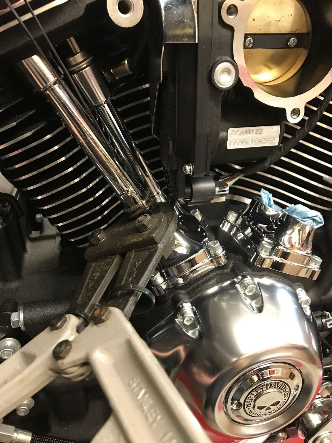

First, you need to cut out the stock rods, raise the rear wheel, shift the bike into 6th gear so that you can easily turn the motor, remove left spark plugs and set front cylinder lifters to there lowest point, wait 10-15 minutes, make sure both front push rods spin freely between your fingers and cut away. Move to the rear cylinder, place push rods again to there lowest point, wait another 10-15 minutes again making sure both rods spin freely and cut away.....

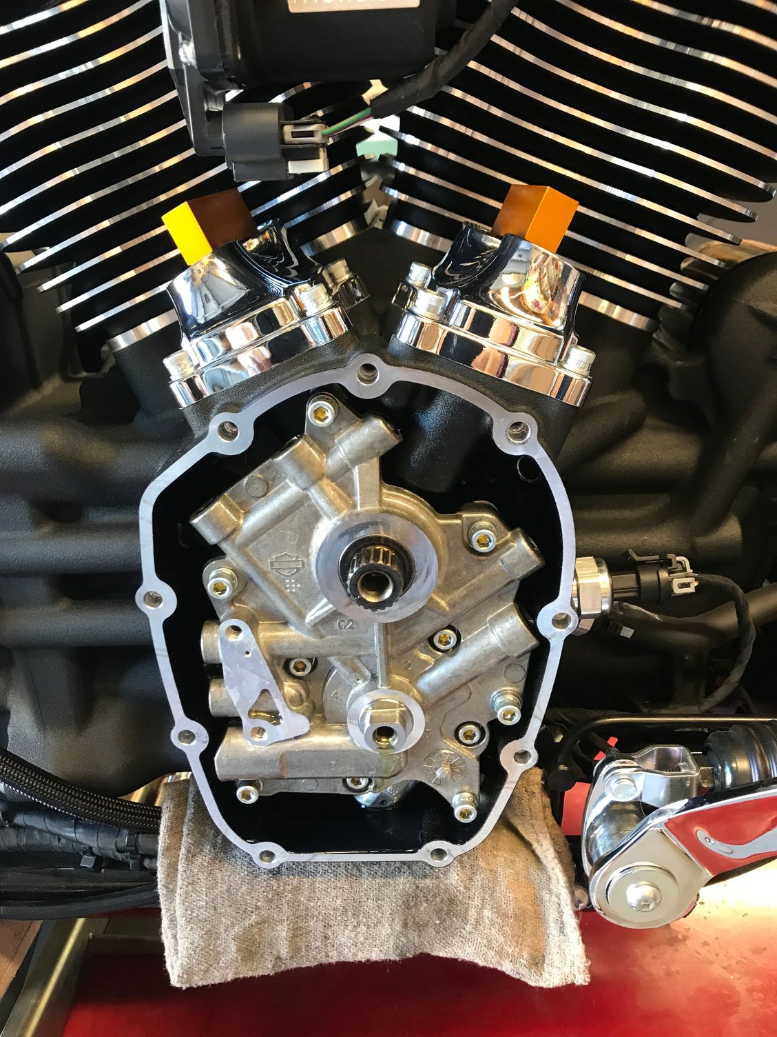

Next, I'll pull the timing cover, let the oil drain for the night and while I say the same.
Good night...I'll continue this tomorrow.....
Set lifters, cut push rods...
remove cam cover, align timing marks, let drain..

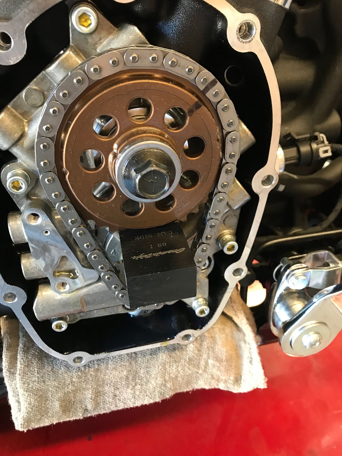

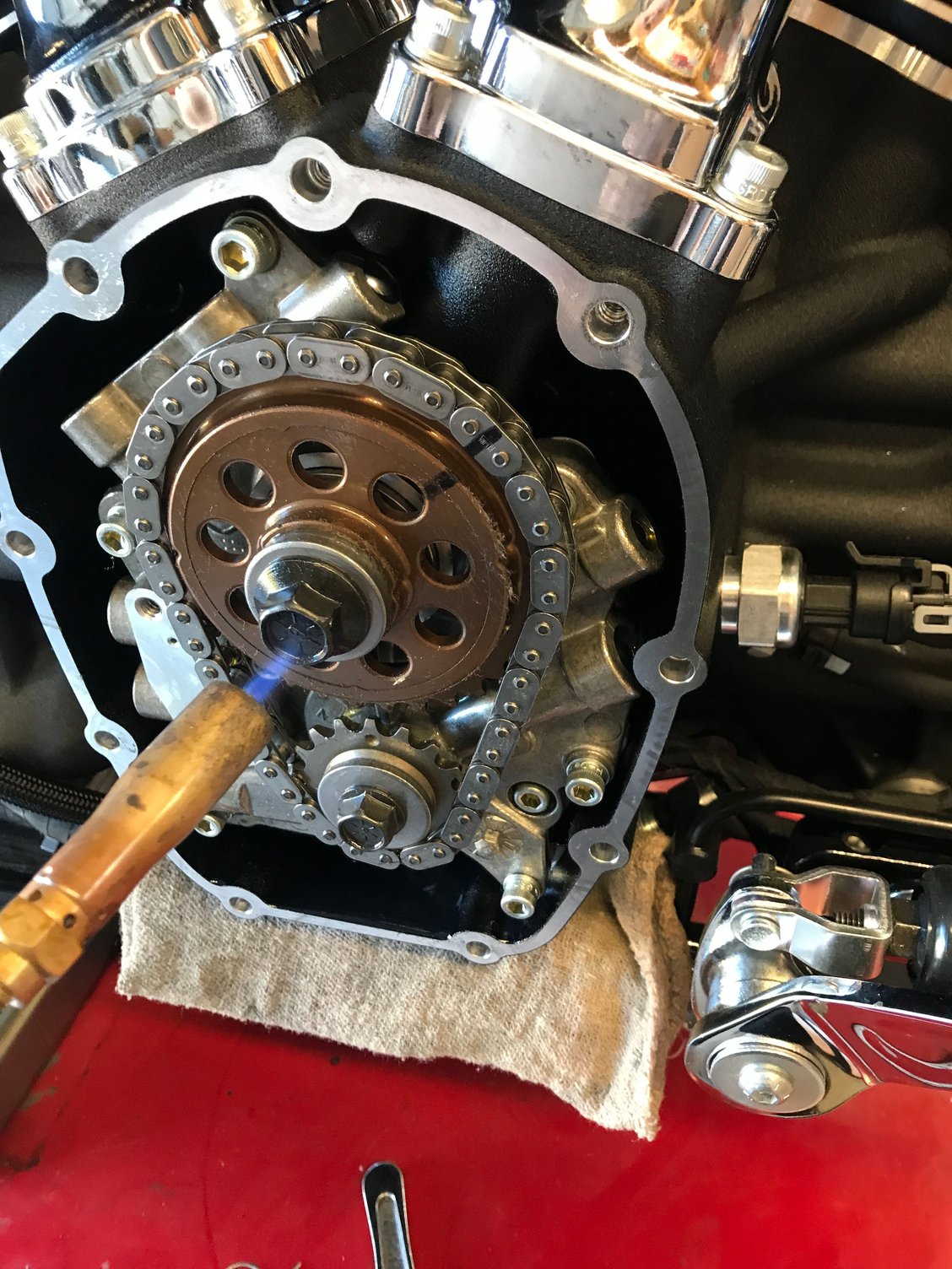

Ok, first I apply some heat to break the thread lock on both the cam sprocket and pinion bolts.
Note sharpie mark so things go back properly, install cam locking tool and remove screws.

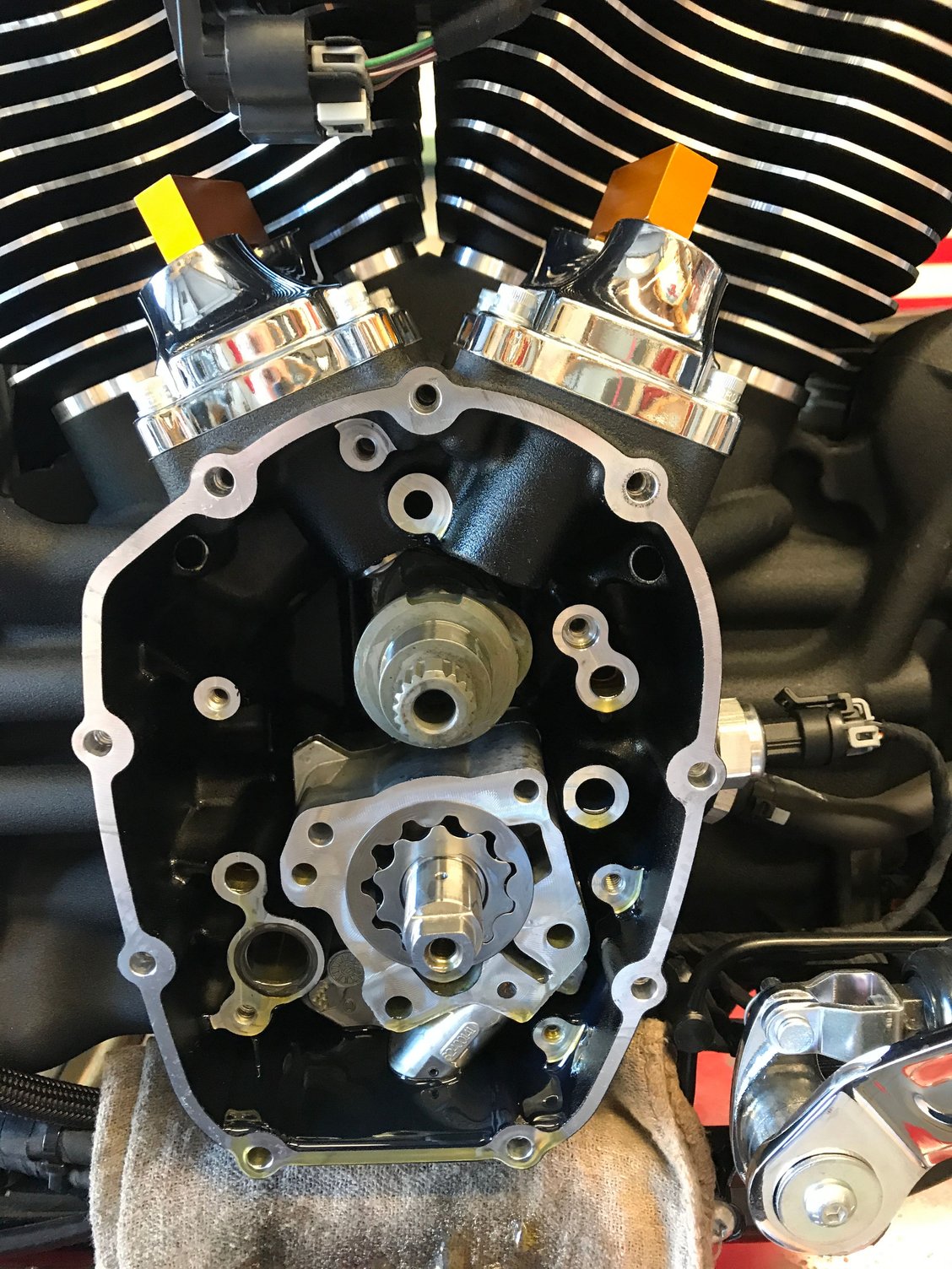

Install SE liter holders and pull cam plate. Careful to keep oil pump on pinion shaft.
Ok, this is where I normally change out the cam bearing, see note at end. Next I lubed everything up real good, installed the new cam and a oil feed o-ring and reinstalled the cam support plate.

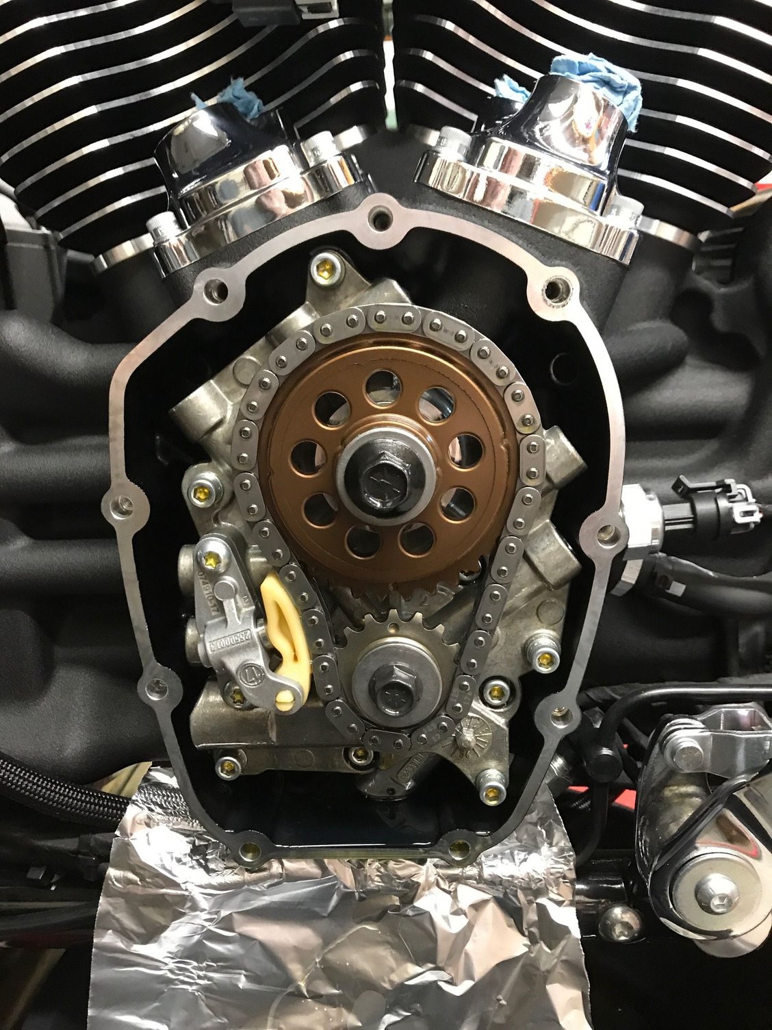

Ok, here you want to pay attention to the sequence in your service manual and torque and align oil pump to specifications. Ready now to measure cam gear spacer and reinstall cam/sprocket gears and chain. Be back soon.
