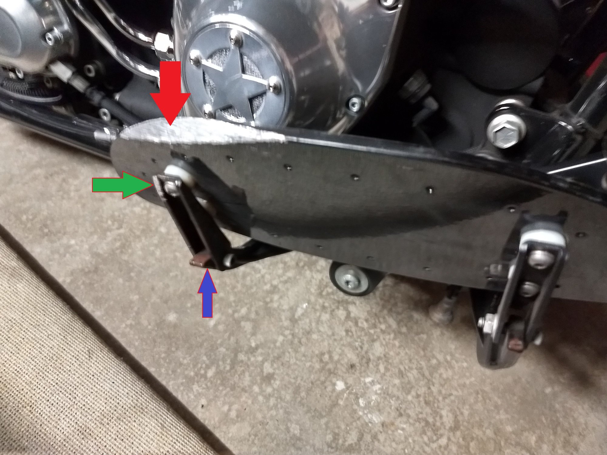

My badge of honor with my Cyclesmith Banana Boards. (Red arrow)
Starting to get a little too far (Green arrow)
Hit here and it's going to get ugly...(Blue arrow)
