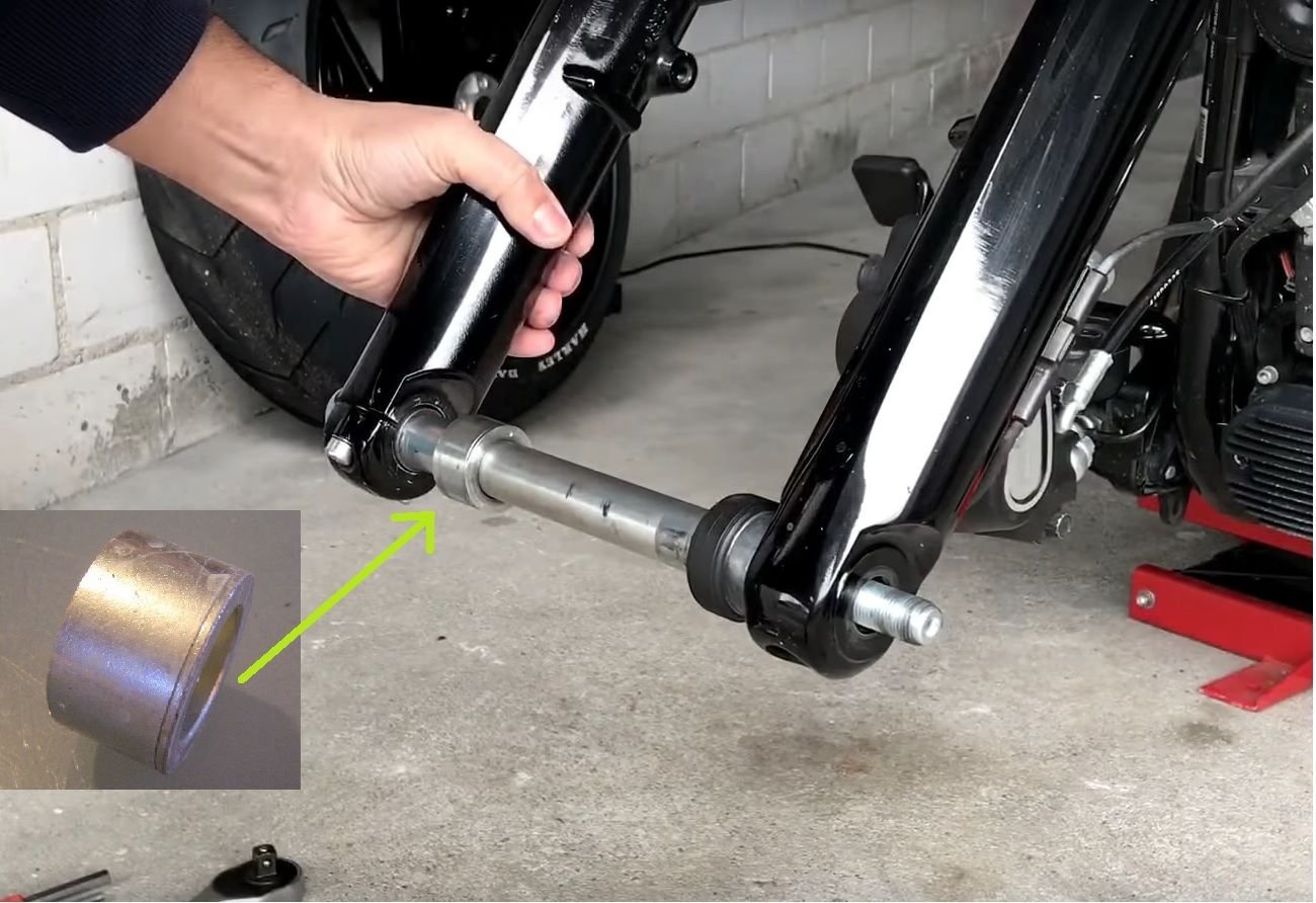

Recently I was changing front tire on my FXSB and I had to remove front wheel.
When I was installing wheel I found a little dilemma, there is a spacer with a groove on right side of axle.
I`m not the first owner of the bike and I`m pretty sure that it was not the first time the wheel was removed.
I am not so sure about the orientation of axle spacer.
It was installed with the groove against wheel, can anyone confirm that this is right?
I don`t see any size difference in the grooved and non-grooved side of the spacer, but maybe I am missing something, maybe it could be installed with groove inward and outward. Picture below.

Not sure why it makes a difference, but I checked mine, and it's installed in the opposite direction, with the grove away from the wheel.
This parts finder also shows it with the groove facing out...http://partsfinder.onlinemicrofiche....=31&c=0&d=2014 FXSB SOFTAILŽ BREAKOUT 103B (BFV) WHEEL - FRONT

The groove goes to the outside, closer to the fork leg.
