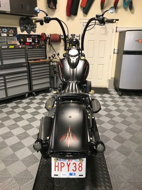

I put a set of 16" apes on my bike last winter and I replaced all the cables. I can confirm when I get home later but my memory is that I went with stock plus 8" for the throttle, brake line and plus 10" for the clutch cable.
I went from the stock 12" mini apes to custom made bars that measure in the 16" range and there is no way the stock cables would have reached. I got my cables from Magnum Shielding and I recall when searching up the Crossbones they had the stock length measurements on their table for cable lengths. May be useful to measure your current cables and see if they are stock lengths or were changed when the beach bars were installed
PM me if want me to confirm the lengths that I used or want any more pics of my setup.
