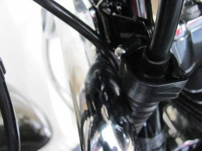

When the bike is parked.
Does anyone know of a cure for the clutch cable/engine guard 'pinch' it makes where the two meet?

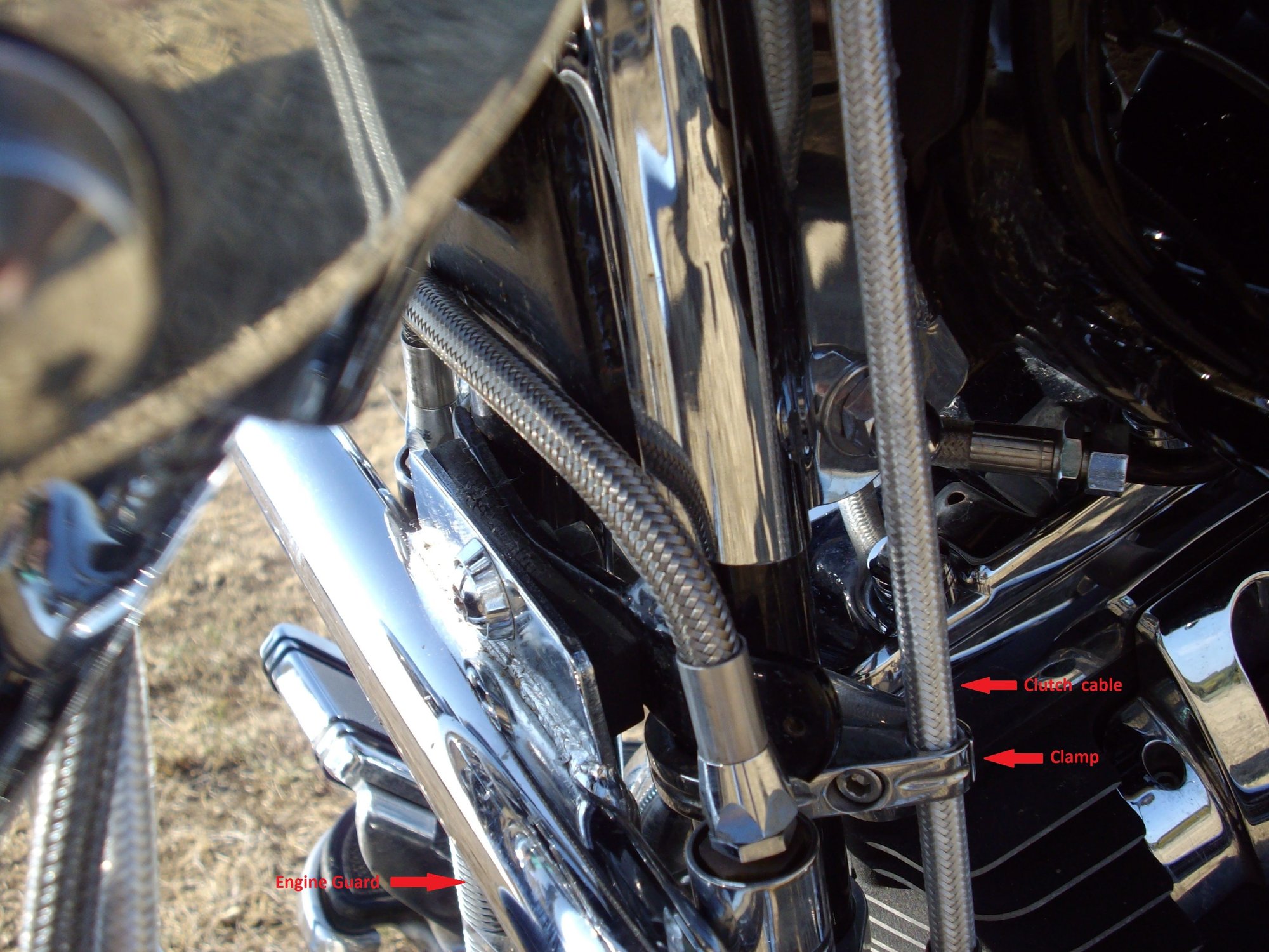

Use a cable clamp to hold the clutch cable away from the engine guard

Too tight, there is no slack to put a clamp on, I can't even get my finger in between it and the engine guard.
Your cables look totally different and yours are routed differently.
Why the hell did they design it this way?

My cables look different because they are braided stainless steel cables. If your cable is so tight you can't move it enough to get your fingers behind it, it is probably too short.
Either reroute the cable so it doesn't get "pinched" or get a longer cable. There aren't many options.

The clamp fits around a 1.25" tube (frame member, engine guard, handlebar, etc.) and up to a 3/8" cable.
