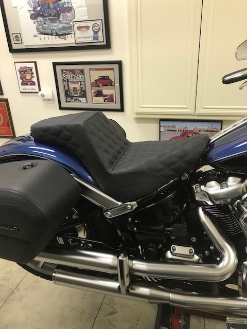

I have a 2018 115th Anniversary Fatboy with a Saddlemen seat with blue stitching to match the bike. The ugly protective film Harley puts on the fender is bad looking enough with the stock seat but even worse with my custom seat because the custom seat is narrower than stock. Sorry about not having a "before" photo but the stock film was bubbled wrinkled and the edges stood out. My corrective steps were as follows:

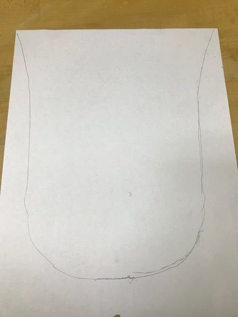

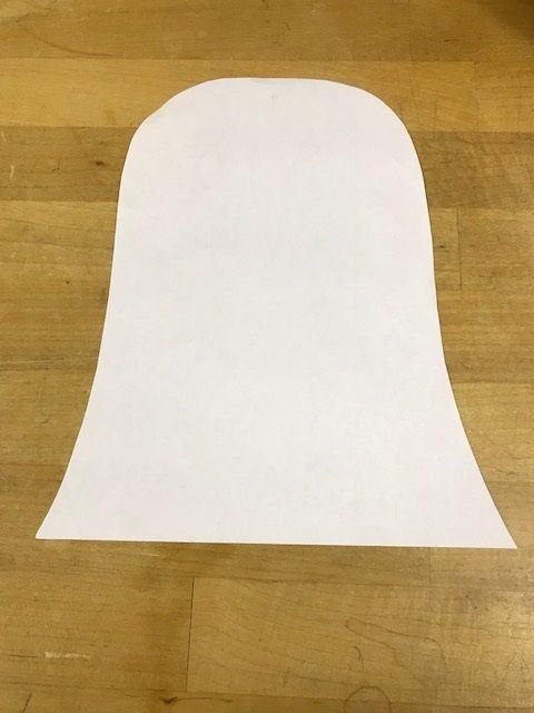

2. Template drawing: I placed a piece of copy paper on the fender and set the seat on top of it so I could use a pencil to trace the shape of the replacement film using the outline of the seat as a guide.
3. Replacement Film: I went to the firm that had installed protective film on three of my cars and got them to cut me a piece of film that conformed to drawing on the copy paper.
4. Film Installation: I used an alcohol and water solution along with a plastic squeegy to install the film. The finished project has a few small bubbles that should dry up. I they don't, I'll use a needle to drain them and flatten them with the squeegy.
5. Tank Dots: After I removed my seat, I noticed rub marks on the rear corners of the fuel tank. I eliminated this problem by installing the clear dots shown in the photo. The dots don't show with the seat installed.

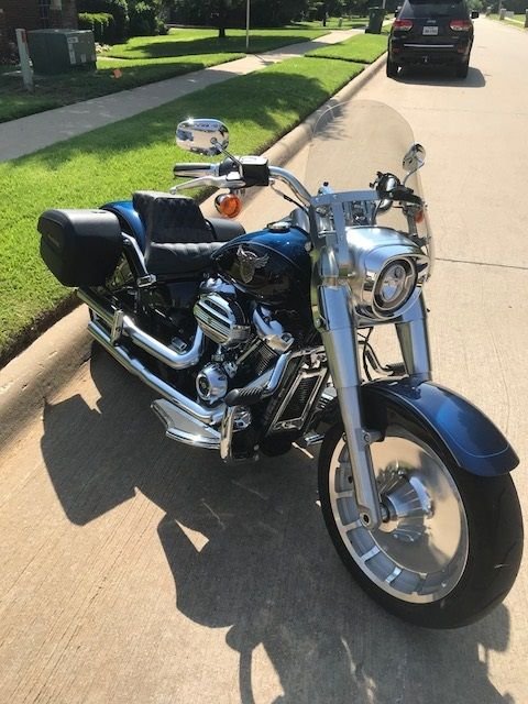

Mac - Which wind screen do you have? How do you like it? It looks great.. Thanks! Kebo

Part number 57400367. It is the 15 inch detachable. I’ve gone over 1000 miles with it and like it. By the way, I’m 5 ft 10 and 1/2 and the wind hits the top of my helmet.
