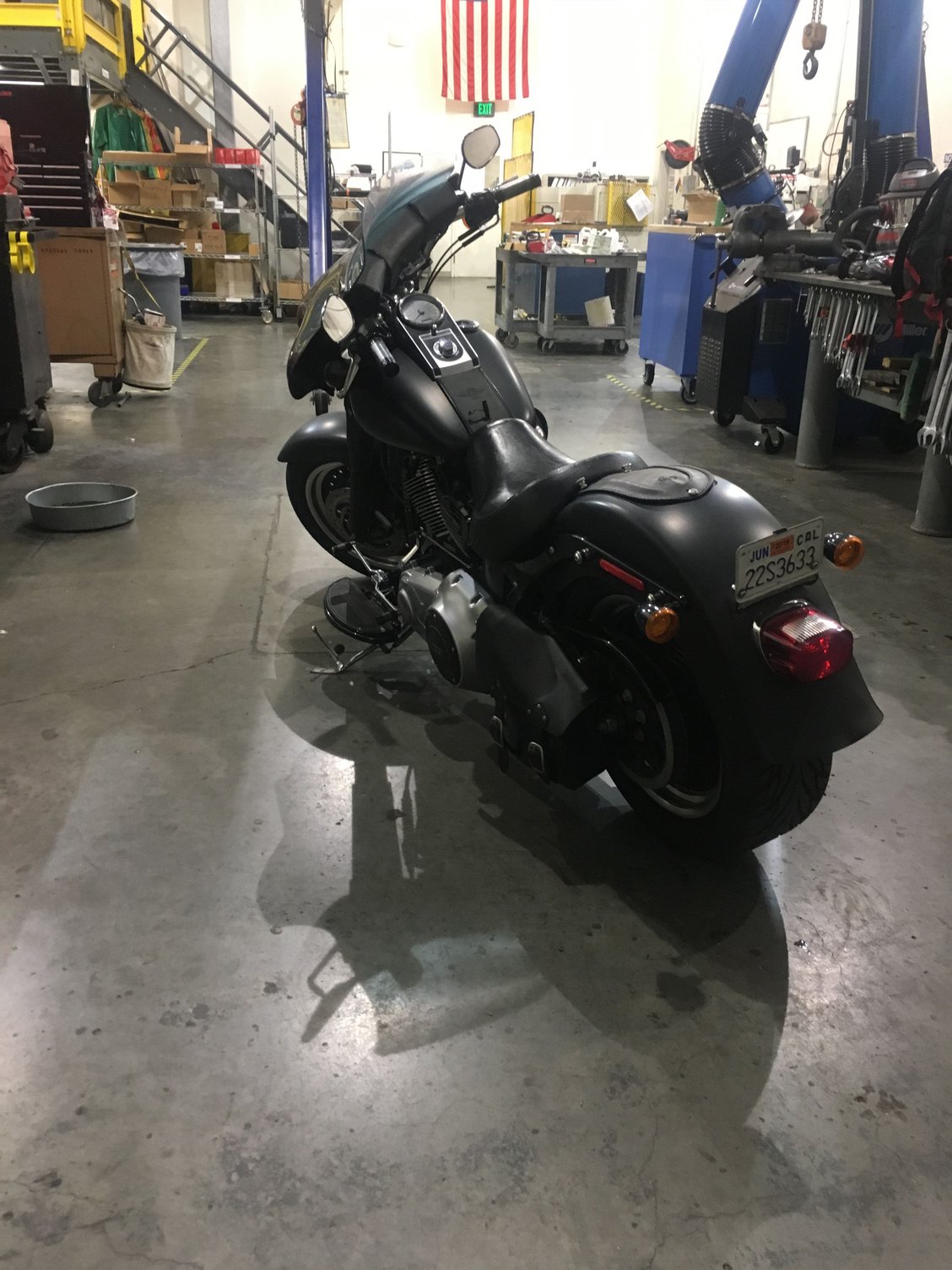

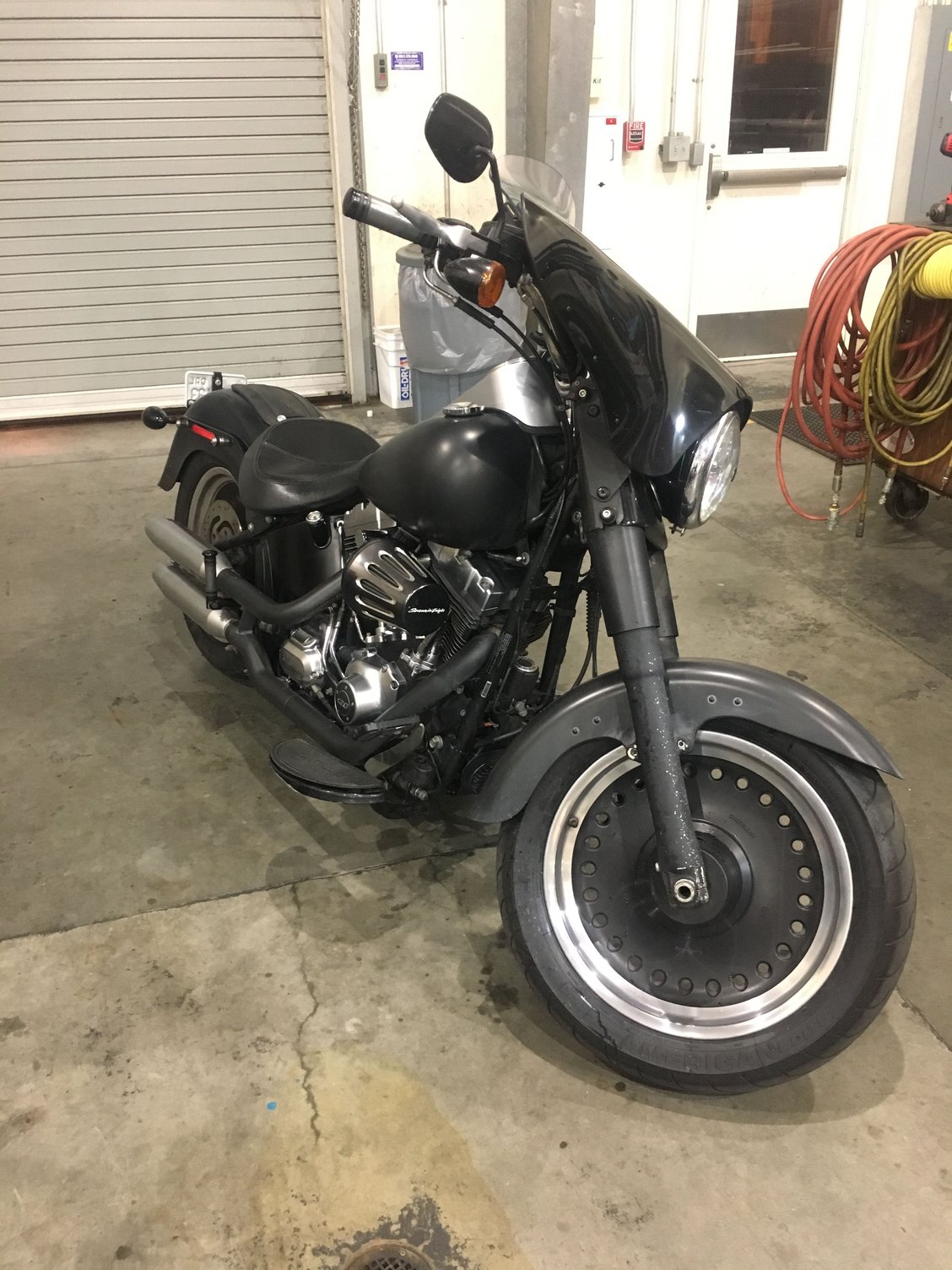

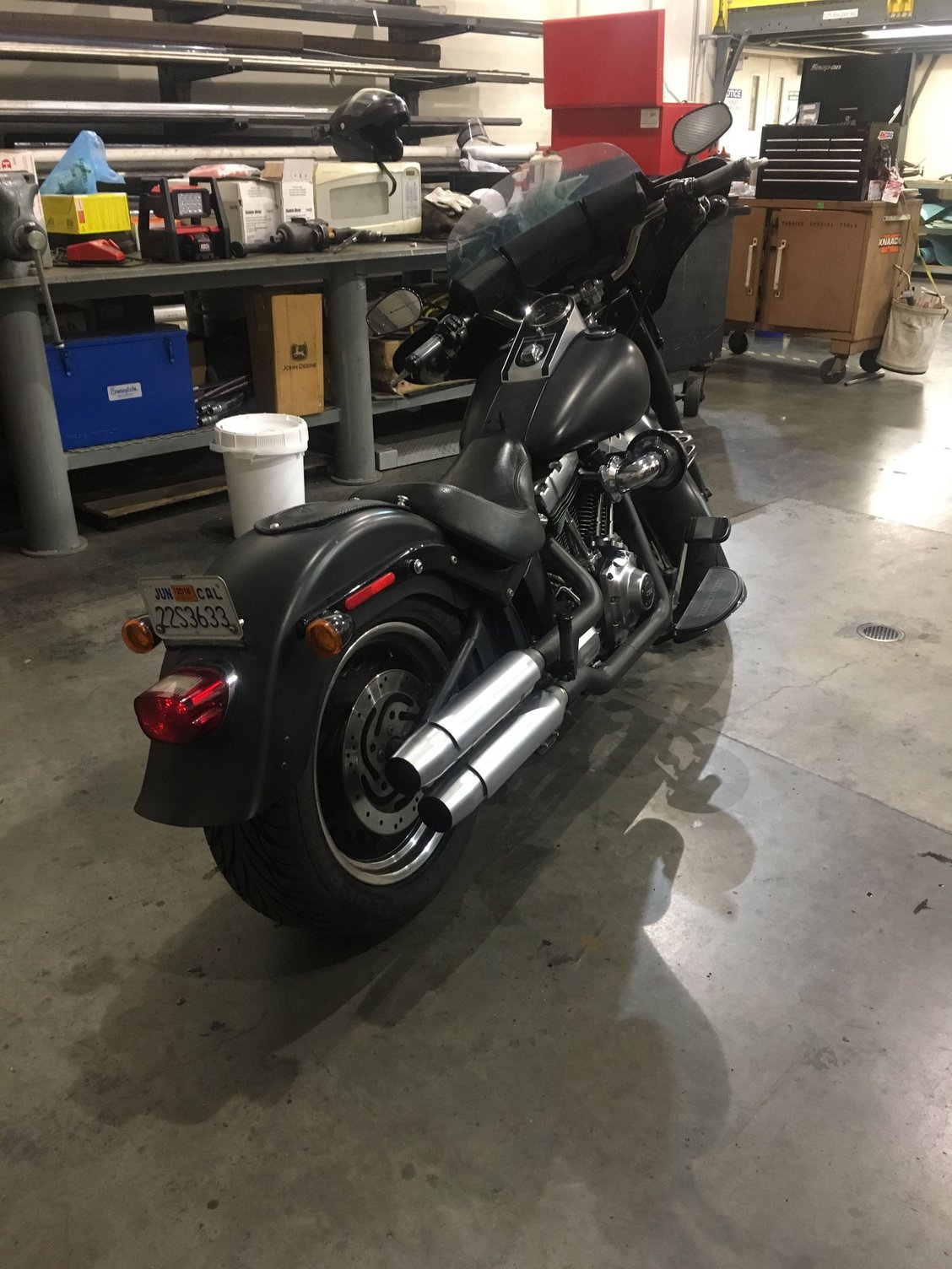

'12 Fatboy. 255 SE cams, SE A/C, gutted muffles with Torque Inserts, Vance & Hines FP3 and oil cooler. I daily this bike in southern CA and put abut 120 miles a day. The suspension travel on this bike is minimal so be careful with uneven steps on road surfaces. Could hurt your back. Tires wear fast so I do not recommend any Harley stock tire be it Michelin or Dunlops D103's. I do recommend the American Elites from Dunlop for longevity. Traction on these really is lacking because the tire has a harder compound. I did the tensioner shoes when I did my cams and they were not that bad. Done at 35k miles. Did find wear on the Crankshaft bushing which I'm guessing that my crankshaft is somewhat out of round. Mike'd it and came oout within spec. So I polished the crank, cleaned up the cam plate and left as is. Do not mess with the electrical. Attempted to replace ignition with Accel COP's and shorted the hell out of the bike. Had to replace the whole wiring harness. Be carefull with the electrical. Currently burning out foot brake switch. On my second within a year. Other than that, the bike is a dream. Enjoy if you buy.
