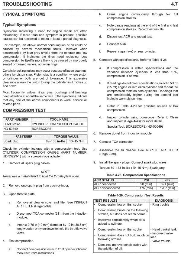

With compression releases, dual plugs under gas tank and throttle by wire. What's an easy way to perform a compression test. Is it ok just to start it for a second? Honestly had never thought about it before.

remove two left side plugs, remove wires at coil for the right side plugs. Compression release connectors are reachable under tank.

Here -
