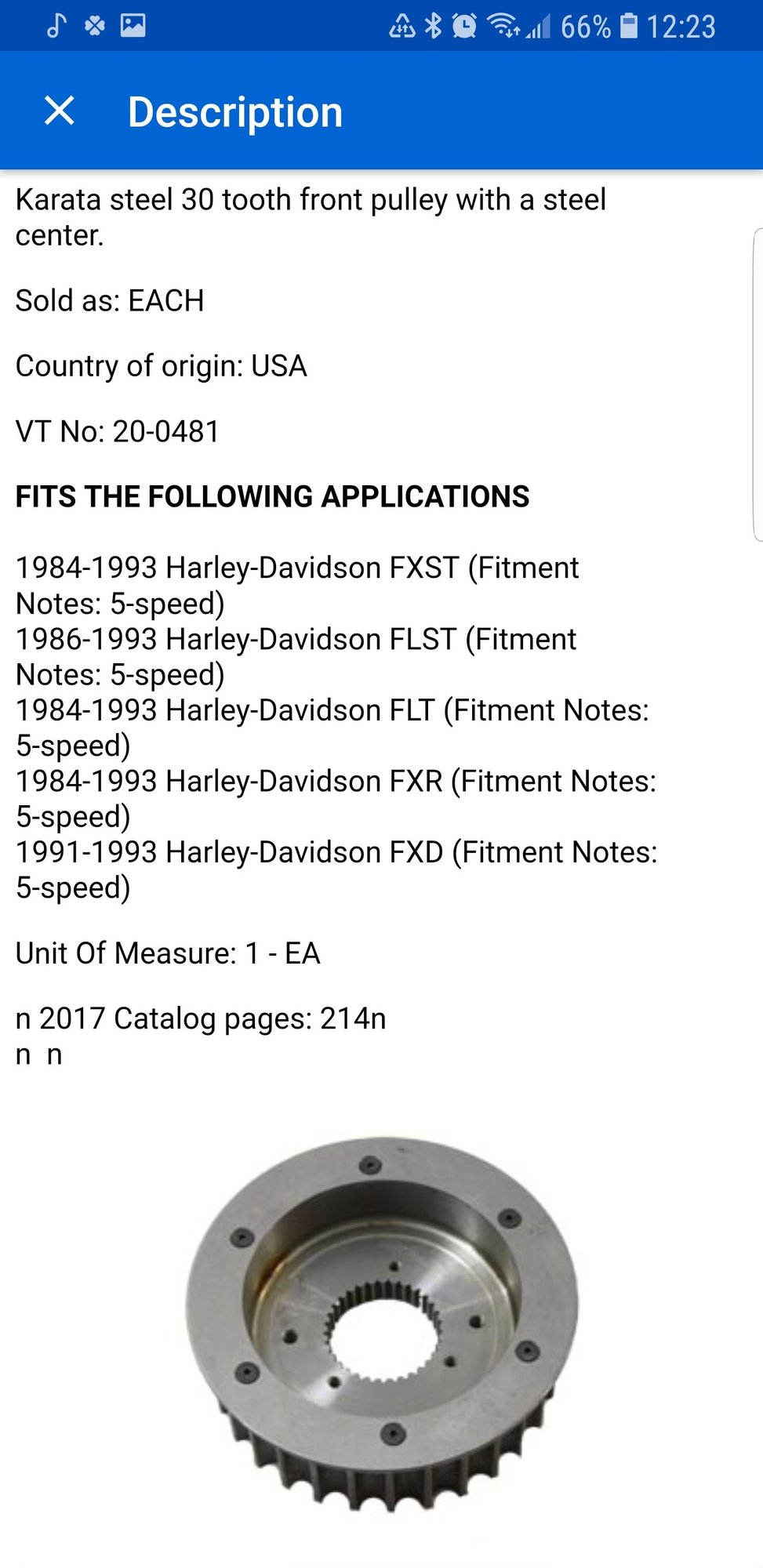

Special socket? I seem to remember from the videos I watched the front is just a t70 torq. Should be relatively cheap at my local princess auto (similar to harbour freight) if I don't already have one, I don't think I do though.
Does anyone know if this will fit? The price is right!
