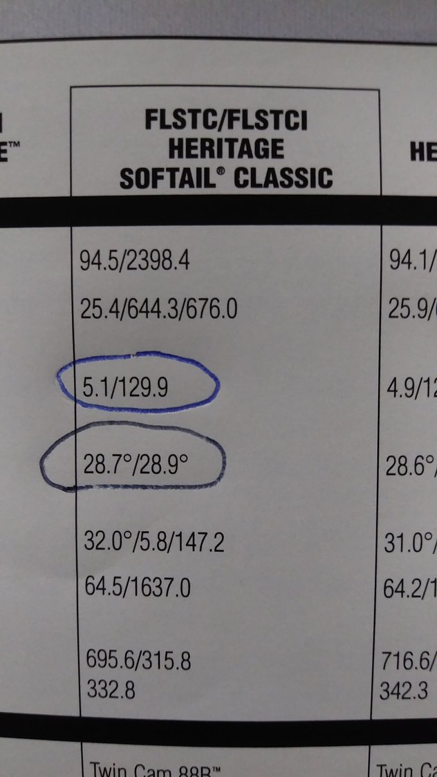

Also I double checked the specs on the lean angles 2002 Left/Right 28.7 / 28.9 Ground clearance 5.1 Dry weight 695
2019 Left/Right 29.5 / 27.3 Ground clearance 4.7 Dry weight 697

2019 Left/Right 28.5 / 27.3 Ground clearance 4.7 Dry weight 697
