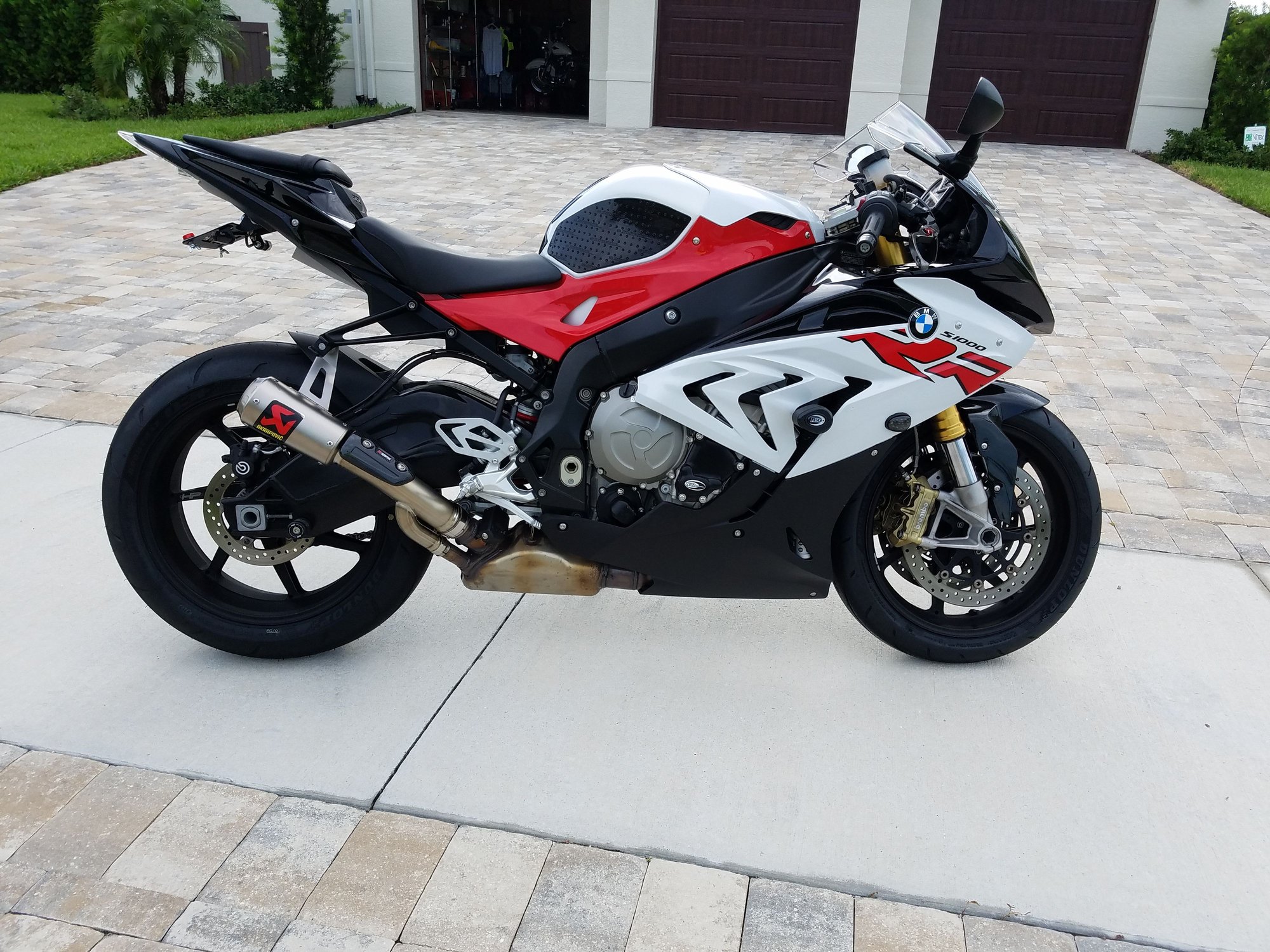

Aside from all the other potential reasons over the years (frame, forks, tires, suspension, &ct.), most have been corrected on modern motorcycles, even Harley Davidson. Nature of the beast, indeed. But if you REALLY want to go 120+ MPH, I highly recommend one of these:
120 MPH, not a problem, and you can get there in 5 seconds.
