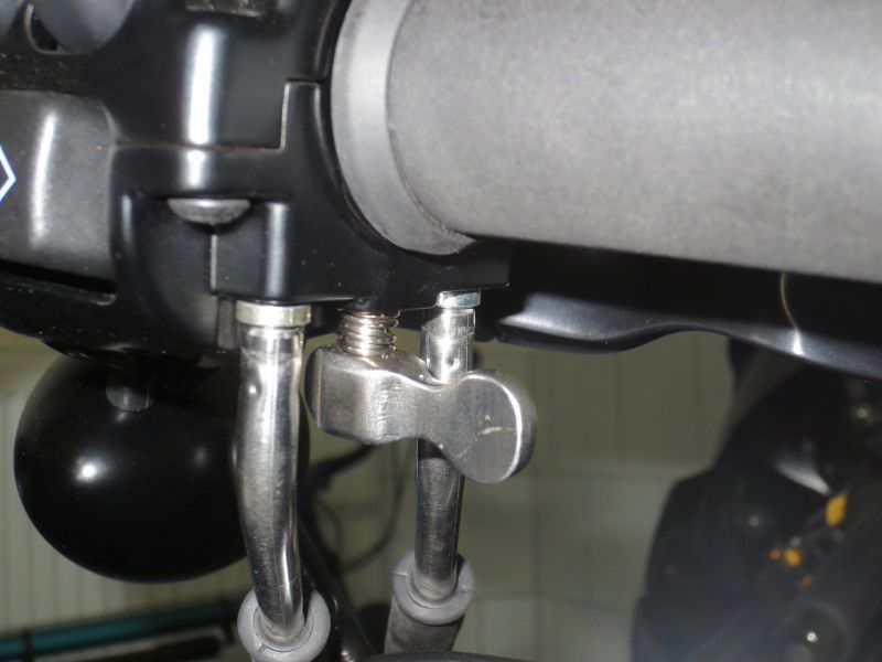

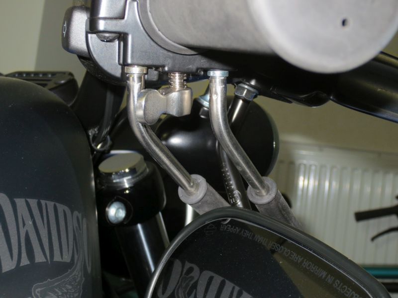

I have the CC on all my Softails, the oldest is a 2016 Breakout but on the 48 I made something that almost act as a cc and is easy to manipulate, not so good as
the electronic but it's oke for what it is. It is made out of a piece rvs and can be adjusted if needed with a small locking screw, to the front is on to the back is off.
The picture shows the part on my Iron but when I sold that one a kept the part and installed it on my 48.
