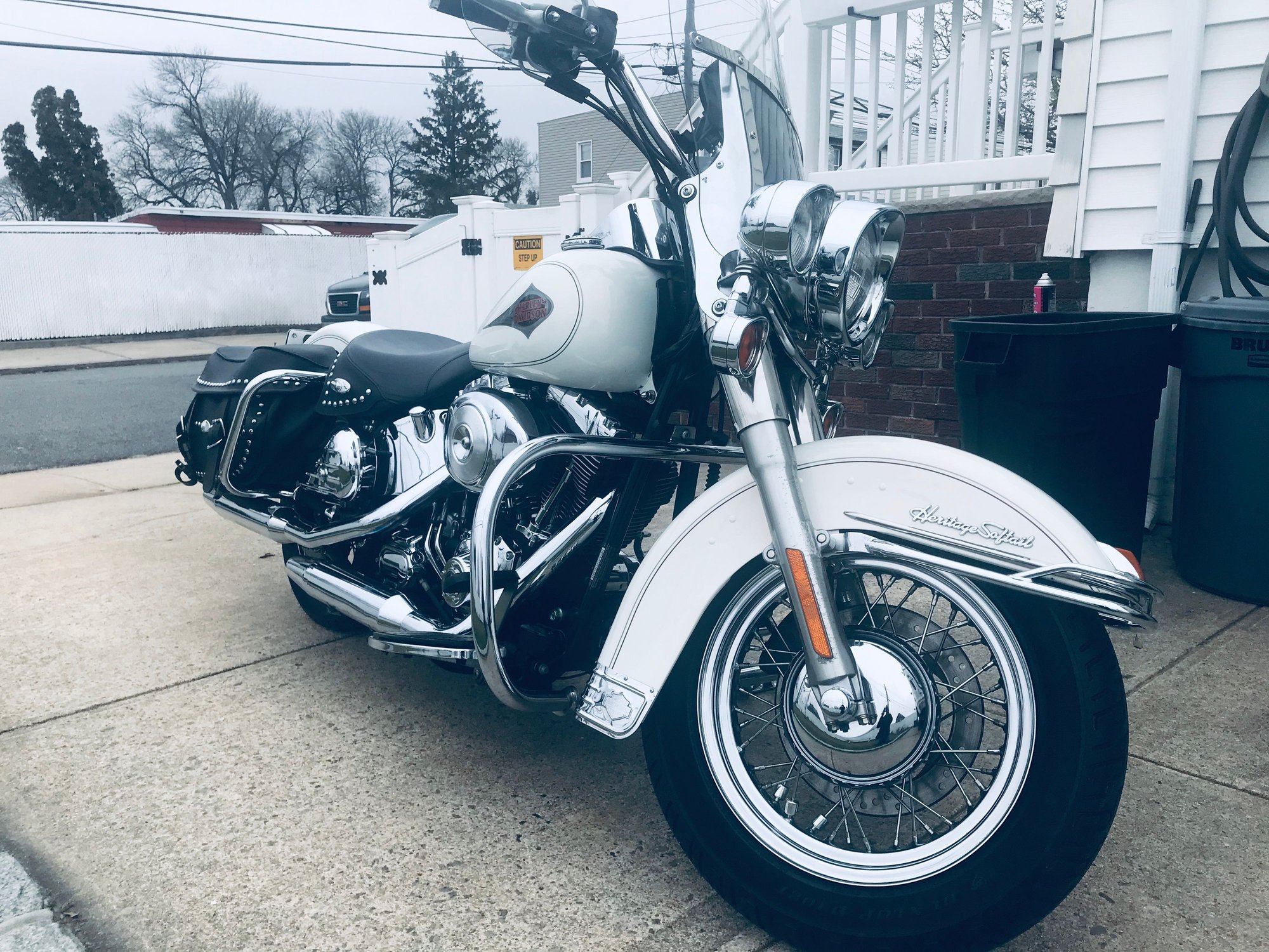

I walked much the same road.....sold my 03 Sportster in 2012 without any regret and had fun one the Sporty. Problem came when my friends took highway rides of several hundred miles. The Sporty would be at the top of the rpm range just trying to keep up. Never enough gas in the Sporty tank either.
At 72 I found pampered 00 STC Pearl White with the big bore upgrade done at birth.
cant wait to get on the road with my riding buddies again and not be a half mile in the back.
If you like old school Harley’s that you can make your own......can’t go wrong with a Heritage
Harley of NYC called me today looking to sell me a bike.....I found a nice way to politely end the conversation......”what do you have with a carburetor”

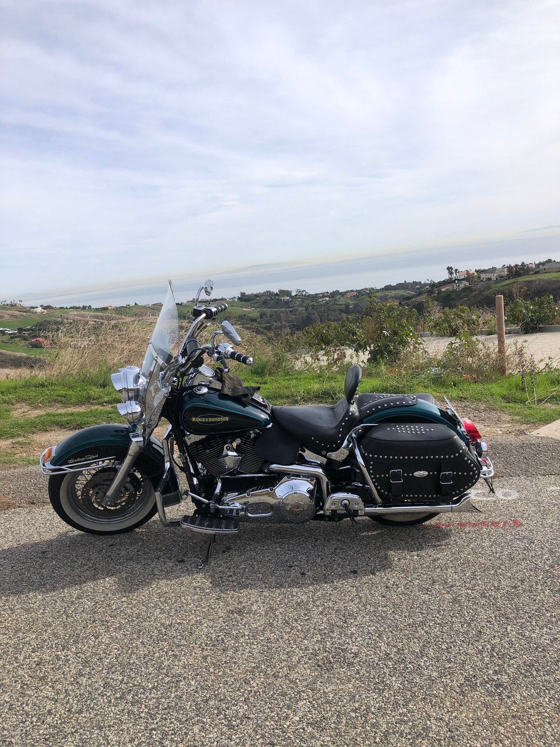

I also have a ‘00 TC 88 Heritage. Did the stage one upgrades and a few personal touches. I’ll never sell this bike. It’s perfect.
