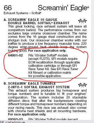

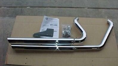

My wife had them fitted on her '06 Deluxe, they were made by V&H and the fit was similar and requires a purpose made bracket, as to if the V&H one is identical I can't say.
SE catalogue
You'll see from the V&H instructions how they are almost identical, V&H had slashed ends the SE straight cut!

Thank you very much for the info and pics - those are very helpful.
I picked them up, and I am anxious to see how they perform. I did get the bracket from the seller, and they appeared to fit a number of non-O2 sensor softails.
Did you wife like the pipes on her '06? Online comments in older forums seem to indicate that the baffles can be swapped out for V&H baffles to make them slightly louder. Hoping the cross chamber gives better low end torque than something like the standard V&H short shots / big shots.

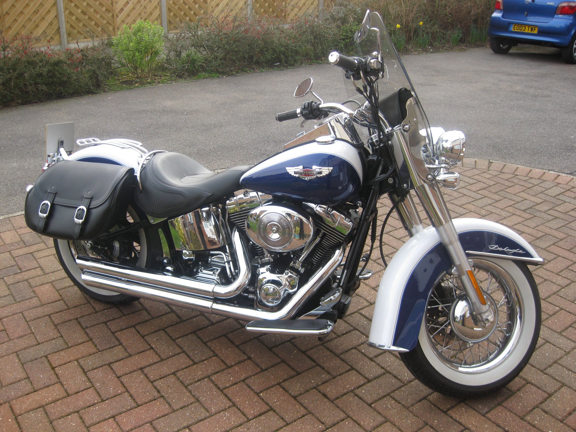

Those SE 16 gauge worked well, they were not too noisy either, like most of the SE pipes at that time were and they did improve the performance, good mid range!
She kept them on that bike for the six years she had it, the only real issue was with the Deluxe being lowered on tight right hand bends it was easy to scrape the lower pipe!
The only other issue was she was forever melting her rain trousers on the upper pipe…..
That is until she got some with the heat resistant panel on the righthand leg!

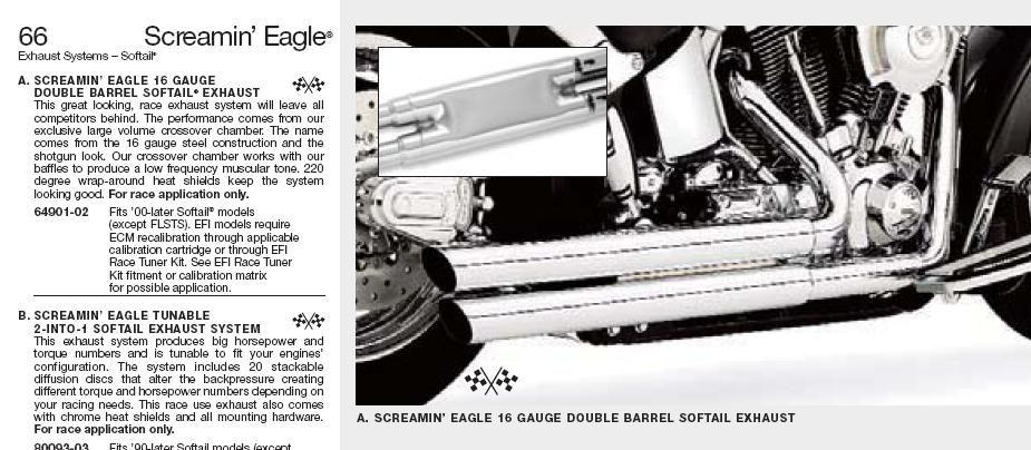

Another picture with the bracket.
