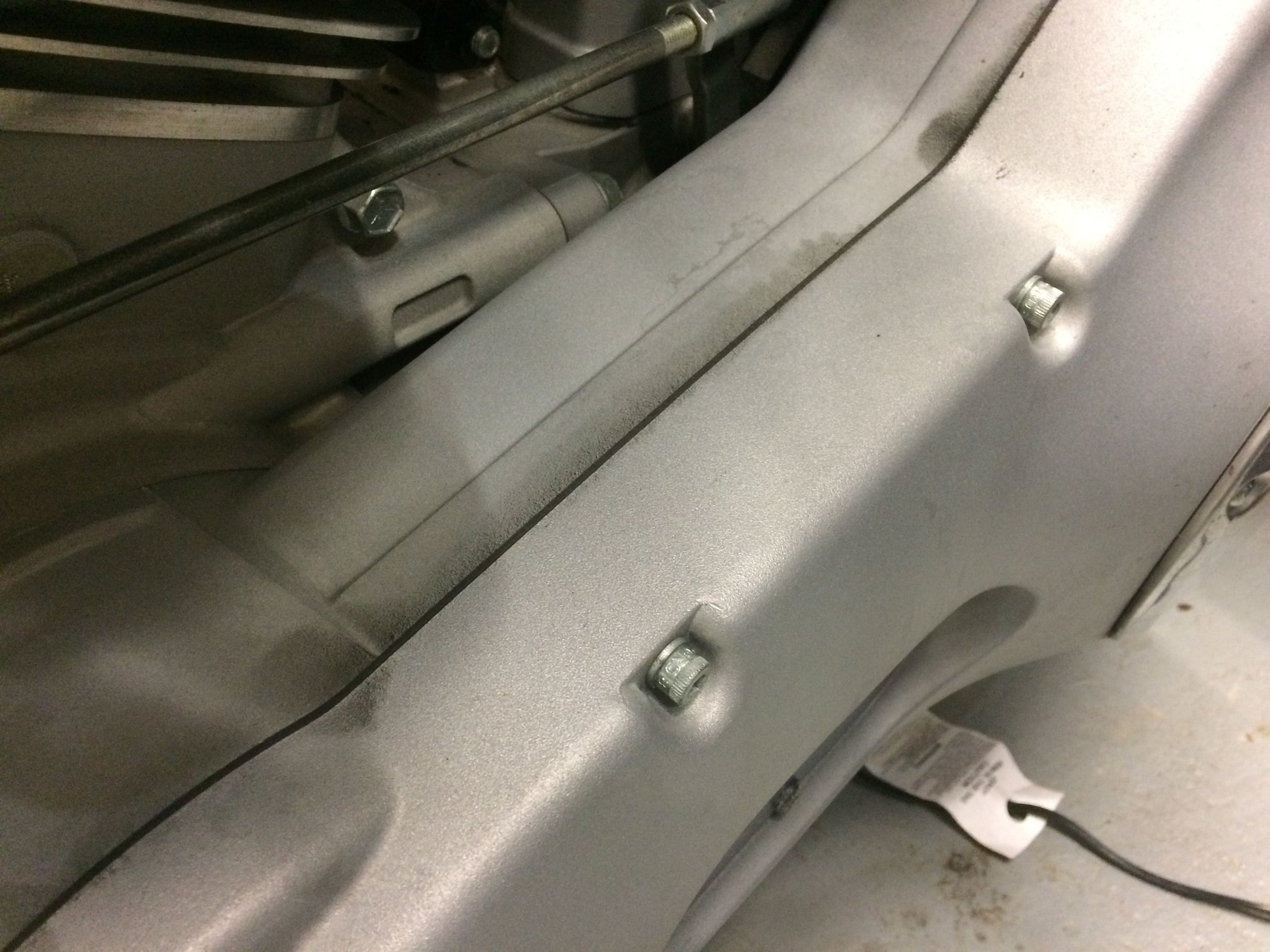

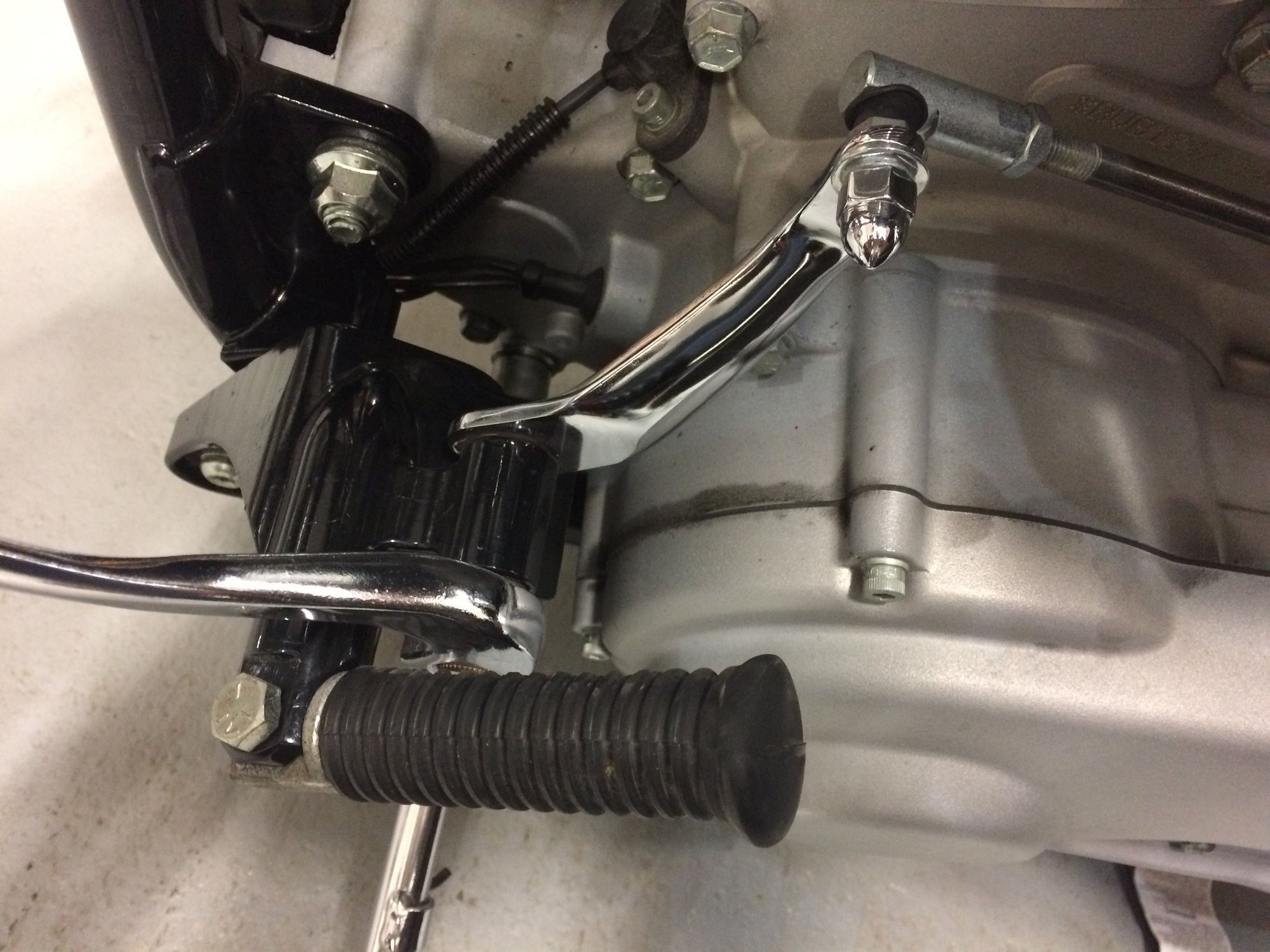

I have a 01 Softtail Standard. Original owner. I've been noticing now for several years that after a ride I'll see a little buildup on the primary cover where it mates to the inner, right where the gasket is. I've attached a few pics of this:
There isn't, nor has there ever been a leak that drips. There has NEVER been a drop of oil under this bike, ever. But as time accumulates between washes, I get this film built up on this area. When you touch it, it's like a fine black dust, very slightly oil/greasy.
Some Simple Green sprayed on, and let sit for a minute , then rinse and it comes right off.
So it's just like the gasket is soaking up enough oil from the primary that it allows any dirt/dust etc to stick there.

Mine with the cover off and laid back on without gasket rocks 1/16 front to back. It will pulldown however. Put just a film of RTV black on Harleys' three layer gasket (has a slight V in it)
Now hand snug from center out each direction with a socket and T driver thru between your fingers to just tweek it tight.
Let it dry over night and then and only then, roll of in and out that small black bead that came out like a small black rubber band
Now retweek center out. Fill to proper level with bike level to lower edge diaphragm spring. Drive it and recheck bolts hot.

19 year old gasket should be a no-brainer. Change it.
At least check the torque of the primary cover bolts.
Or not. Your call.

Most likely an old gasket needing replacement... easy job..
Checking the torque on the gasket is another easy thing to do... just use the correct size hex bit... nothing to it...
As Ripsaw said, there are warped covers out there... if you test yours on a flat, level surface and it's warped... a new gasket may not help, depending on the size of the warp..
With a warped cover, if you don't want the expense of new cover, Ripsaw shared the method to seal it up well...
OR... since it's not actually dripping and losing oil, you can just ride as is... and clean it when it shows... it certainly isn't a problem that will leave you stranded on the side of the road...
I'm too OCD to leave an easily replaced gasket weeping or leaking, but that's my sickness ....
