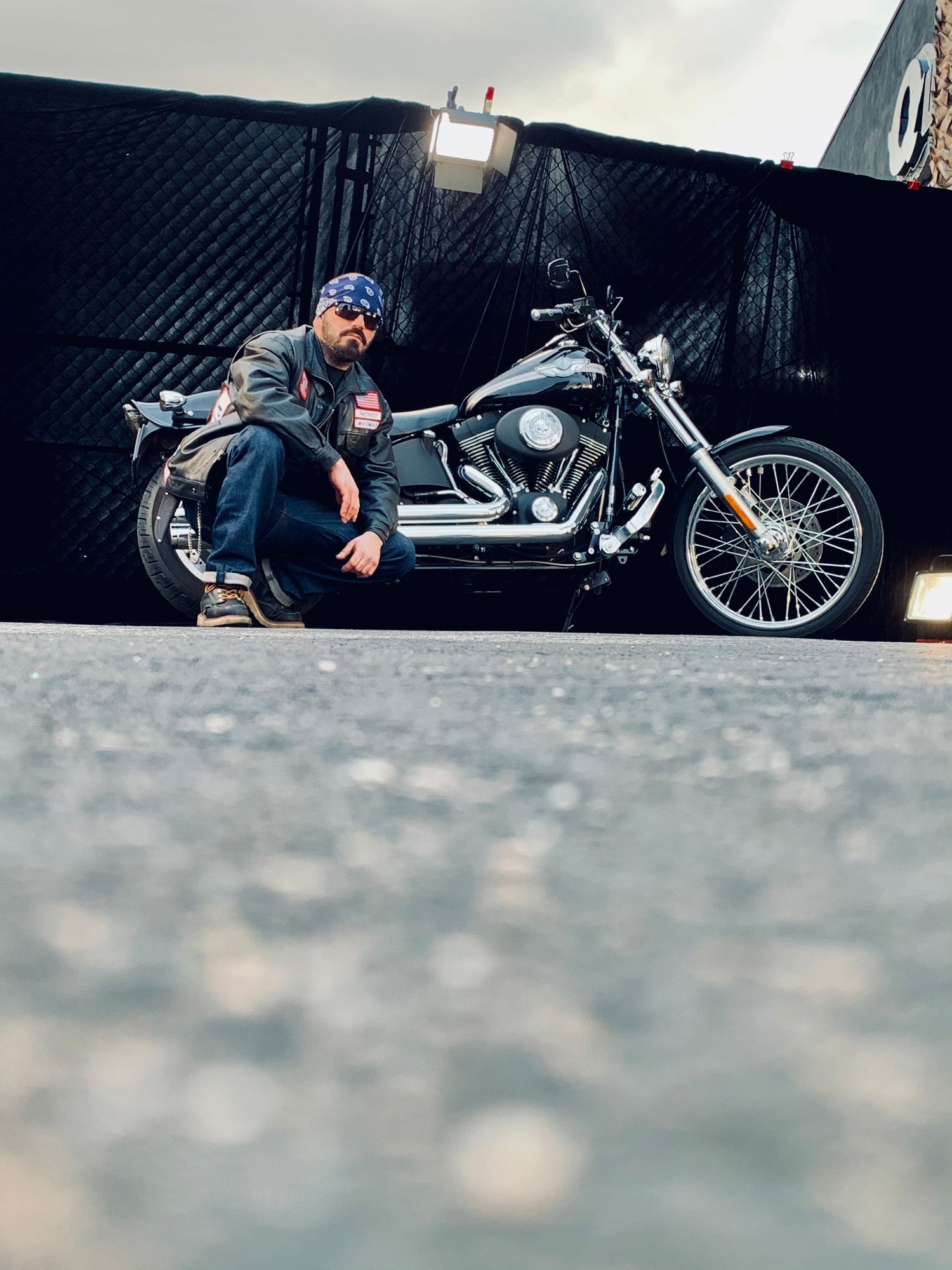

I have 12” pullback risers by biltwell, I don’t know what to extend and where to find the right length brake hose, idle and throttle cables.. any advice helps! It’s a 03 FXSTB Night train with stock risers. Need to put the 12” risers on because the stock risers hurt my back like crazy, I have t-Rex arms
