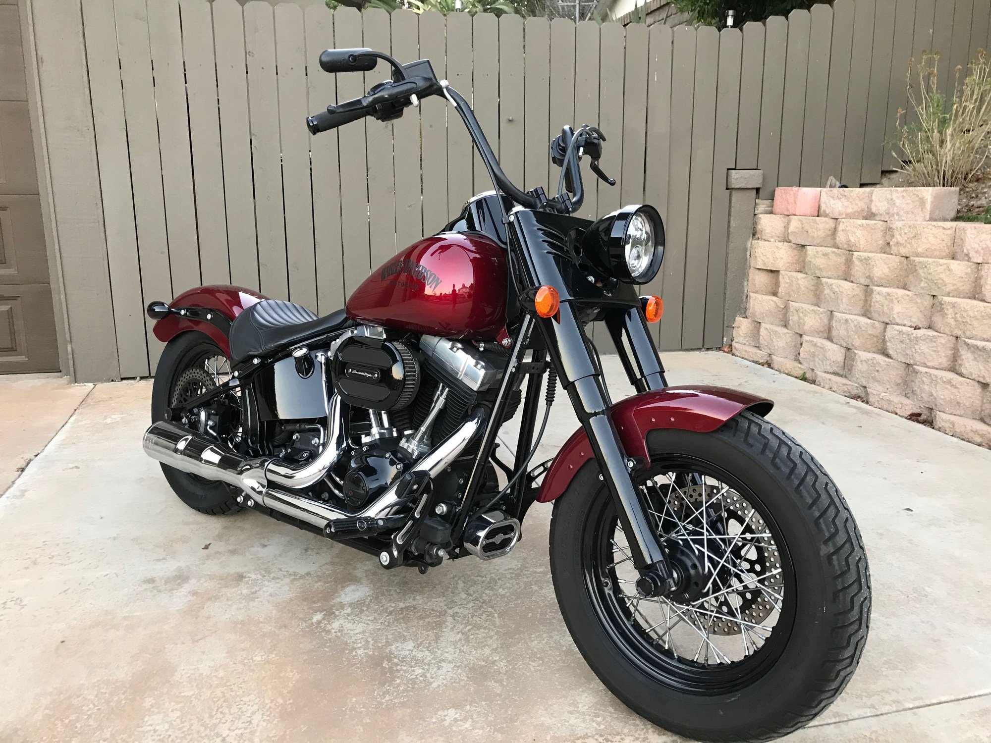

This is my 2016 Slim with mini apes and I used all stock wires and clutch line. Did get a new brake line though.
This feels perfect for me and i'm 5'7".

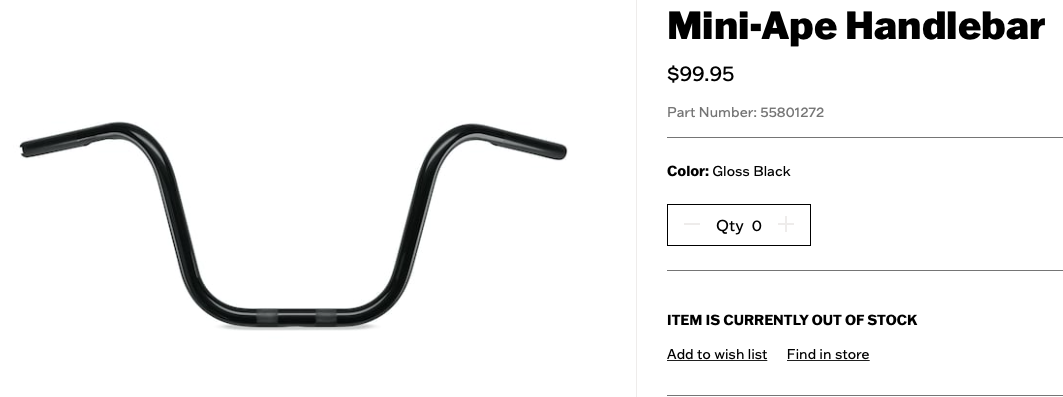

I have Harley Davidson bars. Part #55881272 (black)
Most Mini apes will work with OEM cables on the Slim, (minus brake line on some).

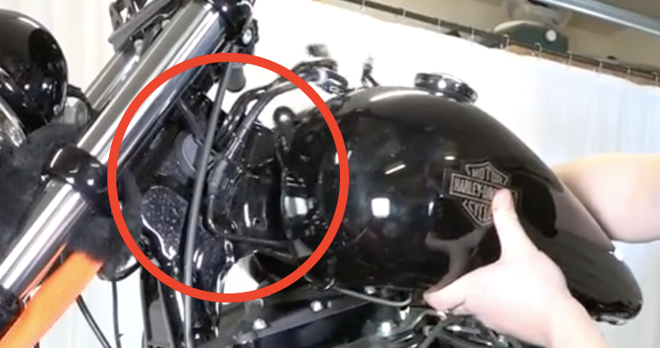

There is quite a bit of wire slack under the front of the tank going up to the hand controls. Pulling the tank back about 5 inches will expose this area. Couple plugs on either side.

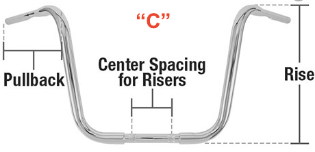

What is the rise mesurement on your bars,(reference image "C")

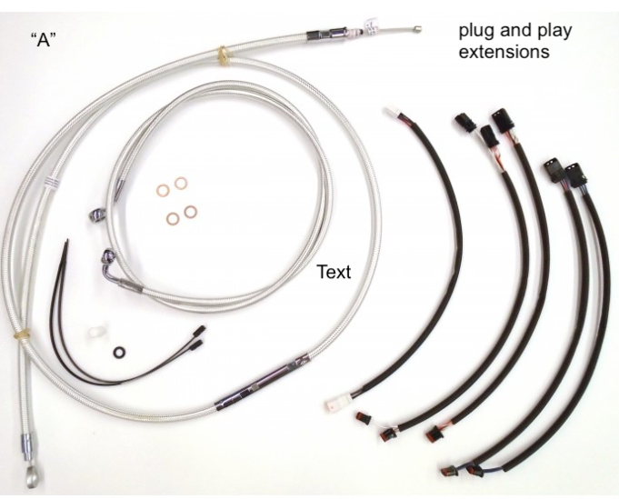

Couple different versons of wire kits out there are:
"A"

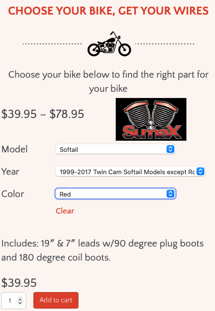

As far as plug wires. I have Taylor Thunder ones on mine.
You can get them off the Sumax site or do a search. I've seen the Screamin Eagle ones but seen mixed reviews.
