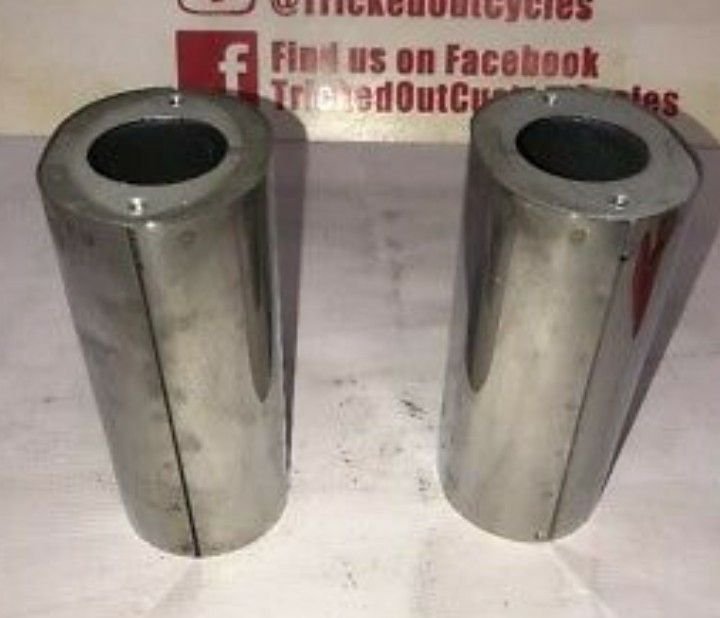

Do your tubes have raised ridges around the bottom edge?
Mine had that type when I first got it, and they rubbed the paint down to bare metal. When I had the paint done, I changed for the plain jane type as illustrated in Barnyboy's drawing.
If they are the type that is straight at the bottom as in the illustration, about all I can offer is to try switched side to side, or turn 'em 180°. Both of which require substantial disassembly to get to the screws.
I don't think turning them is an option. There is a seam on the backside.
