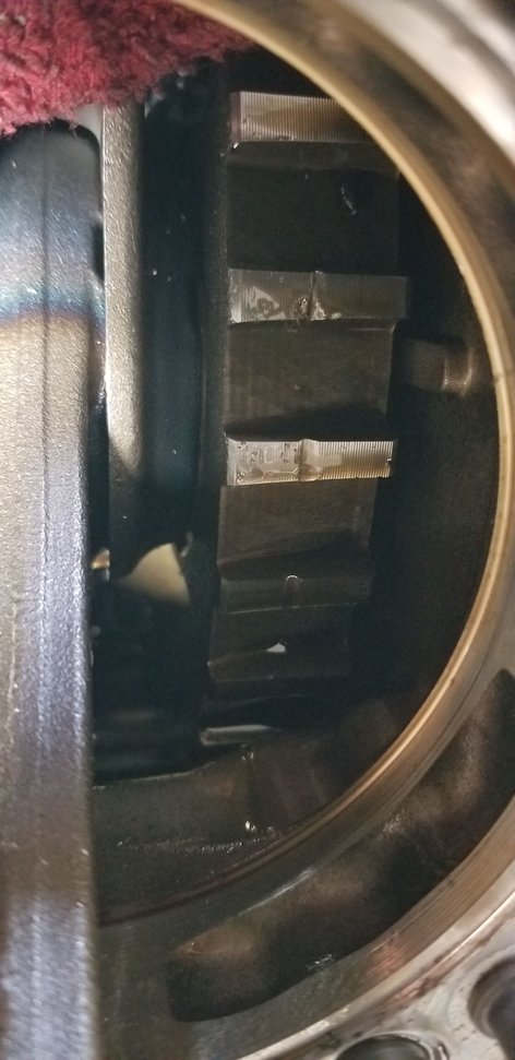

I got the engine pulled and started tearing it down. I noticed damage to the flywheel for the crank trigger. I had the manager of the machine shop at my work tell me to bring the case in and the bearing that's supposed to be in it. He said they add some aluminum to the case and then machine it back out for the bearing to fit. I'm just concerned with possible damage to the crank from fragments of the cam bearing. Once I finish tearing the crank case down, I'll have a better idea. I'm really starting to think about a 120 build with a welded crank.
