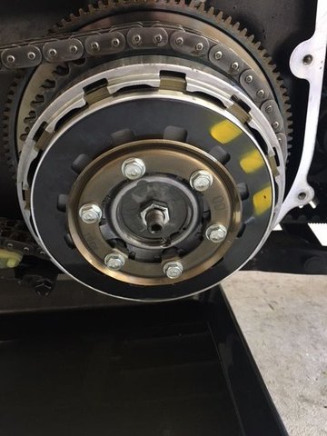

The oil didn't smell burnt and I didn't see any clumps of metal shavings on the drain plug magnet or anywhere else. Color was dark grey. I attached a couple videos of the clutch moving back and forth when engaged, if that helps.

The previous owner may have been hard on the clutch and glazed the plates. Once glazed, they’re toast. I’m in the same boat, bought an 2012 Ultra last year, have a clutch pak sitting on the work bench waiting for me to install.

Looks like a new clutch fixed the issue. I put in a BDL extra plate kit (BTXP14) and used Harley Formula+, since there seems to be lots of different opinions on which oil to use. I don't feel that slipping "lag" and the gear indicator on the gauge isn't shutting off anymore, which it was doing before when it was slipping. Shifts firm now, it's easy to find neutral from 1st or 2nd, and it doesn't try to pull forward when I'm idling in 1st. Here's pictures of the old clutch. Not sure if you can tell anything from these.
