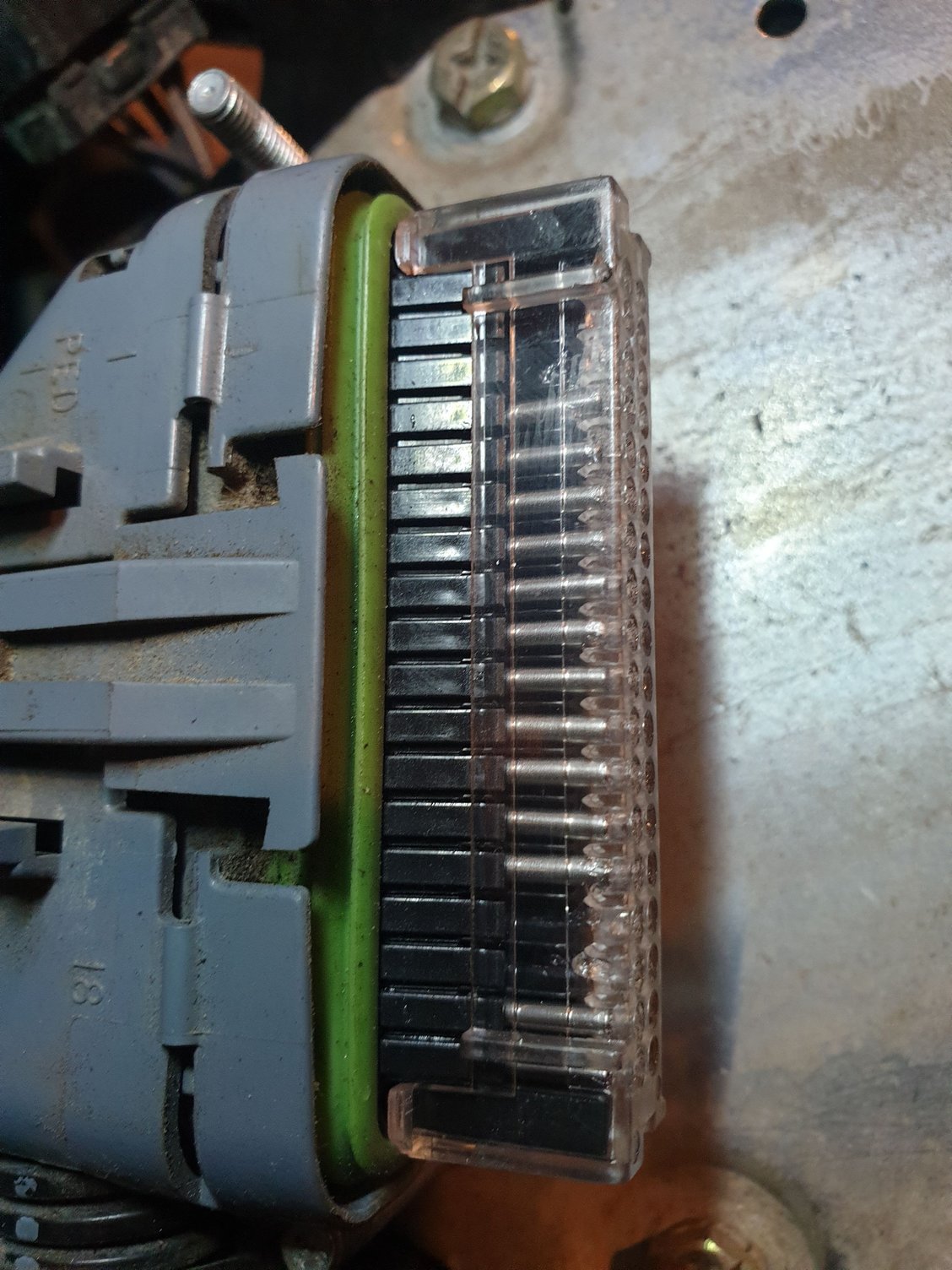

I just checked the ECM and everything looks good. No corrosion or bent pins. Cleaned pins with contact cleaner. The grounds are clean and tight. I'm just hoping it's something more simple, as an ECM is pricey and there is no guarantee it will fix the issue. I'll go over it all again. Could a dickie relay cause this to happen? They are new.

Maybe look at removing the back plastic cover on the connector for pin-to-wire terminations?

At this point, I wouldn't replace anything else without first checking the part to make sure it's failed or failing.
I certainly wouldn't replace the ECM without first checking it out, and finding it to be the problem. I know it can be done, just don't have the procedure to share..
As far as the ECM, I would find the pins that service the DKP Sensor and check them for continuity.. I would also check the wiring to the coil..
With all you've done, and if all the new parts are working/installed properly, it sounds like the ECM, or bad wire in the harness between the ECM and a sensor or coil...

I have run into electrical problems on the back side of the connectors having either a pin pulled out of the socket and have seen bad termination of the pin crimped to the wire. Worth a look.
