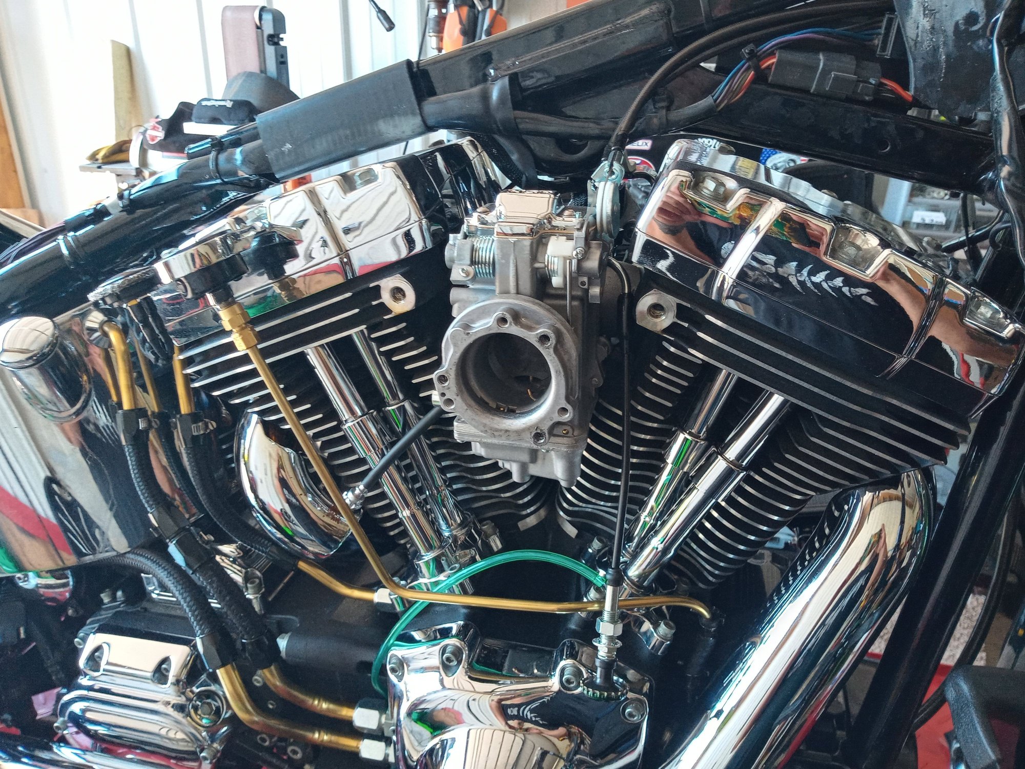

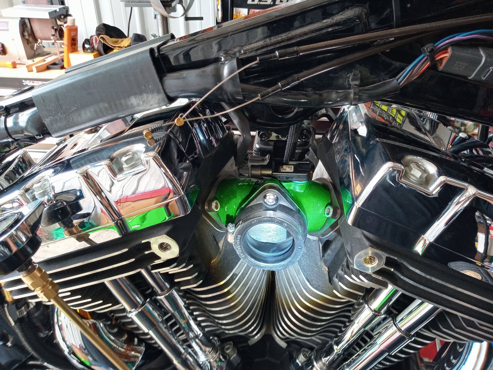

I agree Mikuni carb will offer much improved throttle response due to the gate valve that can open 100%. However I did other things to my softail such as a final drive chain and an open belt primary along with S&S cams. When I want to leave an area it's instant throttle response and not a rubber binder effect. There is a learning curve if you ever went this route. I changed my EFI to a carbed Harley because that's the way I like them.
Don't de-tune my scoot man.
Gittin ready
Mikuni HSR42
